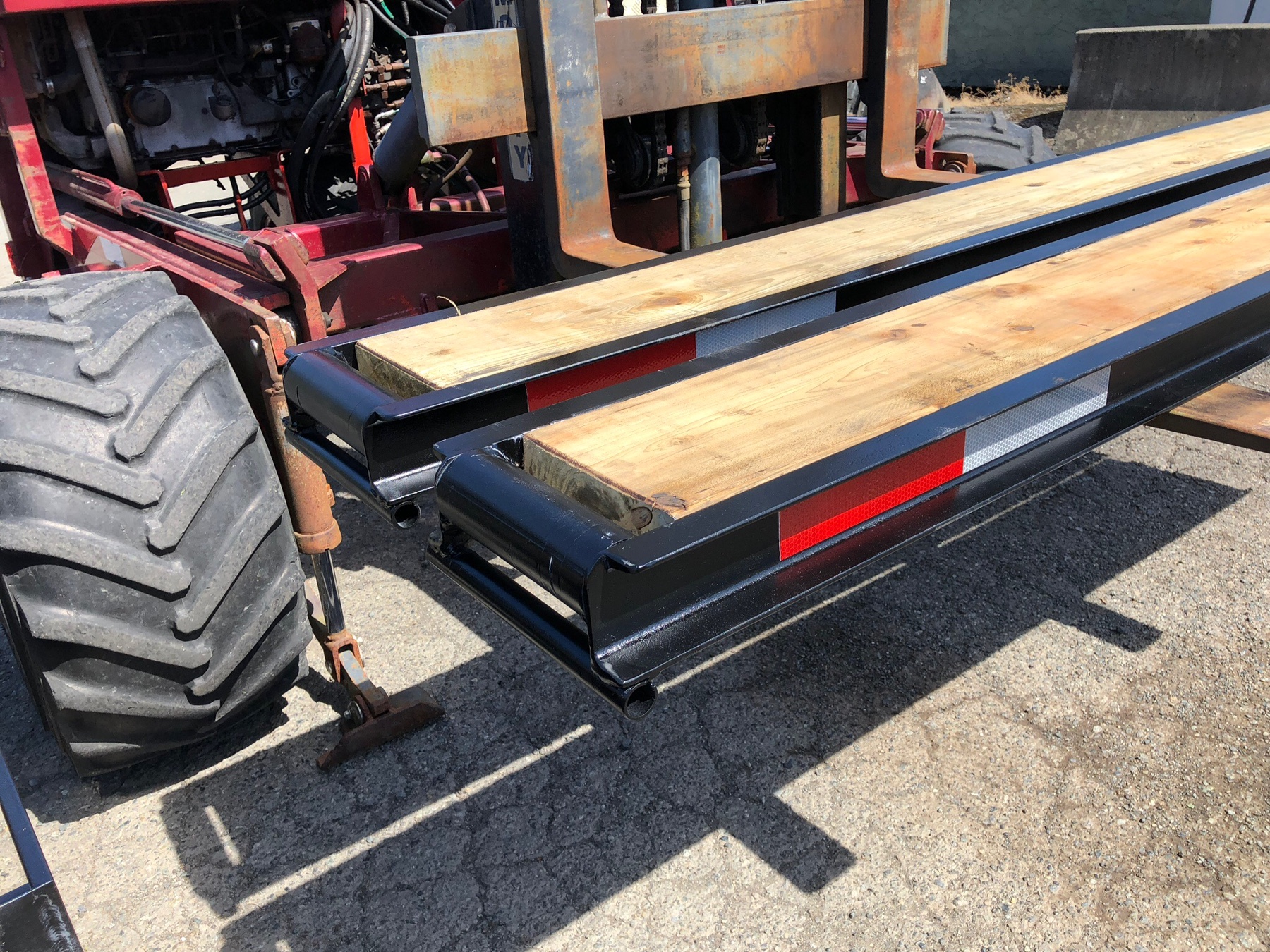

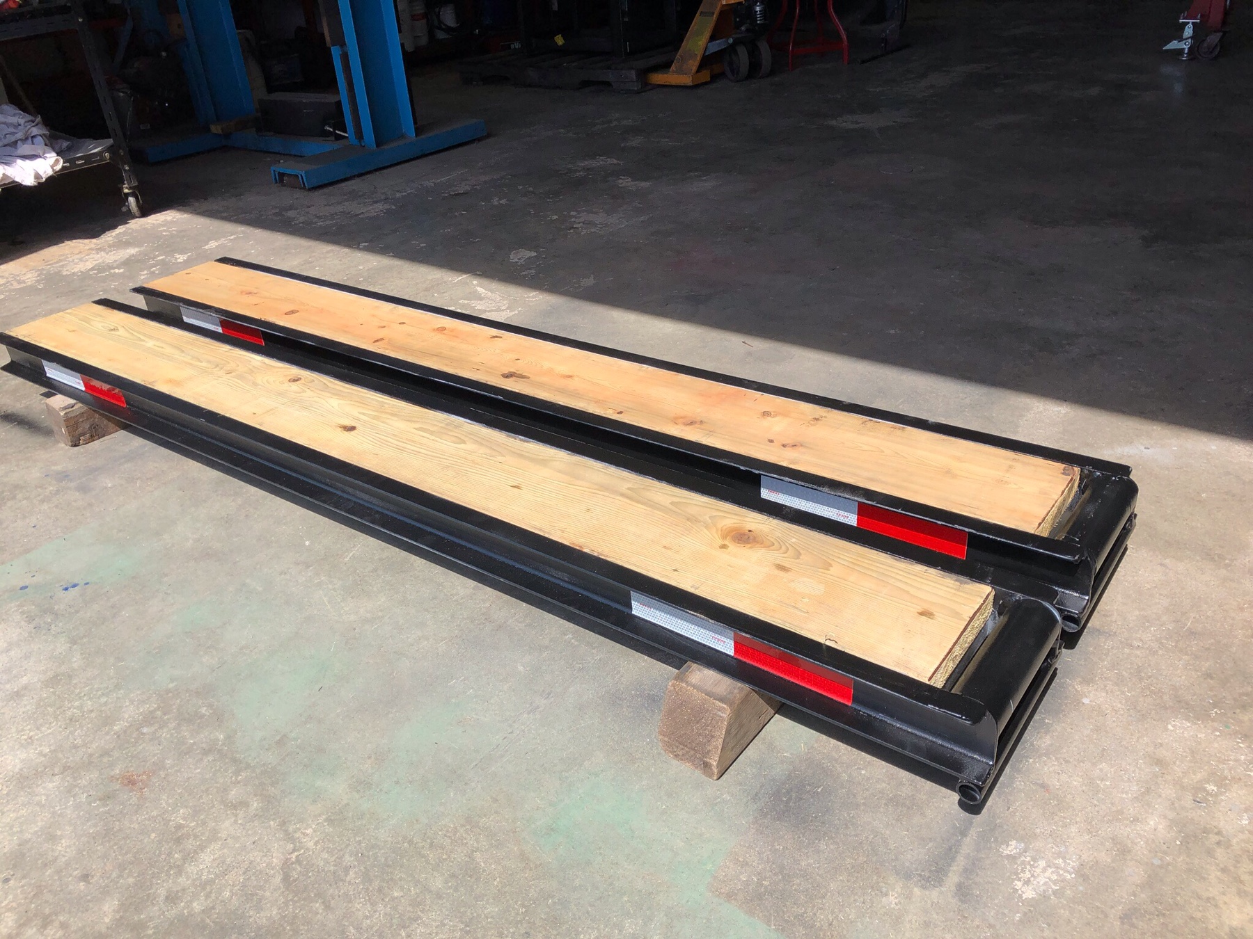

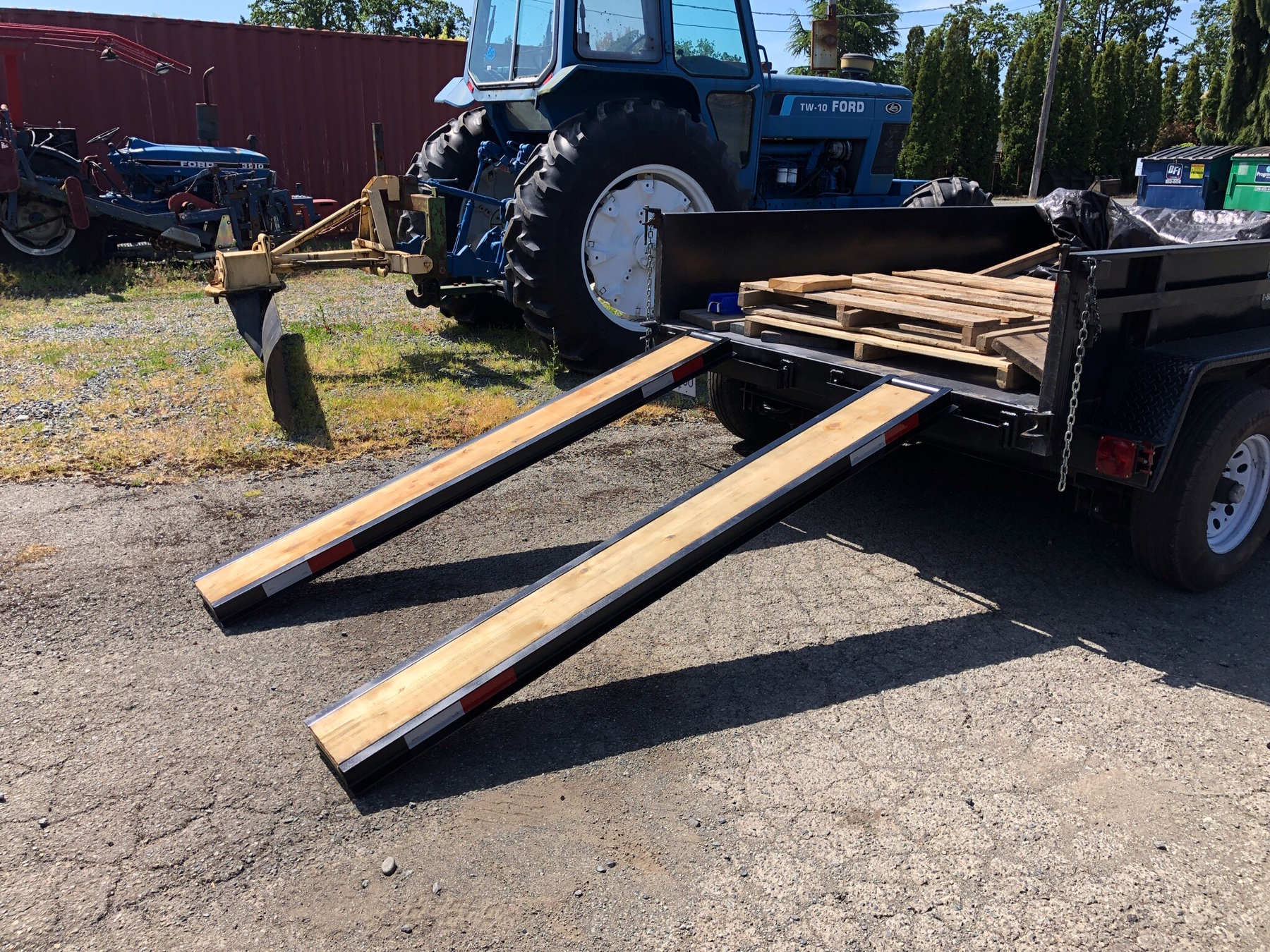

I spent the better part of the weekend building a set of ramps (steel and wood) for my dump trailer. They will be only used for equipment under 7000#.
Seven feet long and 10.25 inches wide. I used 3" channel, 1.5"X1.5"x.25" angle iron, and 2x8 pressure treated boards.
I didn't have cheap or easy access to any aluminum so had to use what I had.

The look extremely heavy to handle but very capable of handling a very heavy piece of equipment. I sure hope you have some help to put them on and off so you don't damage your back and end up like me.
/ Todays shop time. #553
They're 90 pounds apiece, Gary. Easy enough to hurt yourself not being careful. I'll keep a lookout for some used aluminum to make another set.

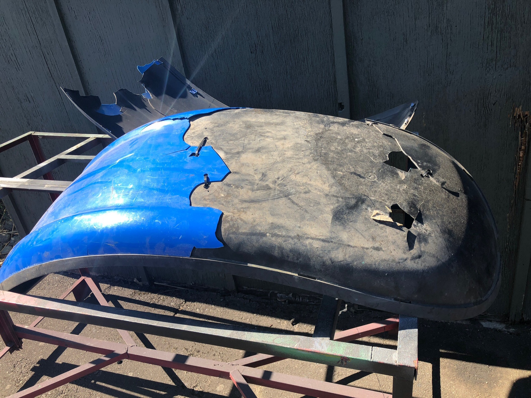

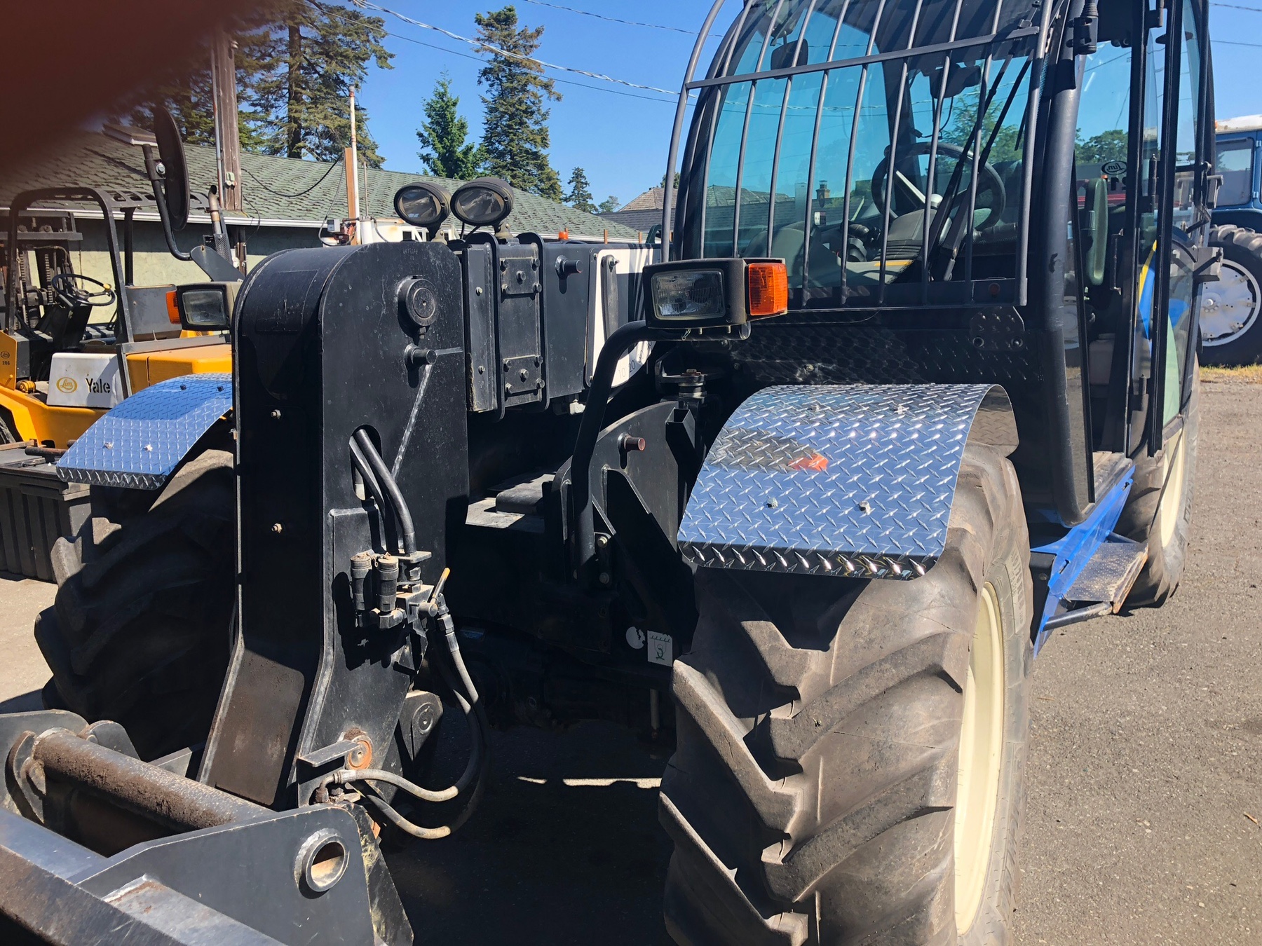

The front plastic fenders on my NH telehandler (purchased new in 2008) are toast. Between UV deterioration and the fenders "catching" on full turn/extreme axle oscillations this is what they looked like:

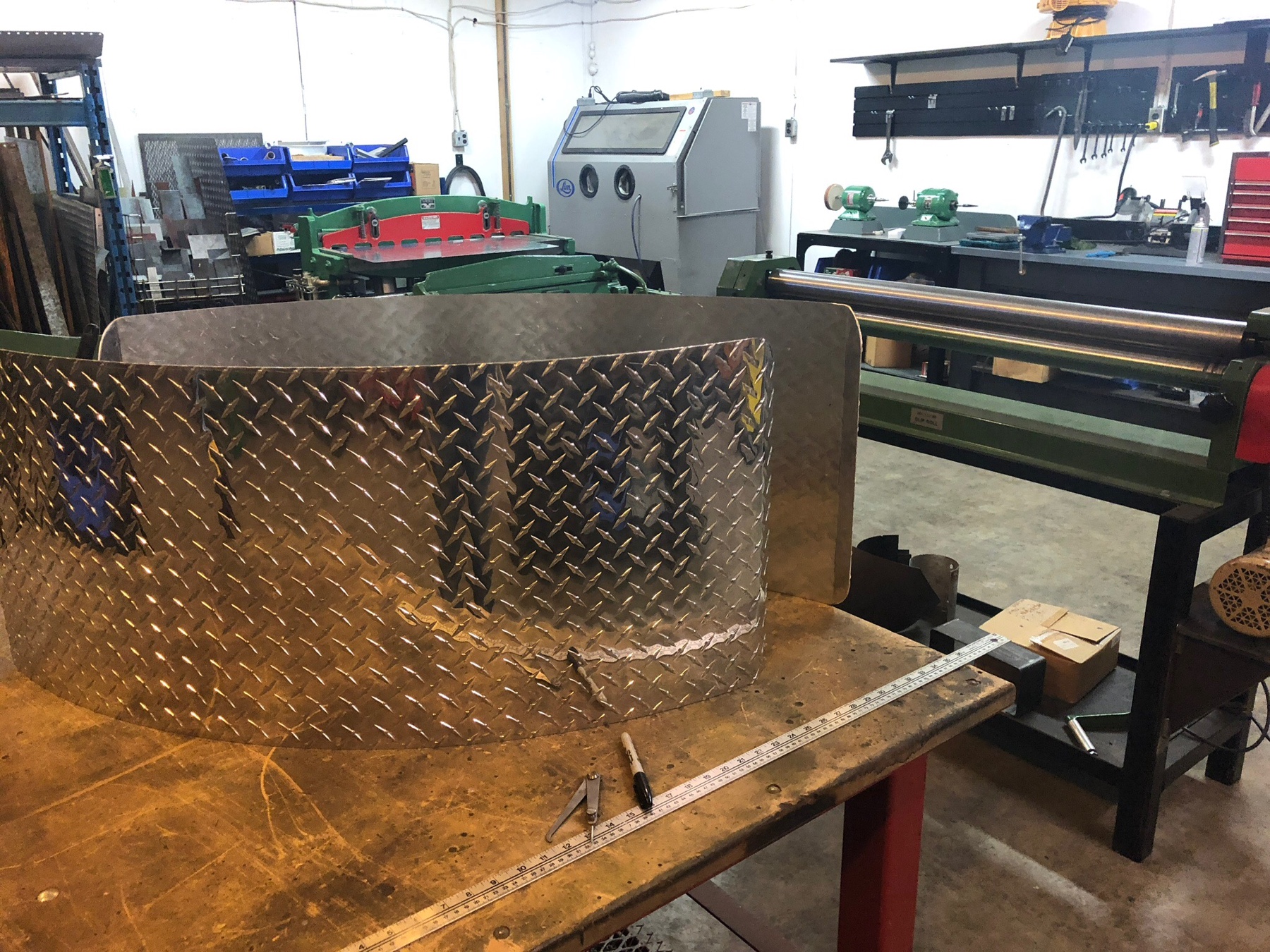

New Holland wanted close to $2000 for a new set, so I decided to try bending up a pair using .09 (approximately 11 gauge) aluminum checker plate I had left over from a previous project.
They turned out good enough for a couple of hours work. What really annoyed me was when I removed the originals I realized either the factory or the dealer had installed them on the incorrect sides (left and right). The barely noticeable 1" offset probably contributed to their early demise.
I'll have to pick up more aluminum to replace the two rear fenders.
View attachment 555491View attachment 555492
I suppose going back to dealer on a 10 year old screw up is not going to get you far. DIYers looking good though!
