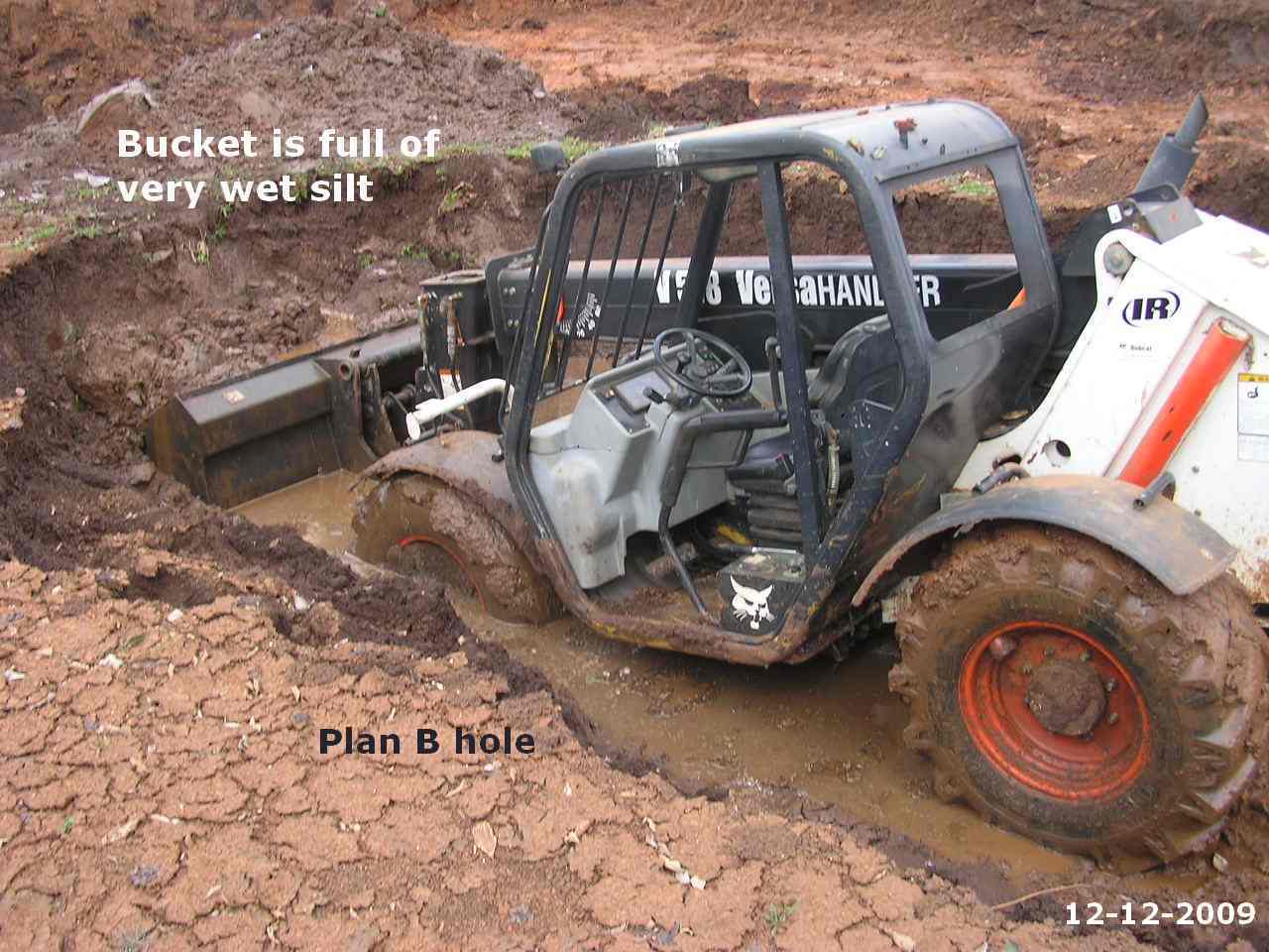

I swapped the front tires side to side, reversing the tread, on this V518 when I was removing silt from my pond.
It gave me more traction backing up, I could really tell the difference. :thumbsup:
