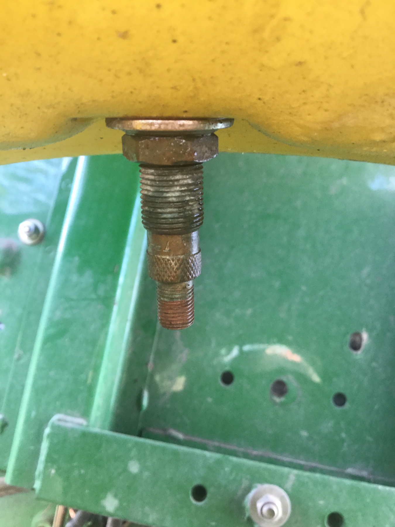

Stupid question, but here goes:
Bad valve on tire. Can I just unscrew internal air valve core, like a car tire and replace it with some of the spares cores I have?
On a Deere 5075E w/ filled tires. Tires weren’t soft, I wanted to check pressure. 1st thing I did was park valve at 12:00 and blew valve out with air hose. As soon as I did that I could hear valve leaking.
What I exactly am I looking at? Does core only screw into the little valve stem? Think I need that whole assembly that screws onto bigger stem, or just replace core with any old one that works? Is the big stem that attaches to rim for adding ballast?
I want to ask before I start taking things apart and end up with a stranded tractor with a flat tire, or a bunch of washer fluid on my lawn.
/ Tire valve - what is this? #2
Yep, common core.
If you are nimble you can probably change the core as it sits.
If not, I'd block or jack the tractor so it doesn't squish enough to squirt out fluid when it's flat.

I ended up jacking it up to take the weight off so I could give the axles a couple squirts of grease at the same time; and do the same on the other side without moving it.
...and yes, there is a regular old common valve core in that little adaptor stem like Ovrszd says.

yes need to add some. I do 12 o'clock check and blow in some air first. But usually it starts leaking air and spitting fluid. So I just expect to change the core every time. Keep some cores on hand always.

CobyRupert - your picture looks EXACTLY like what I have on the rear tires on my M6040. Core inside an insert, insert inside the main body. I would guess it has to do with adding fluid ballast to the rear tires - ??? I have RimGuard in my rear tires.

I think straight calcium in tires will corrode valve cores in few years, using Beetjuce or Ballast Star is better, better option would be wheel wights, even better option is 50+ hp tractor.
