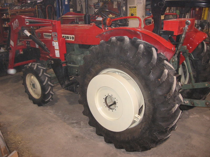

I thought this thru also last year and I went with rear wheel weights I built myself out of giant harmonic balancers.
I can take them off when and if I feel the need (with a cherry picker) and I can handle my tires easier if I need to take them off someday.
Plus I wasn't too keen on the very real possibility of a flat sometime givin the nail ridden garden property I have and then having all that ballast to deal with. as always ymmv :thumbsup:
