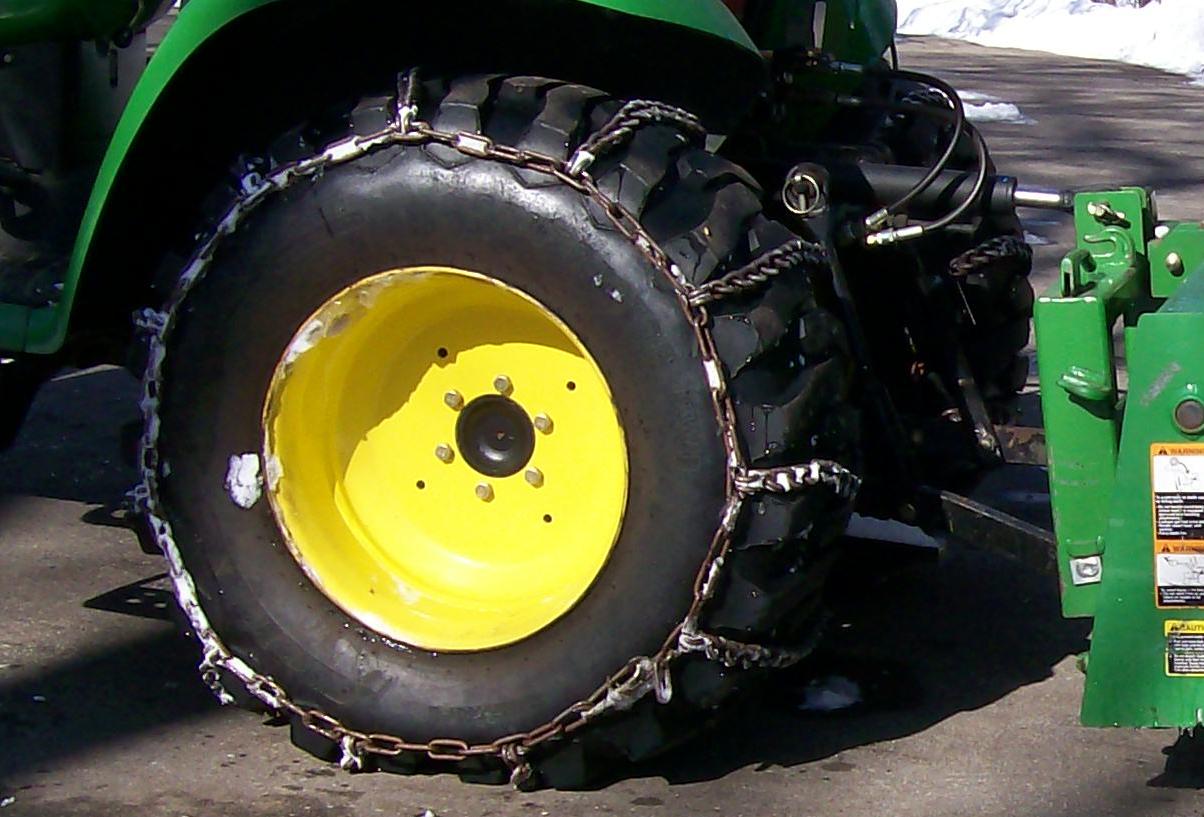

/ Tire Chains #7
I think these are what are called ladder type. The two runners that go around the outside diameter of the tire prevent the chains from falling between the lugs of the tire.

/ Tire Chains #8
This is what I call ladder type as well.

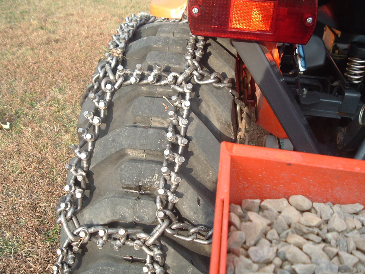

/ Tire Chains #9
Agreed; but I added second crosses, ie every 3 rd link= awesome, do believe they are then called 'double ladder'
The advantage is that there is always at least one or two cross links in contact with the ground. Makes a much smoother ride without the slip/grab slip/grab effect.
Also not very much costlier than single cross but much cheaper than other configurations.
In my case all my crosses are studded style and that sure is a plus.
Just yesterday I was plowing up a decent grade on pure (unwalkable) blue ice to clean up things.
Steering was via differential braking technique.
/ Tire Chains #10
Whistlepig's chains are different than the normal ladder like beenthere's. They have the two extra chains running the circumference of the tire which should make them very nice. When I ordered from tirechains.com, I got the two link ladder which would be like Piloon's.

Whistlepig's ladders look good with the two extra runners. I understand that traditional ladders, though, can get buried in the tread, which is why I am leaning toward double-ladder and/or double ring. The "rungs" cannot slip between tread.
