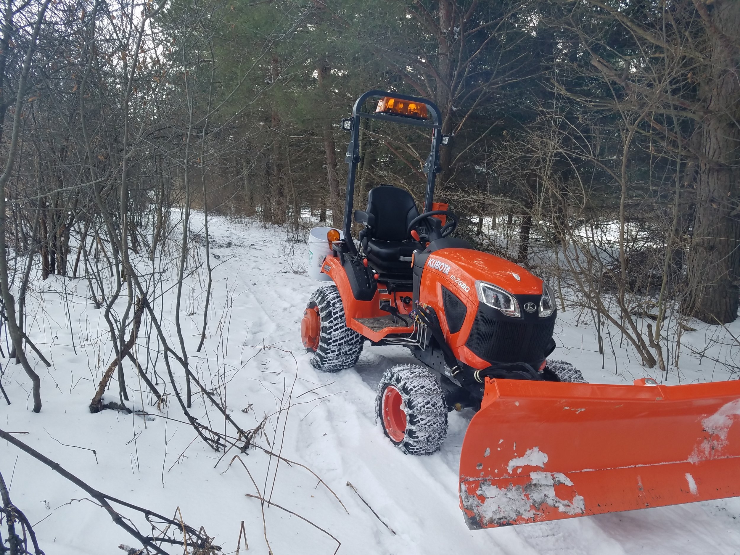

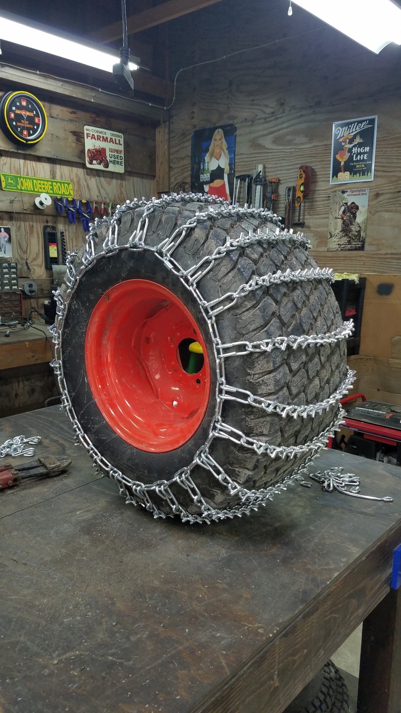

UPDATE on Chains for Turf Tires for Snow Blowing...
I went to a local Kubota Dealer to purchase a set of chains for my rear tires on a B7500 I had just purchased used with turf tires. Honestly I couldn't even move in the snow this past winter.
They were out of the twisted link type chains and the ONLY ones available were a loose link type (not sure what the real type is called) manufactured in Austria and another type that had "spikes" on them. I almost choked when they told me the price of the loose link, over twice as much as the twist link I had purchased for my larger tractor. The biggest issue was the size of the tire the were going on BUT... I bit the bullet and purchased them.
I have to say these are the most unbelievable chains I have ever used. No problems now with going up and down the hills as well as snow blowing LOTS of heavy snow that packed when compressed.

Good looking set of chains. I had to get 3 more sets this past winter also. It does hurt the pocket book a bit.
