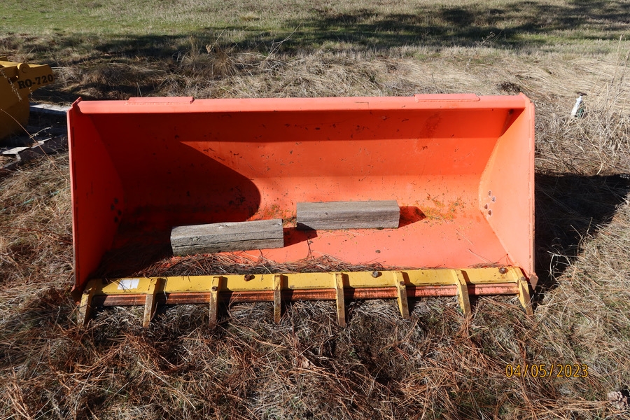

I made a grapple out of debris forks, great idea but not functional.
The tines are only for loose, light material and will bend with any kind of force.
The arm attached to your existing loader bucket will work better than any manure tines for moving brush and a true grapple will clean up the best.
I ended up buying a grapple to clean up from the big trees cut and topped around the cabin.
