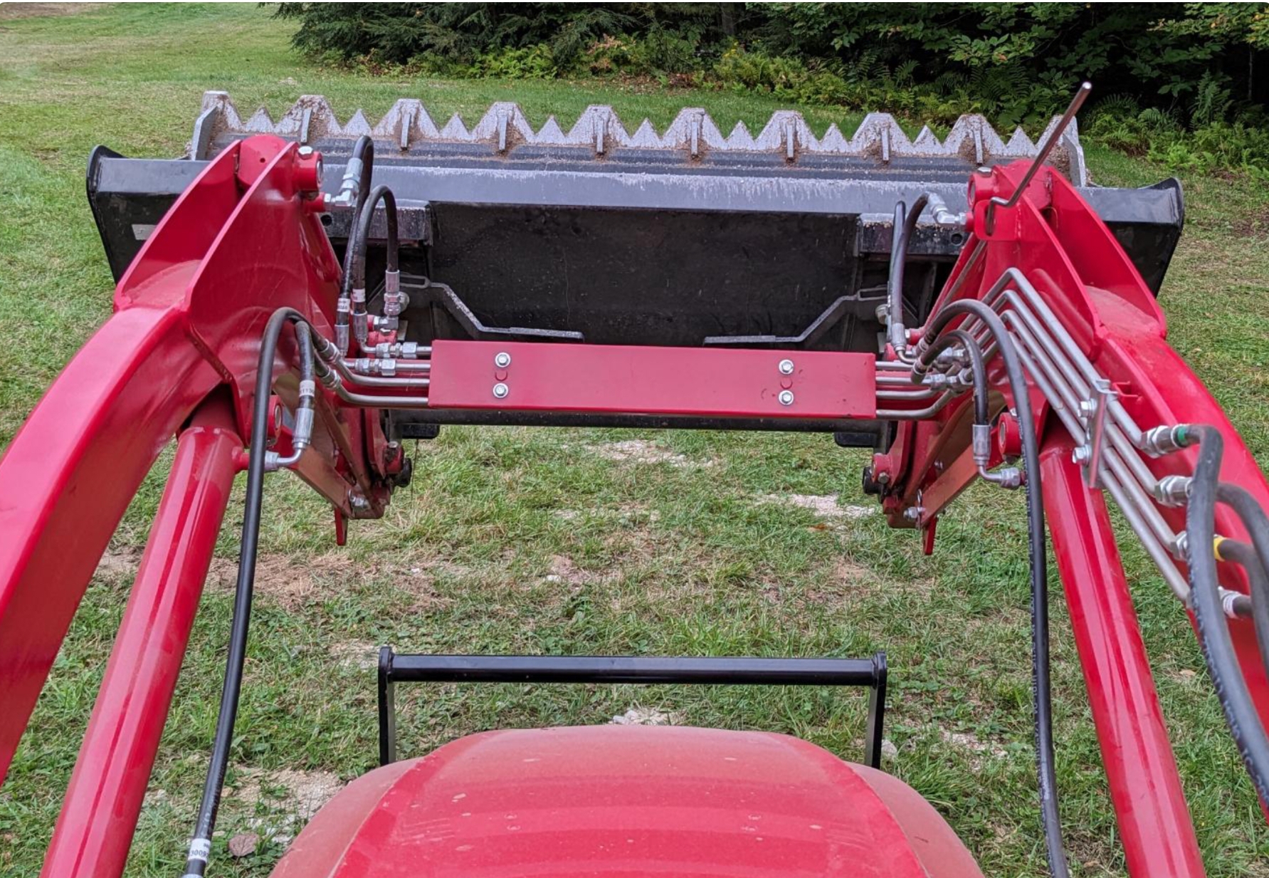

I have only had smooth buckets. On my current Kubota (L6060) did get a teeth bar (no idea the brand) bolt on design. For removing plants or digging in hard dirt like the tooth bar on. Otherwise don't need the extra weight nor the extra length and want a smooth bottom on the bucket. Getting dirt or rocks off of concrete or smoothing dirt I do not like the tooth bar. The tooth bar does extend past the bucket or course and it easy to damage something much easier for me than the smooth bucket.
   / Toothed bucket vs bolt on tooth bar? #22
I have an ATI tooth bar and all 4 of my buckets are drilled to fit it. I'm 74 and it takes me about 5 minutes start to finish to take it off or put it on. Reason why I like the ATI is the each tooth is replaceable and all the teeth are hardened alloy steel and you can get them in Tungsten Carbide if you want.
   / Toothed bucket vs bolt on tooth bar? #23
I use the bucket on my Steiner all the time. I decided to go with a bolt on bar because it will reduce the wear on the leading edge of the bucket. . I'm also lazy and don't look forward to having to cut off the worn leading edge , grinding to fit and welding a new edge onto the bucket. Like I said , I use mine a lot and the buckets for lightweight equipment are not as heavy/durable as larger loaders so it is easy to wear the bucket more on one side than the other. also a bolt on adds a little more stiffness to the smaller buckets
   / Toothed bucket vs bolt on tooth bar? #24
I purchased a tooth bar at auction had to cut it down a few inches. Then drilled 2 holes to mount it. It works great only takes a few minutes to install and it cost me less than $75. A local rental shop closed bar is a Bobcat one I believe. I have a New Holland compact with 54” bucket
   / Toothed bucket vs bolt on tooth bar? #25
I am amazed to learn that people put teeth on their tractor buckets. I have never seen them on a farm tractor, we work the ground with an implement on the back of the tractor then scoop it up with a smooth bucket. We have special buckets for manure or stones.
   / Toothed bucket vs bolt on tooth bar? #26
I bought my Kubota B3030 with a bolt on tooth bar with replaceable teeth (never had to replace). It performs significantly better excavating, and it can be removed in a minute (two bolts). With it on, you can only smooth with the back corner of the bucket, not the edge. I need to remove the tooth bar to plow snow or to install forks that attach to the edge and secure with chain and ratchet binders.
   / Toothed bucket vs bolt on tooth bar? #27

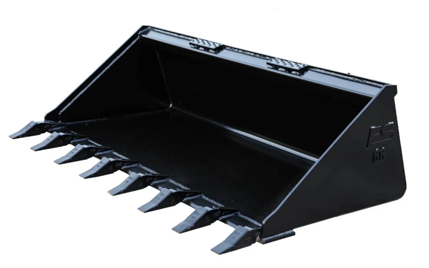

I bought an additional, very narrow, heavy duty bucket and welded teeth onto it. When I need teeth I use the narrow bucket with long teeth. When I don't, I use the wider bucket with smooth edge. I will say...I find myself leaving the tooth bucket on the tractor because I have so many large rocks in my area.

Two words: Ratchet Rake. Have a look before you buy anything else.
I have a L2501 with a Ratchet Rake that is about 6” narrower than the bucket.
It is a beast and very easy on and off with the ratchet straps. I use it for leveling my gravel road and for back dragging/clearing weeds and brush. (There is none better). I even rake my back field with it. The metal is 1/2” with two sets of teeth at 90 degrees to each other (Forward and down).
Install is 3-4 minutes and with good planning (It was removed on level ground) these is NO lifting.
I’m 72 and the thing is very easy to put on and take off.
Wish I had known about this and a grapple 25 years ago.
Looks like the 60” bar is $420 shipped lower 48.

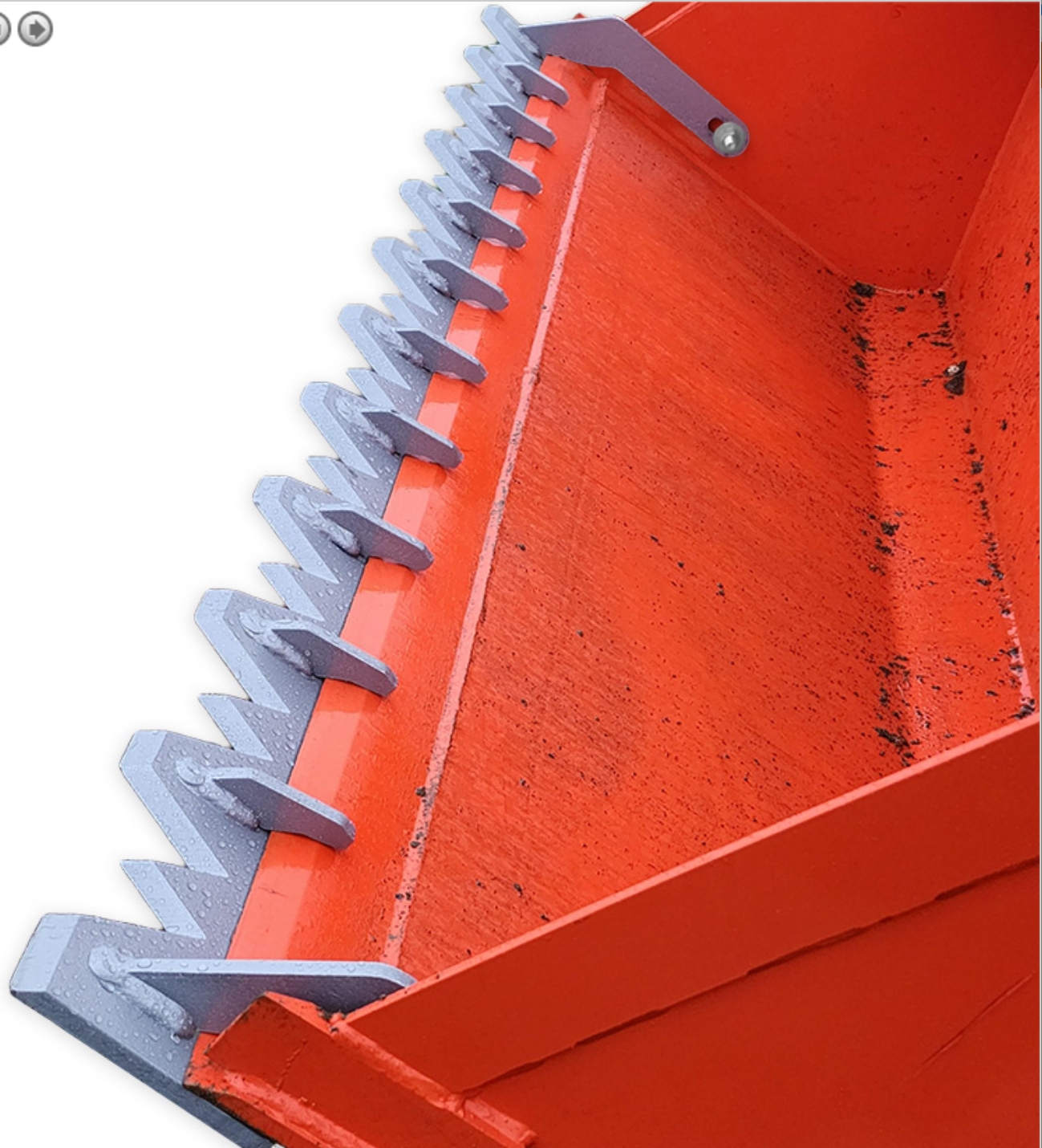

I have the bolt on toothed edge from EA. I have never used a toothed bucket. I love my toothed edge, It cuts into soil very well. I can back drag to a smooth surface. It does have some weight to it, I wouldn't want to take off, put on often. But, I see no need to take it off. The only reason would be to have a smooth back drag, but when it's on, I can get a smooth back drag. I would buy another one in an instant if I changed tractors...
I have the bolt on also but I had a neighbor weld it on. It doubles the buckets lip thickness and I will never wear it out. It also increase bucket lip thickness so digging is no problem. Back dragging smooths and teeth also work at digging rocks and roots out. Removing concrete slabs, rocks or moving logs works great by using a tooth to break loose from ground or raising a log to wrap cable around. Works great for pushing small trees by just placing between two teeth and pushing. No worry about tree sliding off to the side.
   / Toothed bucket vs bolt on tooth bar? #33
I have a Piranha tooth edge. It makes it easier to dig. The bottom is flat for back dragging. Don't know why you'd need to remove it for making a smooth surface.
Same, like mine. Never remove it.
   / Toothed bucket vs bolt on tooth bar? #34
I have the Piranha tooth bar on my B2601 Kubota. So far, I have had no reason to unbolt it. It digs, can smooth (going backwards), and utterly destroys brush and small saplings. Doesn't affect the operation of the bucket (scoop/carry/dump) at all.
I will second the advice about making sure the teeth are on the ground when you are done. Those teeth are hard, strong and sharp, and if you walk into them, your next stop is the Emergency Room. It will hurt, too.

Seems most of you guys with the Piranha tout its ability to grub roots, sever saplings and deal with brush and trees...some giving kudos to its digging in hard dirt.
OTOH, the few tooth bucket responses tend to lean towards it's potential in rocky soil...
Am I reading between the lines accurately?

Pirhana bar will dig rocky soil as well. Without ever owning a toothed bucket, my pirhana bar does the same job and more.
