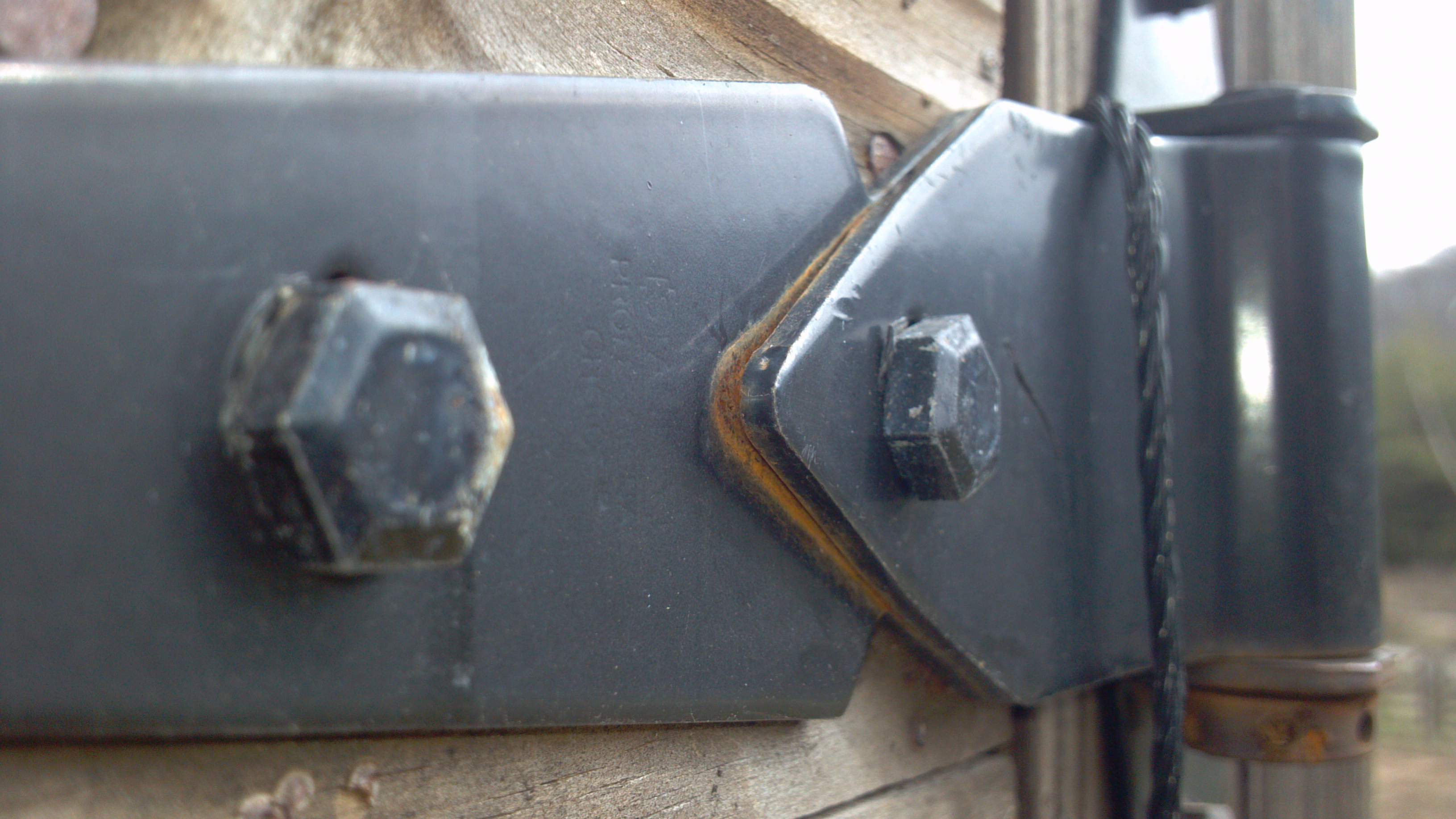

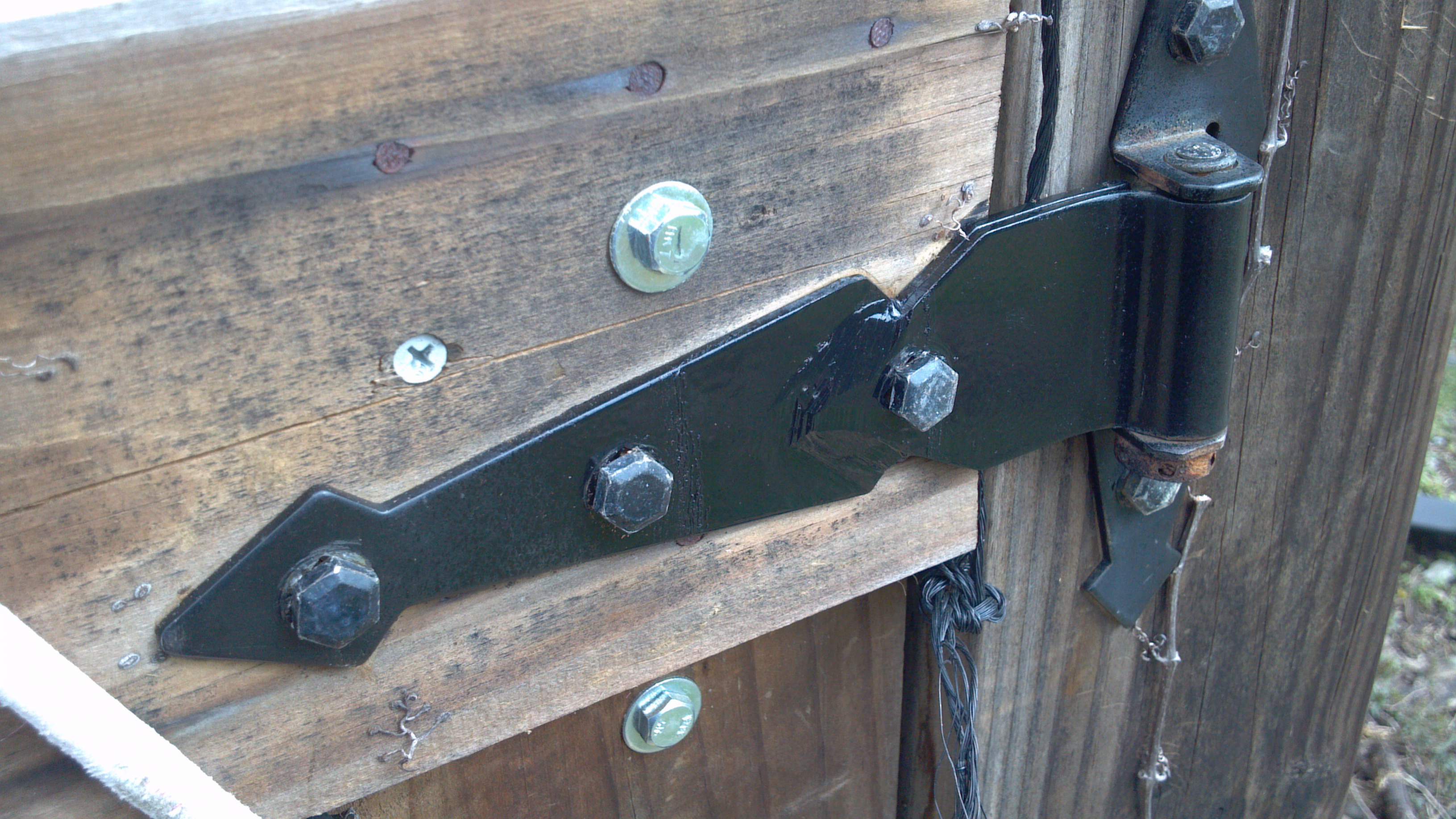

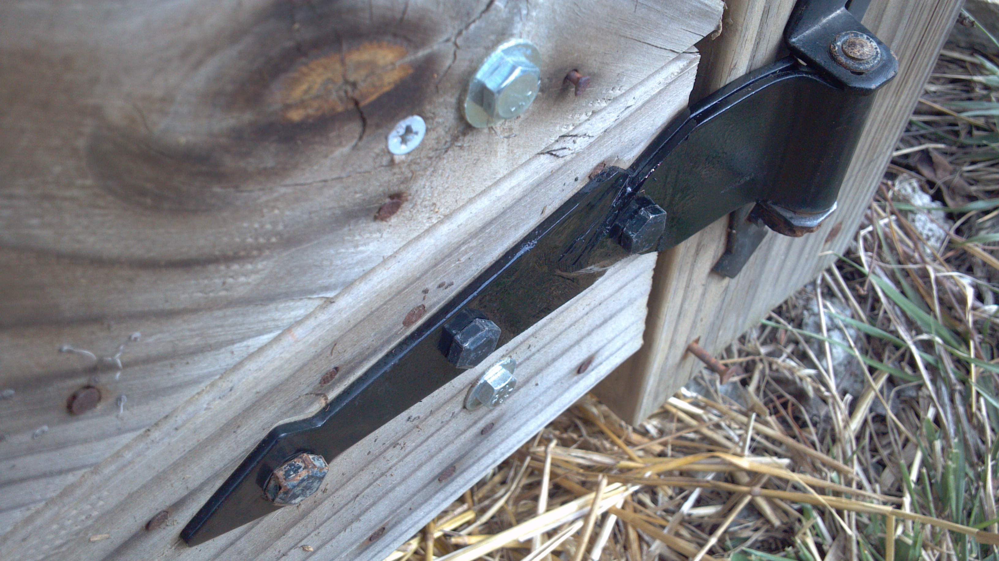

Just thought I'd dump this little repair here, since it didn't deserve a whole thread of its own.
The hinges on my barn door are poorly designed. They bend and separate and break over time. You can see the separation starting in the photo above. One of them had broken completely. I had actually gone to TSC and bought replacements, and was pulling back into the driveway when I realized: hinges are made of metal. And I have a welder. Duh!
FIXED! I think they may continue to break, in which case I will weld up the side-seam between the front and back plates, which really ought to do the trick. But I didn't think of that until after I painted them and put them back on the door, so I didn't think it was worth the trouble to go back and do it now.
   / Thoughts on this used welder? #255
Looks good! That's exactly the sort of farm repair I bought my welders for.
(and that weld sure looks prettier than some of mine!)
   / Thoughts on this used welder? #256
Ain't it cool to have a welder.?:cool2:.. From the looks of those hinges I think they were designed for looks not for strength... so if they break again, weld em back! or add some more metal to them..
James K0UA

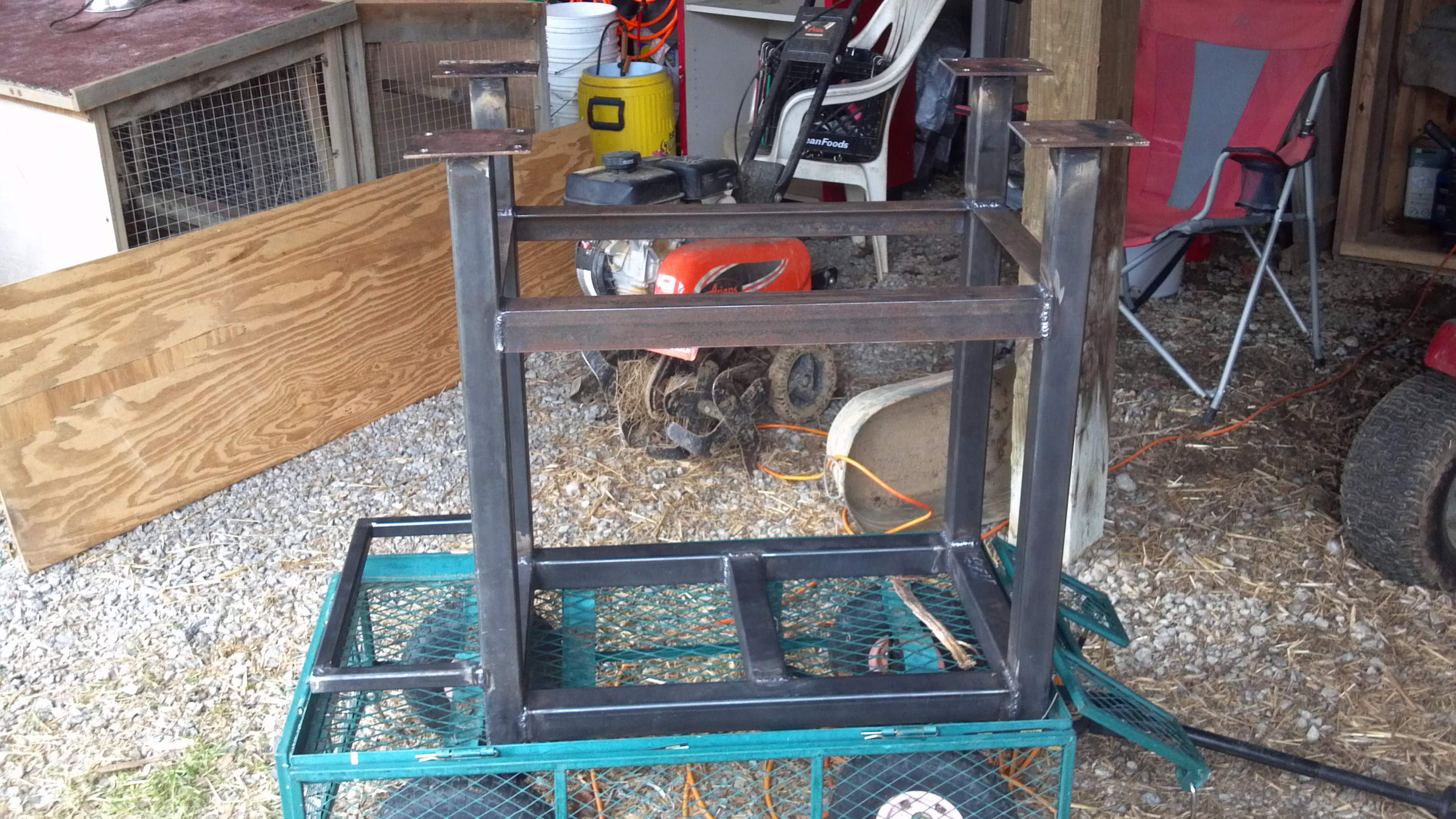

My current project is a small portable welding table. I don't have permanent shelter near my 220v outlet, so I'm constantly rolling my welder into and out of the basement. I currently weld on a pair of saw horses, but that's hardly ideal. The welding table will provide both a work surface and a cart in one.
Here's the table in its current state (upside down, of course). I have learned a whole lot about keeping things square and true in this project. I got the legs within 1/4" of square while welding up the top of the table, then used a hydraulic jack to push them into final position while welding in the lower shelf support. I can't even really imagine how somebody would build something like this without the lower supports to keep the legs that last little bit of true.
Of course, after finishing welding the legs on, they were not all the same length. Well, they were all cut to the same length, but they didn't all get welded onto the top at exactly the same height, so with the top level, not all four legs were touching the ground. I worked around this by welding on the two "low" legs' plates first, then leveling the table top and sliding the "high" legs' plates underneath them, then tacking them on such that the orientation between the "high" leg and the ground was maintained. The final result is that there is about 1/16" of wobble, but I concluded that was about as good as I was likely to get and left well enough alone. I plan to take out that last bit of wobble by shimming the caster with washers.

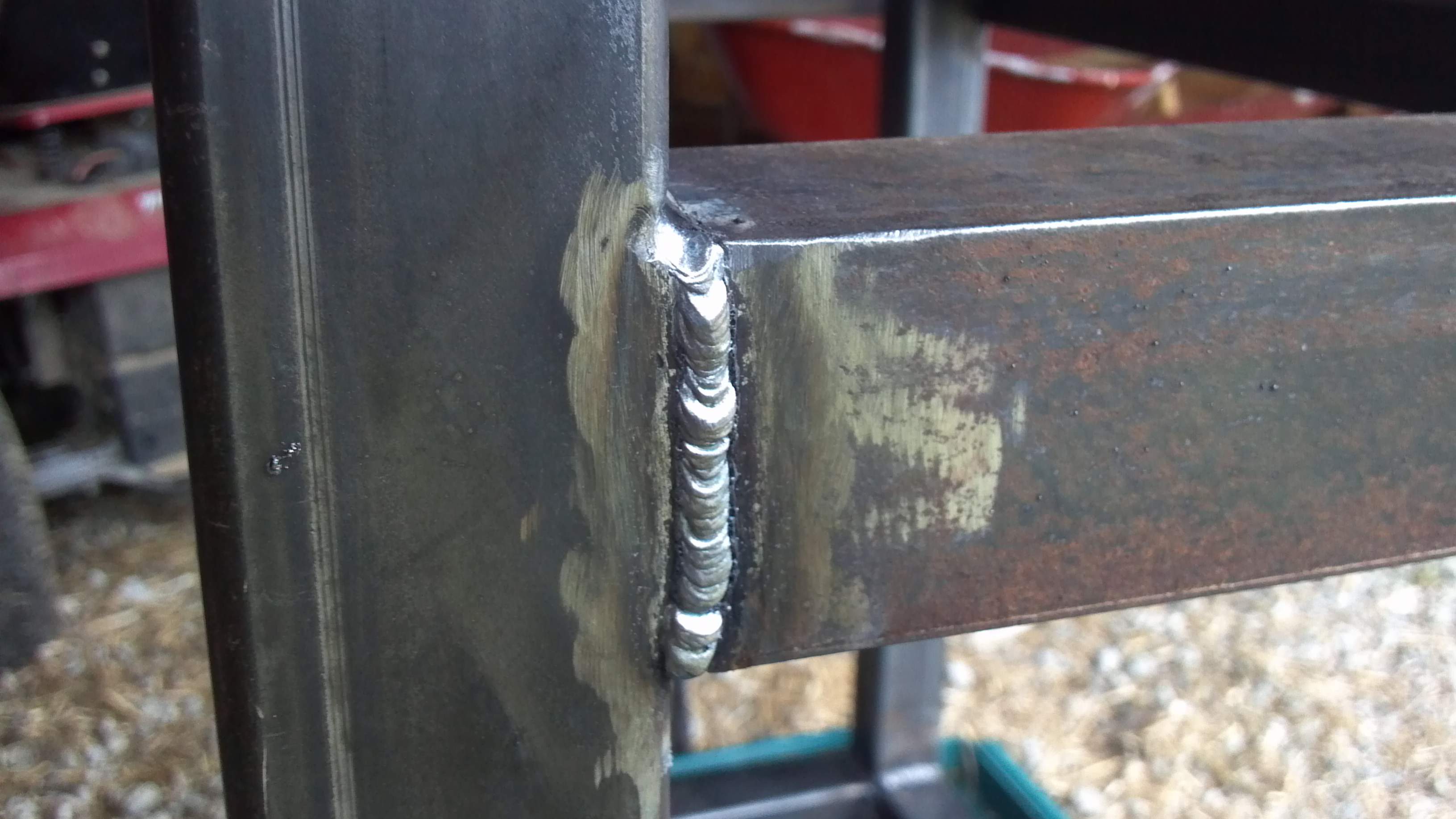

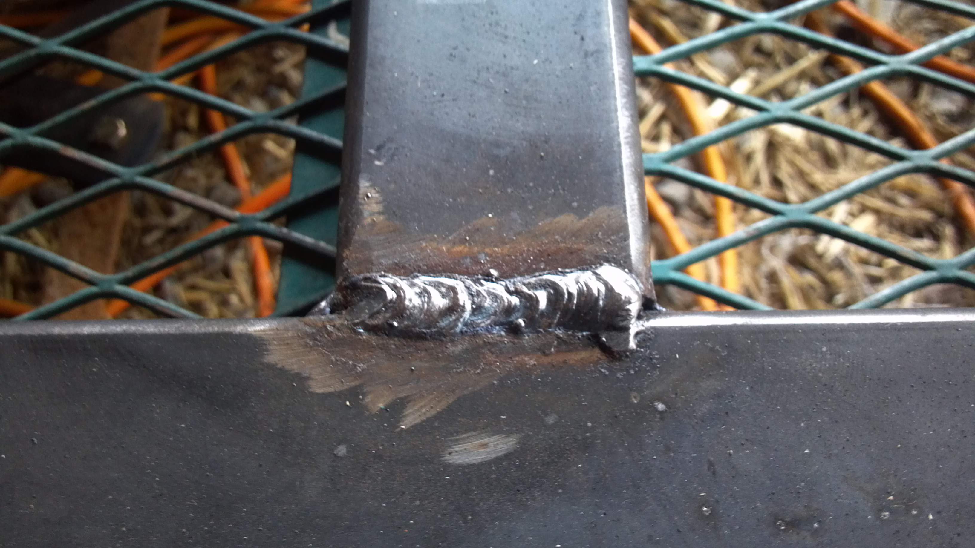

Above are a couple examples of my welds on this project. As I said, they are hardly even worth critiquing, but they are worlds better than my 6010 used to be. The main thing that I think is wrong with them is that they are cold. Either that, or my travel speed was too slow, but I suspect coldness is the issue. Unfortunately, when I ran hotter, I tended to blow through. Only by turning down the heat could I get the puddle to work slowly enough that I could manipulate it with any consistency.

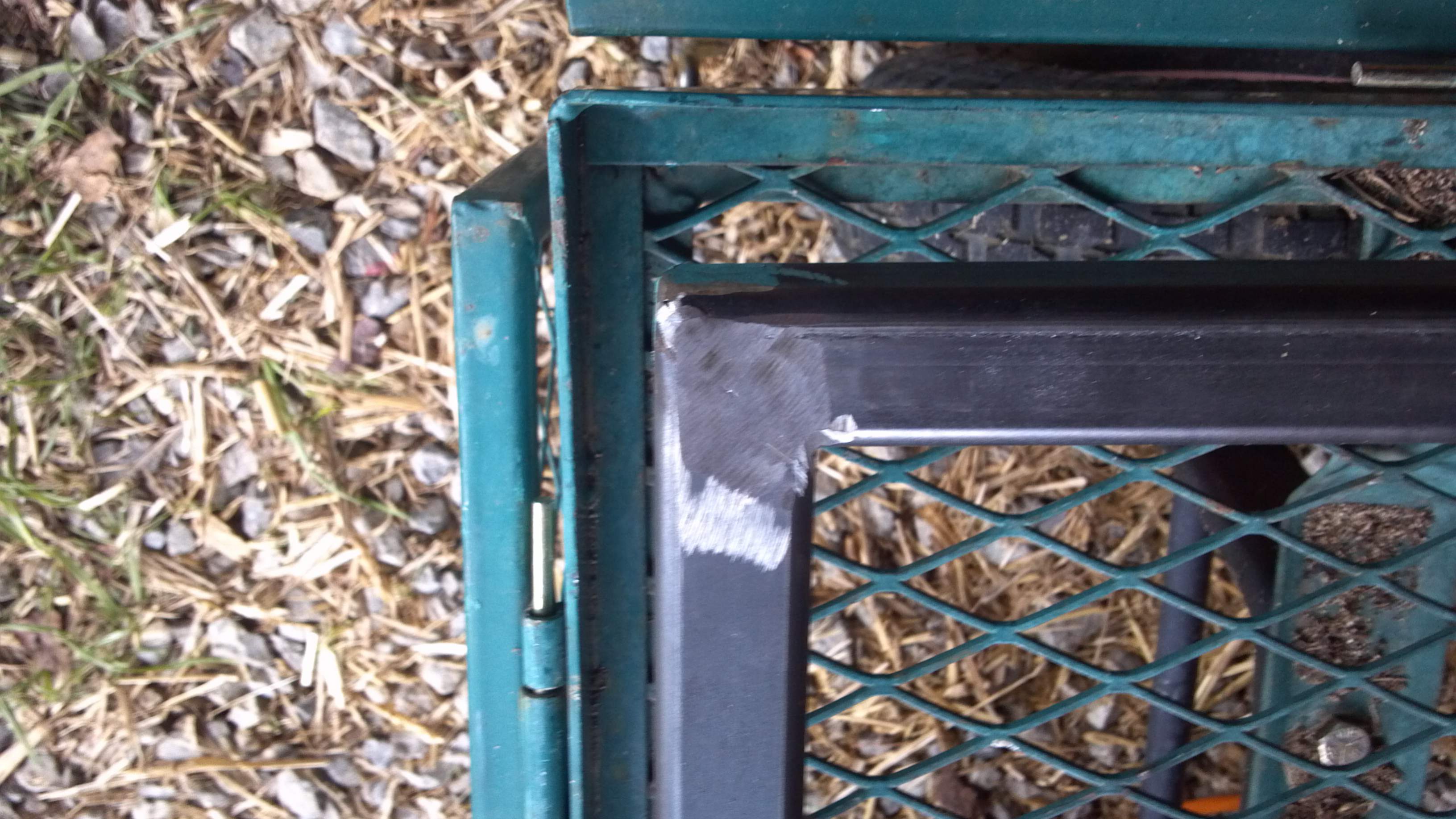

Finally, here's the weld in the project that I am most proud of. This is the handle of the cart, so I ground the weld smooth, since it would be coming into frequent contact with people's hands. When I finished, and there was no undercutting or porosity--just a smooth metal surface, as if it had always been that way--I was really thrilled.
EDIT: In case you're wondering, this is all 1/8" thick material, and I'm welding using about 60 amps with 3/32" E6011.

In time you'll figure out with 6010, and 6011 arc length plays a big part! Long arc length gap is a hot flowing puddle. Close arc length is a colder dryer puddle.
You really need to work on wrapping your corners. ;)
