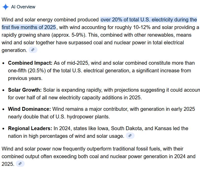

The U.S. consumes almost 2.5 times the amount of energy as China per capita.
China uses double the amount of electricity than the U.S. but has 4 times as many people as the U.S.

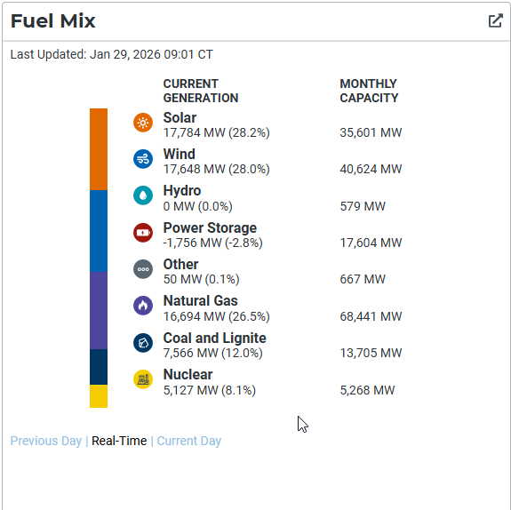

Solar and wind are providing 56% of the Texas power grid as of 0901 this morning. Power storage systems are being recharged for use after dark. A healthy mix of power sources is a good thing. I don't think any of them are going away anytime soon.
A healthy mix is important. Here in indiana we experience a polar vortex pretty much every year. And for a few days there is no sun and the wind can be very limited.
