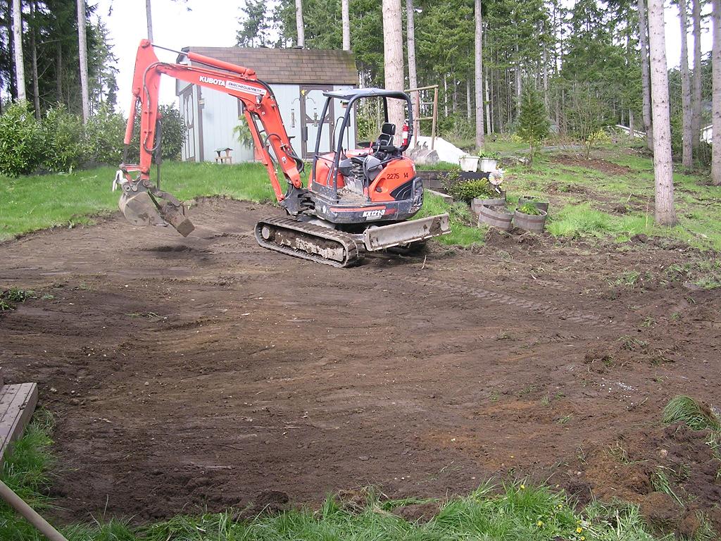

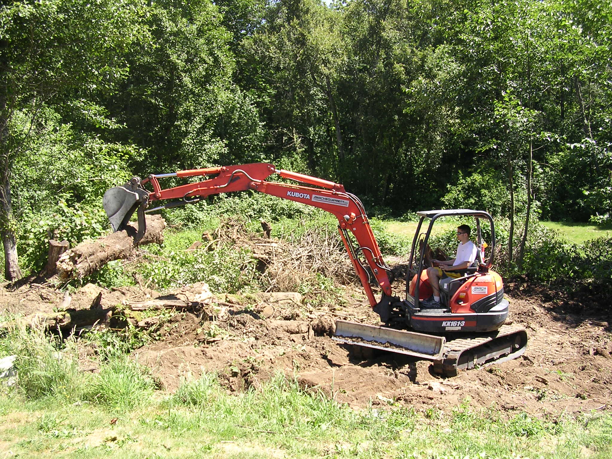

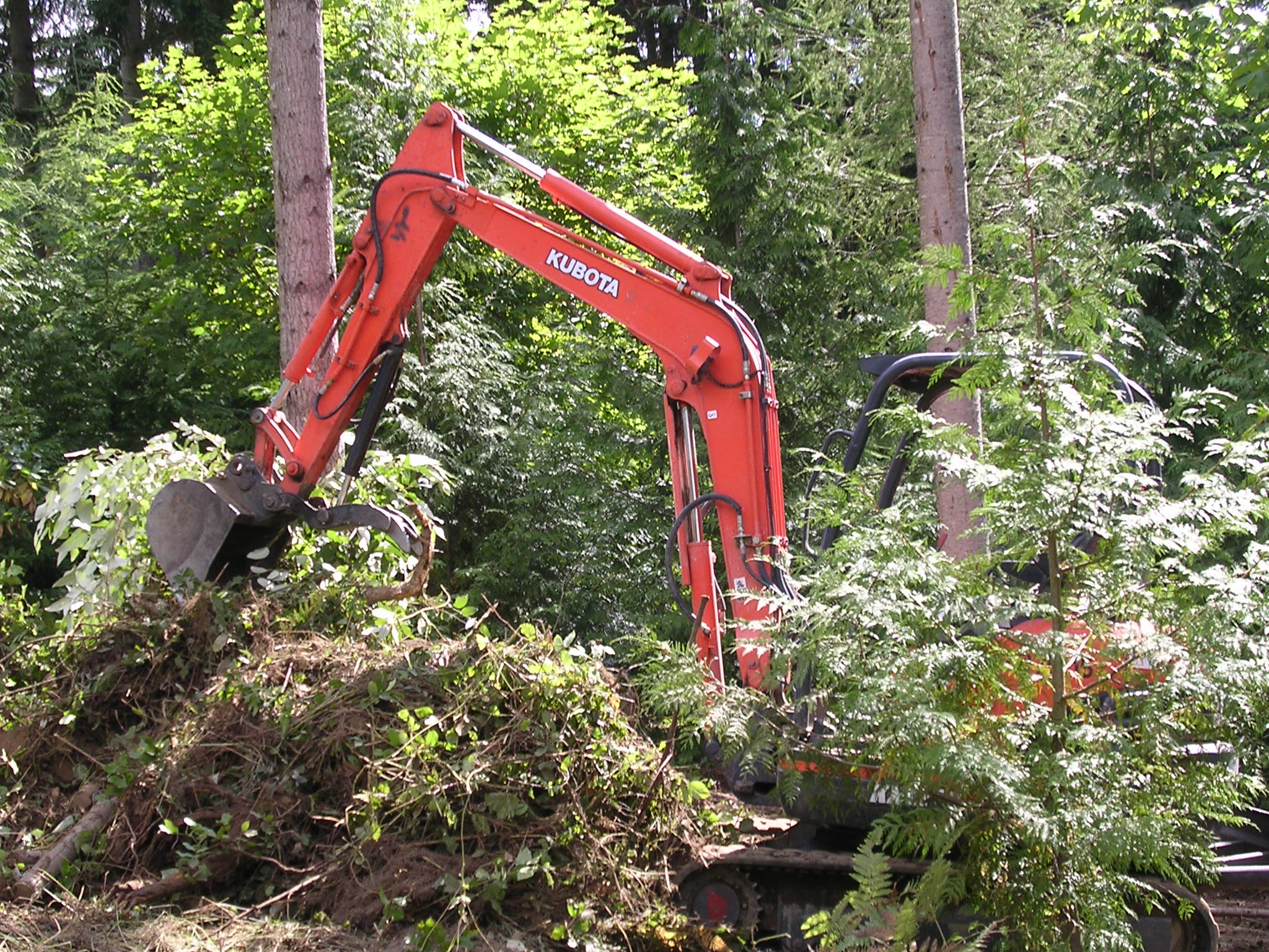

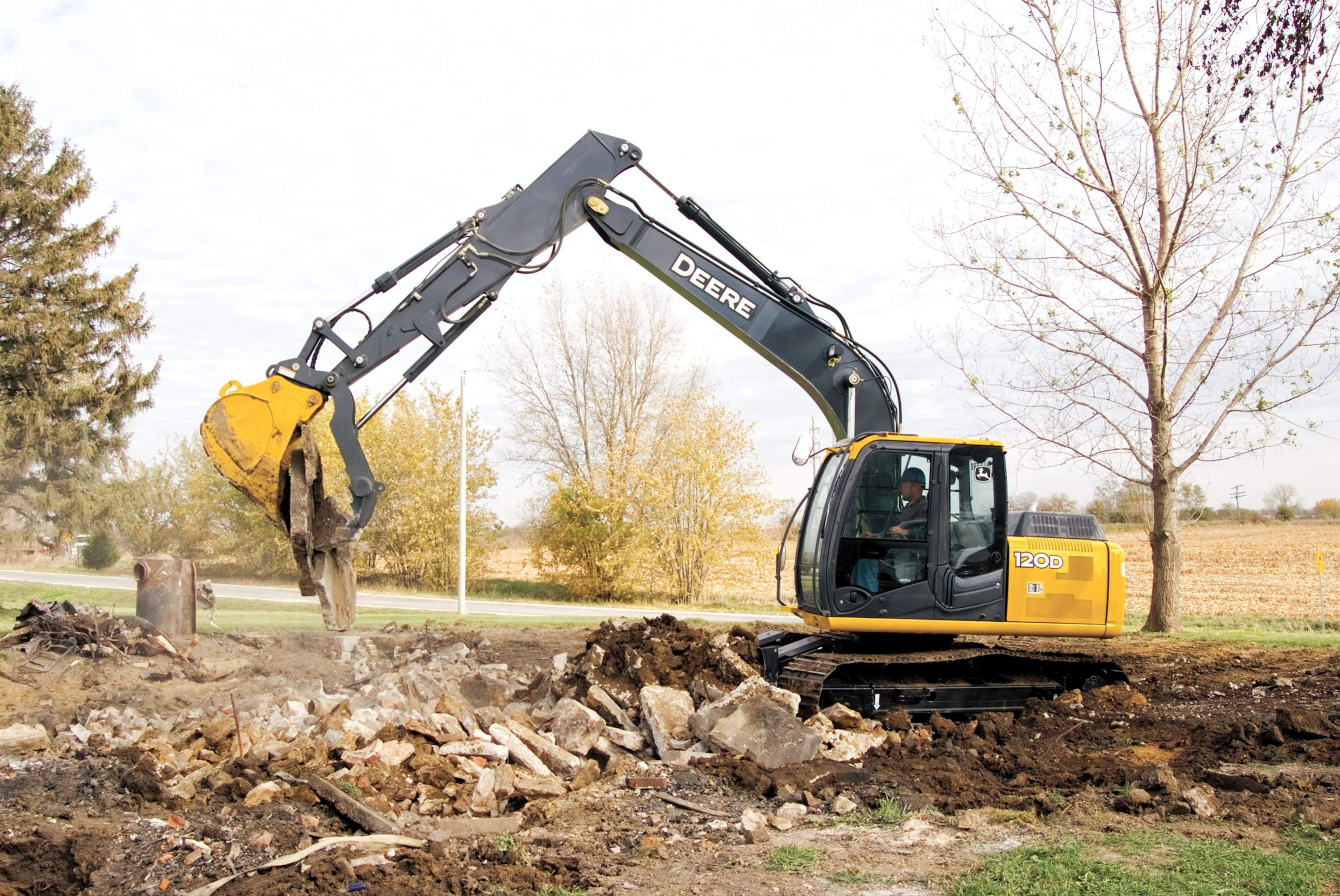

8934...on the thumb be sure the hyd system is not a one way (not sure that is what they are called) for a hyd jack or such as they only have pressure on direction.
If you are just digging dirt then I would not get a thumb. If you are moving anything other than dirt....GET A THUMB. If digging up trees or stumps you can dig them and then pile or load them so easy. You probably have a manual and have read it but don't miss the different if lift (tipping) capacity over the front end or the sides and over the rear. You probably have greater lift capacity over the rear with the blade giving some ballast. I have also found if digging like on slope (in my case piles of dirt) I let the rear end face the pile and then use the blade to level my machine. You would do well to get in a wide open area and play with it with weight in bucket would be great but even empty will give you some feed back how stable it is with the bucket as far out as possible over each side. If you install a thumb and begin to lift and swing with loads or even with out a thumb if you are pinching a log or large stump and the machine begins to tip...be ready to drop that load to save your machine and possibly you. But you must drop it before the machine very far over or it will continue.
Be careful on a thumb..there were some on ebay that will really disappoint you. Be prepared to spend about a $1,000. Ask and find out who locally builds them for the big boys. One want a shop that either has the specs on your machine or will come measure it and of course weld it on unless your booms has the lugs already part of it's design.
Get you a large can of wasp spray and have it handy and unless you have a windshield wear eye protection. Then last but not least, be sure what you are pulling towards you if you have open cab..you do not want to pull a wasp or hornet nest or snake in there with you. HAVE FUN
