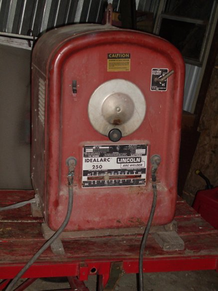

I picked this idealark last weekend for $200 with 50ft of lead and ground. It's a 1958 with the switch in upper right to change from DC+, DC- or AC. After running a few beads with DC+ and 6011, I dought I'll be using AC much at all. The only negitive is it's 3 times bigger than my tombstone AC.

Cleatus, with the price of copper as high as it is, you would pay 200 bucks or more for just the cables...... I think you got a great deal... those old welders last for ever.
