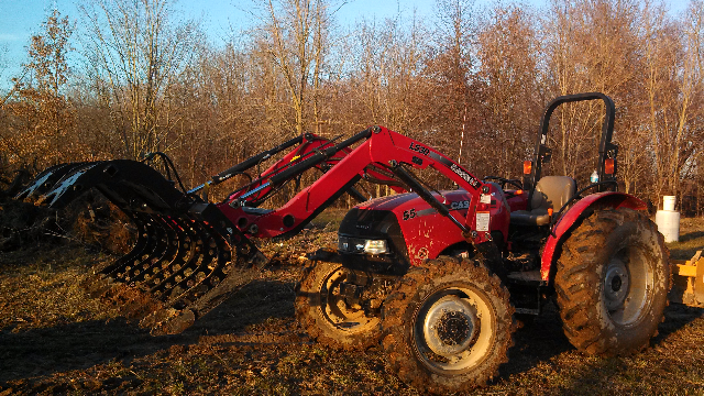

/ The WICKED Root & Debris GRAPPLE!!!!!!! #144
Here is the stump Travis was talking about.
The tree was halfways up rooted. I had to finish digging it out.
I think the load would be off center trying to grab a big rock with one lid. It would make the tractor unstable. I would probably grab it in the middle. When you grab a log or even brush there is not always a even load put on the lid. The lids are pretty beefy. They are not open like alot of other grapples. Since the lids have the top and bottom guards it will help keep them from twisting. I can put the tractor in low range, 4WD, diff locked, lift and curl with the loader all at the same time and nothing gives on the grapple. It is indestructible on a compact tractor under normal operating conditions.

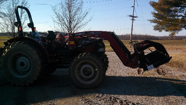

/ The WICKED Root & Debris GRAPPLE!!!!!!! #155
I bought my 72" in July and never looked back on the price. These things are light and tough as nails. Only thing I would change is some screen or plate to keep limbs from reaching through and scratching up the front of the tractor.
