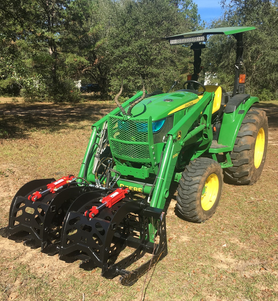

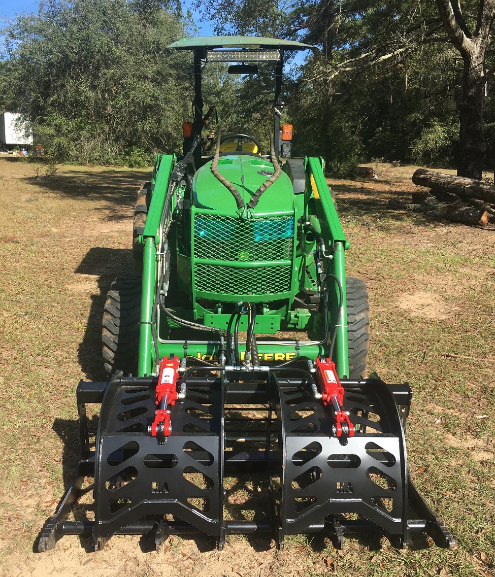

I must admit it. I've never seen anything quite like this 4052M John Deere, which has our 60" Wicked Grapple up front.
Travis

Yep, that is a Wicked Horny machine. :laughing:

It's definitely different. The owner is a very nice guy from Florida. I posted a video yesterday on the EA Facebook Page of this thing carrying a huge, wicked bunch of logs!
