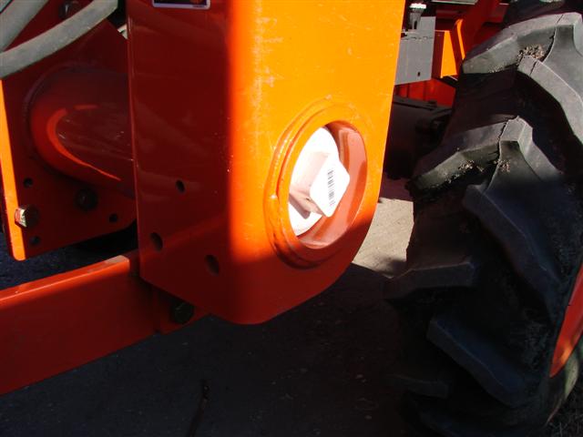

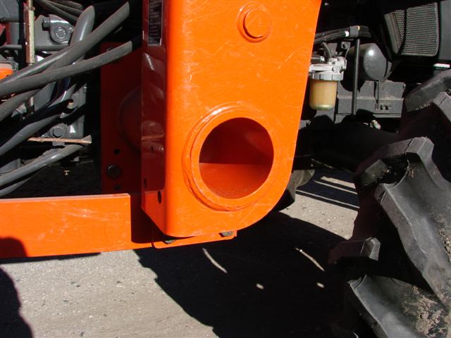

It goes in the hole in the fel as seen in photo 1.

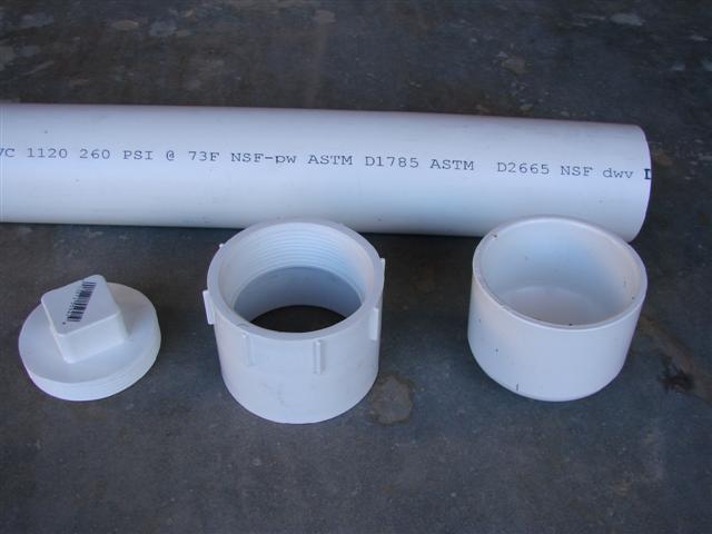

It only takes a piece of 3" pvc pipe and 3 fittings as you see in photo 2.
You cut the pipe to the correct length to fit all the way in the hole without rubbing on the tubing at the rear of the right side hole. The left side is one inch longer than the right side on mine. Then I fit mine in a fraction further than flush so nothing can hit it as seen in photo 3.

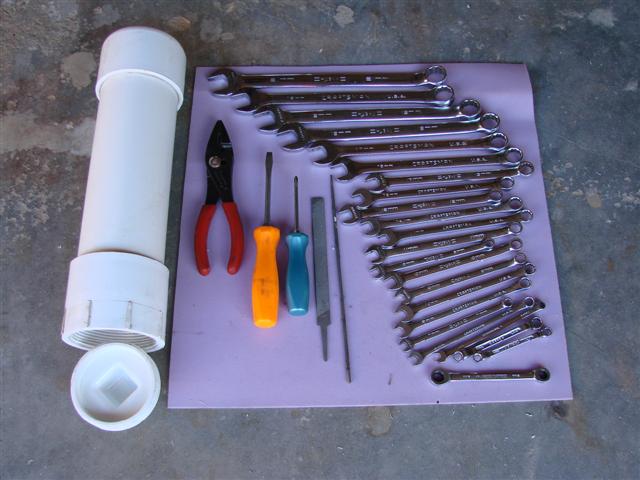

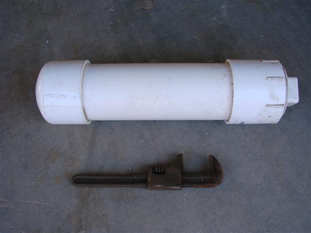

The toolbox can be removed to carry with you to the job area. To keep the lid screwed tight so tools don't fall out I use this wrench which I keep in the stock toolbox that came with the Kubota. Photos 4 and 5.

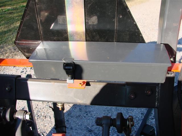

This shows the amount of tools that fit in one toolbox. This is not the typical tools that I carry around. I also lined the inside with a thin piece of foam that I had to prevent rattling. Photo 6.
