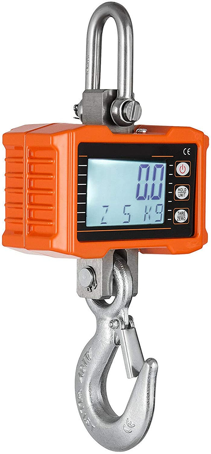

A good friend has made this discussion a little easier by sending me a scale by which I can actually check the weight of a Toro Workman. I will still have to have time to do this, and it won't be possible to check the previous ones I handled because they are 550 miles away now. The ones I have at home are cab units or have several more options that add significant weight. I may check to see how the Kubota does lifting the open station one.
