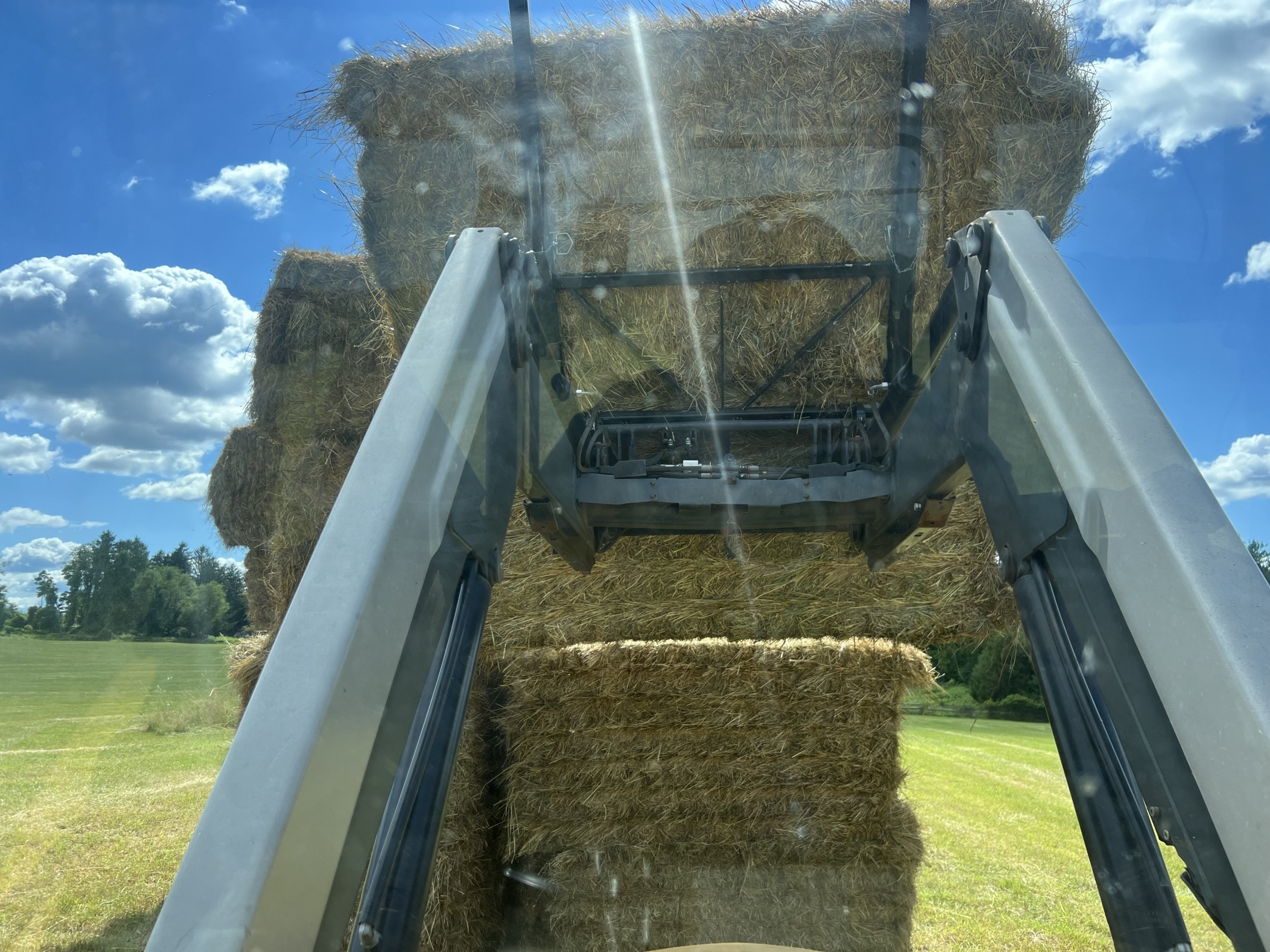

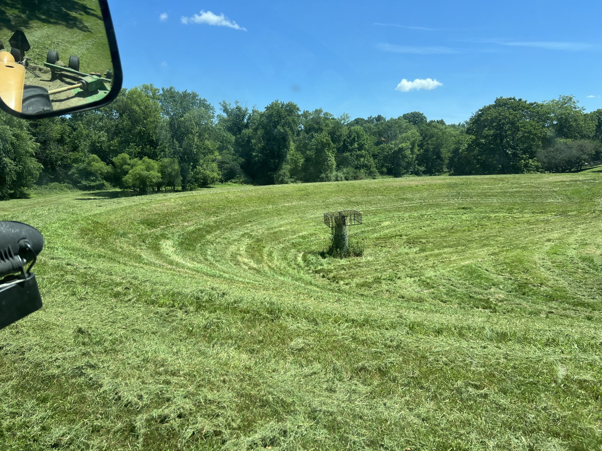

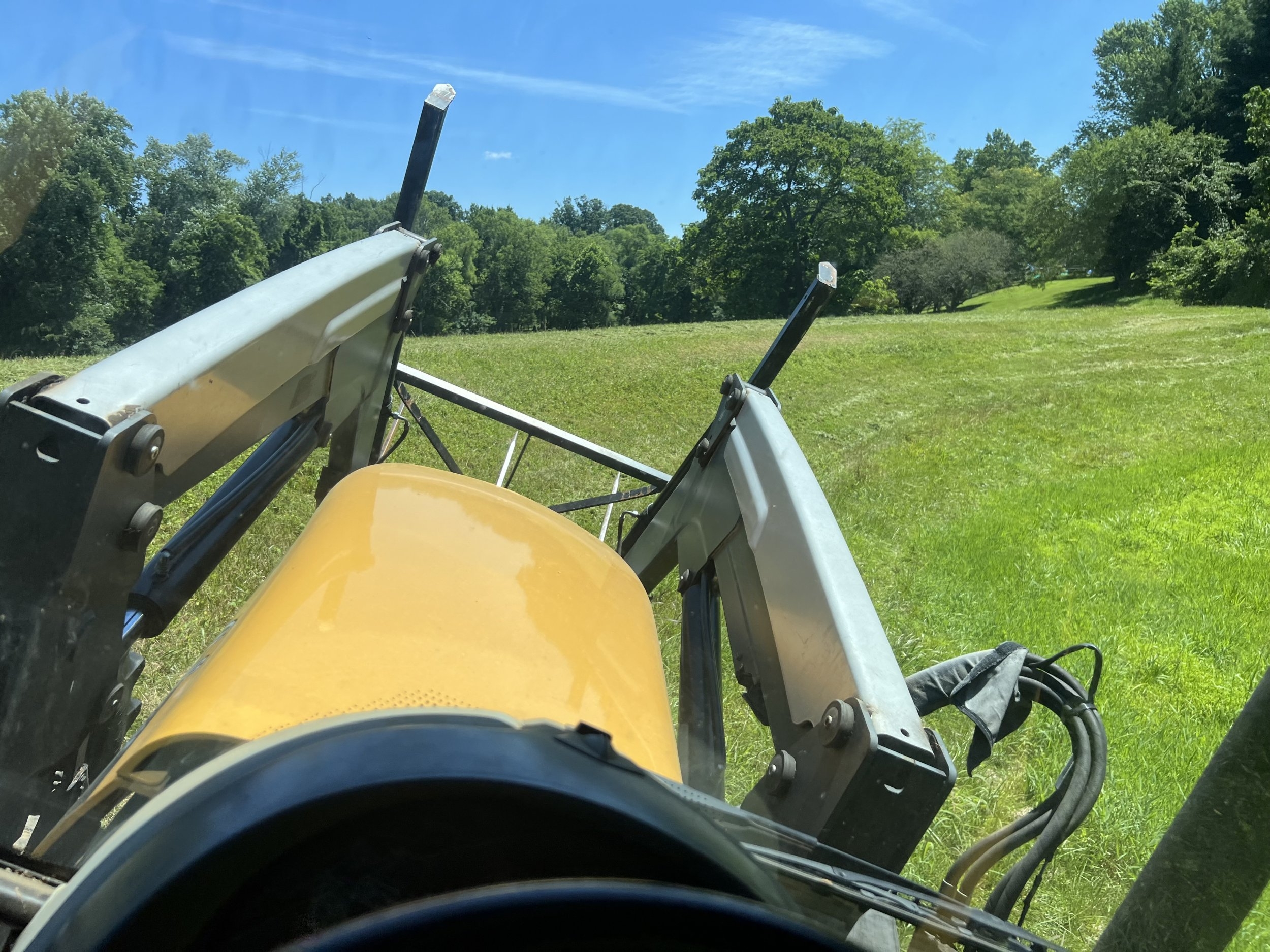

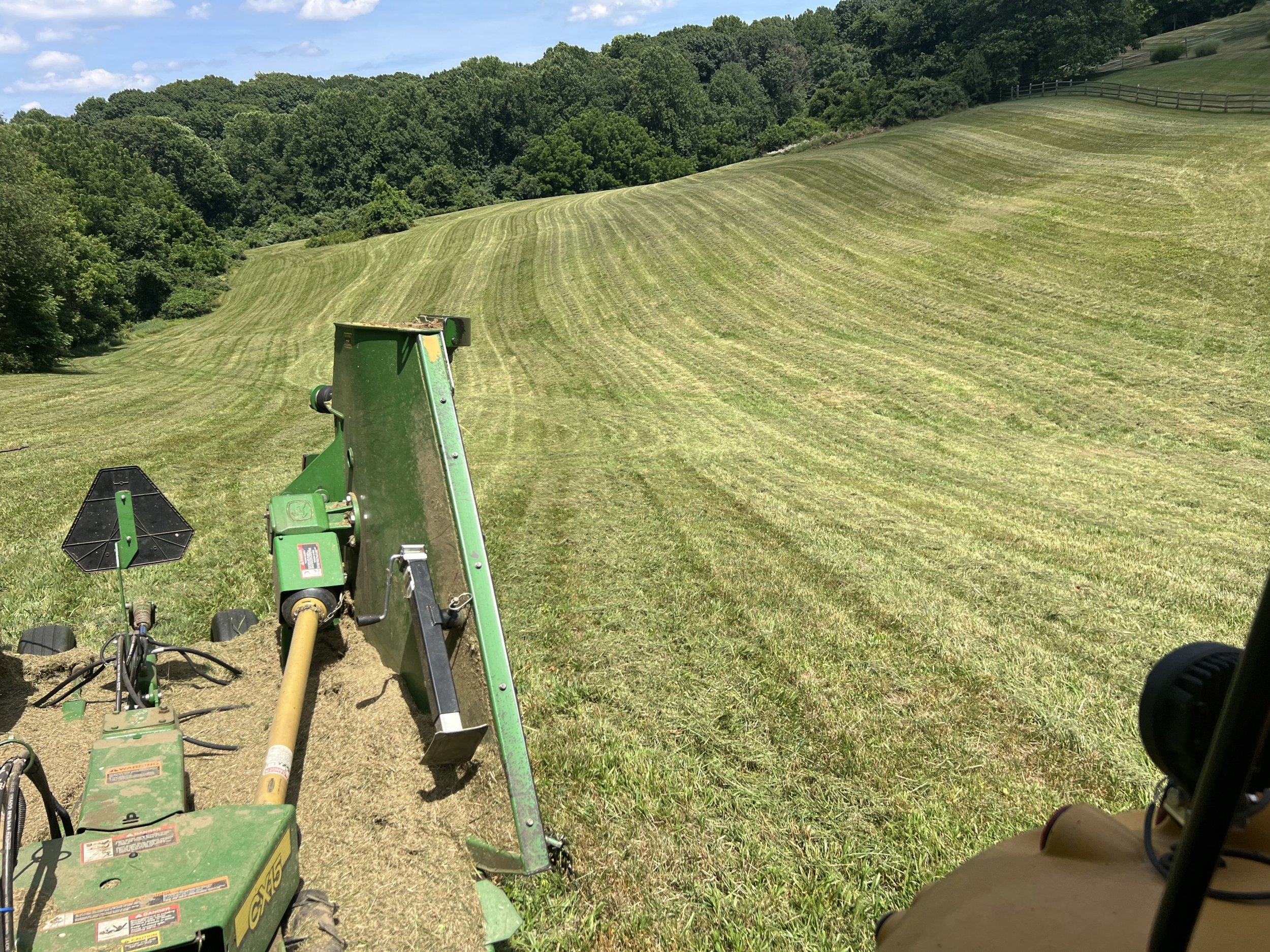

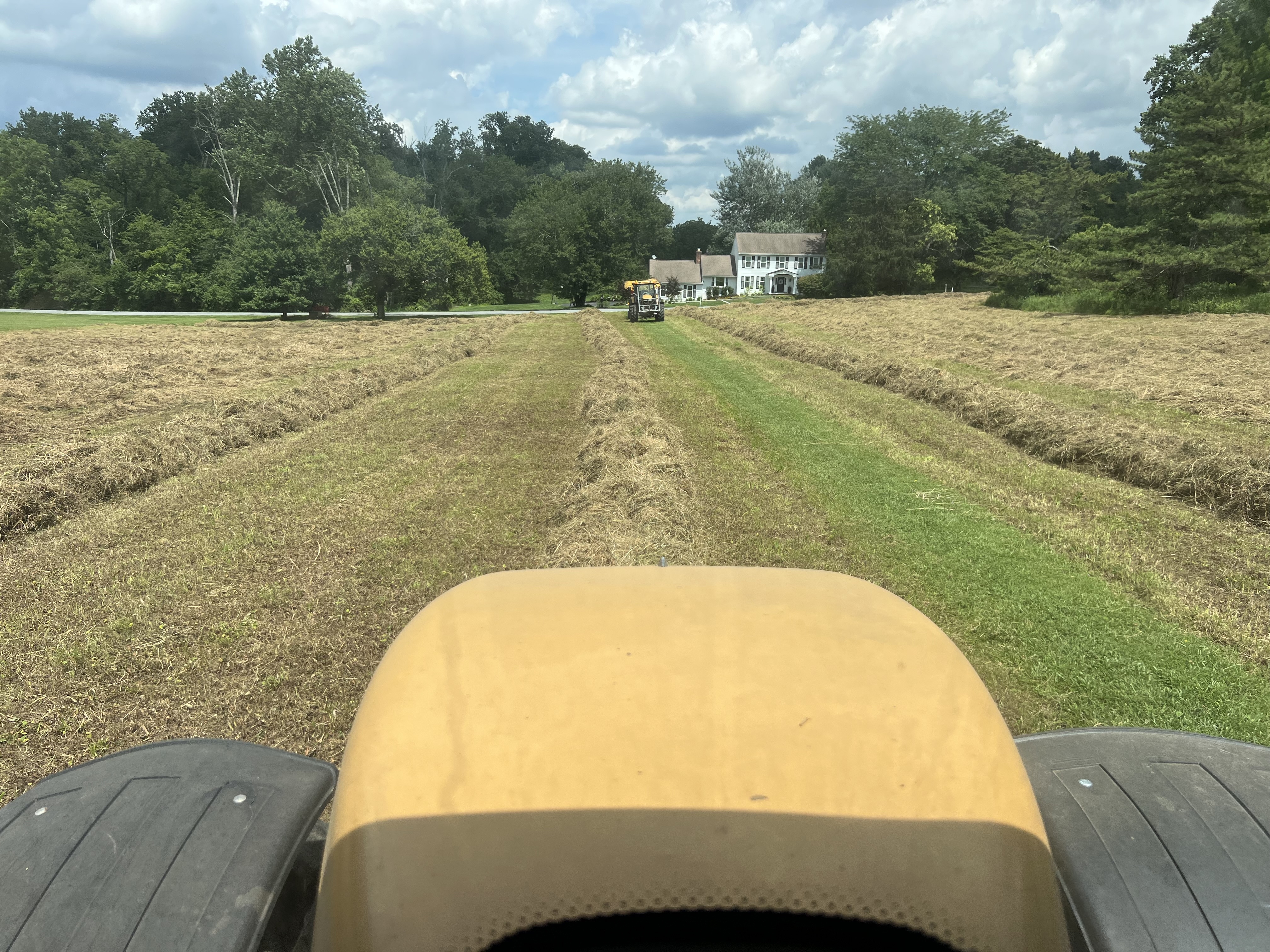

Today was just another day of the same threat of Thunderstorms. Sunny, then threatening black clouds. This has gone on for 3-4 weeks almost every day.
I have deployed a new raking/baling strategy……..only rake what you can bale in about 20 minutes. Here I am this afternoon in partly sunny, hot & humid weather baling only like 4 or 5 rows at a time, never knowing when the skies will open-up. Anyone who bales hay knows the misery of hay thats been raked and rained on.
This is a small HOA customer I do the hay, rotary-mow some other fields they don’t want baled, and clean up downed trees.
Same HOA. This fields hay was trashed with multiple days of rain.
Hoping for some improved weather, but it aint looking good.
I retired from custom baling in 2023. With the weather the way it is where I live I don't miss the misery very much of trying to bale dry hay! Depending on amount of rainfall on the hay I think the rained on crop shrinks IE looses bales per acre production in addition to changing crop color.

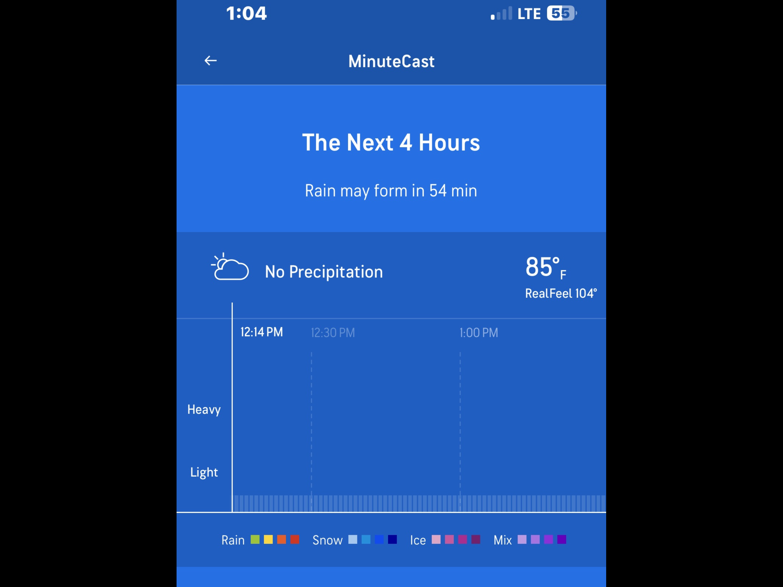

Man, you are sure having some temperamental weather!!
This is what our typical 10-day looks like over the last month or so.
Hard for me to figure out how you can even make any hay under those conditions! Any type of wet hay always caused mold and over-heat situations for us and we only made 2x4 small bales. Wishing you some stable weather.

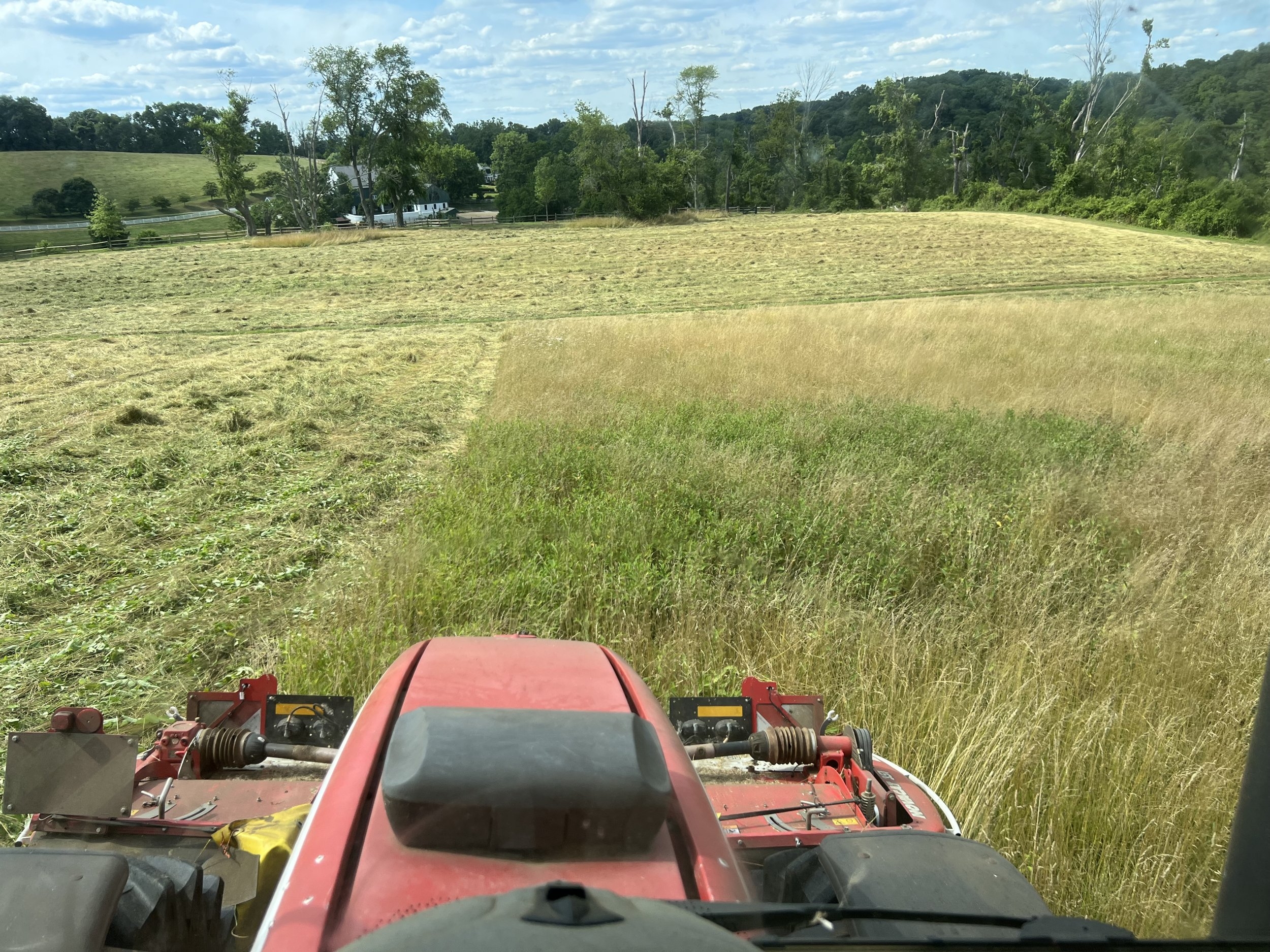

Over to another field I cut on Sunday afternoon for a little teddering.
Hoping to bale it tomorrow.
