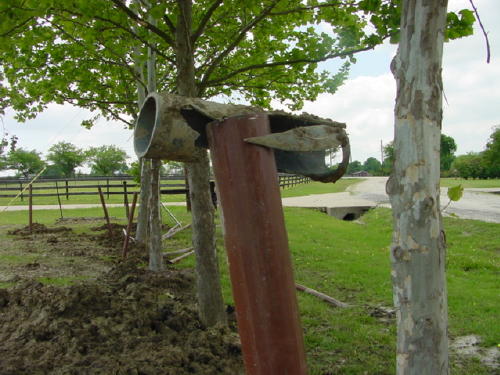

Note the shims and the strap while we "adjusted".

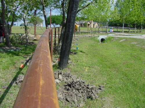

A view from the rear after it was bolted in place.

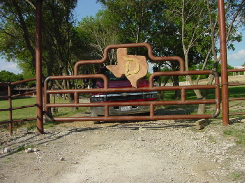

</font><font color="blue" class="small">( Something tells me that's adding up to be a pretty heavy gate. What are you using for hinges? Hate to see the longhorn state sagging over the years )</font>
The hinges are sealed roller bearing rated for two thousand pound gates. This one is probably twelve hundred or so.
The reason the gate is blocked up on the latch side is three days ago I cut a hole in the back of the hinge post about six feet off the ground. I filled the post up to that point with five thousand psi concrete. I vibrated it down and I'm not taking any chances of fracturing the concrete inside the post.
That's a little insurance in case six inch pipe decides to give a little over time.
If you've ever opened a large walk in freezer door or had reason to operate the door to a walk in safe you have an idea of the action and feel of these hinges and gate.
It's smooth. A half horse operator motor will handle it with ease.

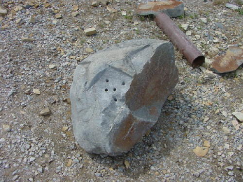

Here's a shot of the blue granite rock after our break up, it's separation. /forums/images/graemlins/smirk.gif

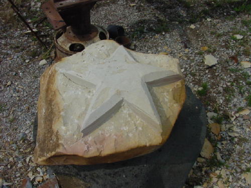

Here's the star stone almost done.

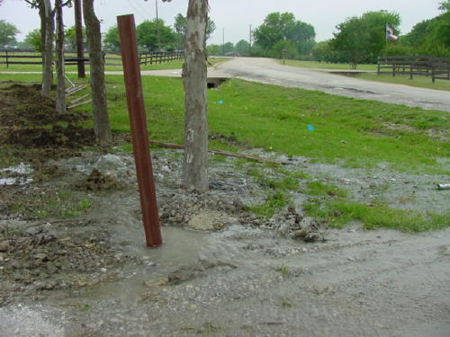

And I found the water main again! But this time these real nice young men /forums/images/graemlins/crazy.gif came out and did a good locate. I power dug the hole down two feet and then went down the rest of the way with hand diggers. I knew the bottom of the hole by the nice piece of pvc there. /forums/images/graemlins/grin.gif /forums/images/graemlins/grin.gif

The star rock is ready to be put in.

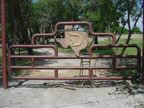

For those so interested, a view of the southend when northbound...... /forums/images/graemlins/grin.gif
