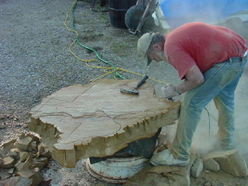

Son in law came by and took some pictures of yours truly at work.
Some of those who are considering such a project might find the following interesting. Wanting to see a finished project will mean skipping them.

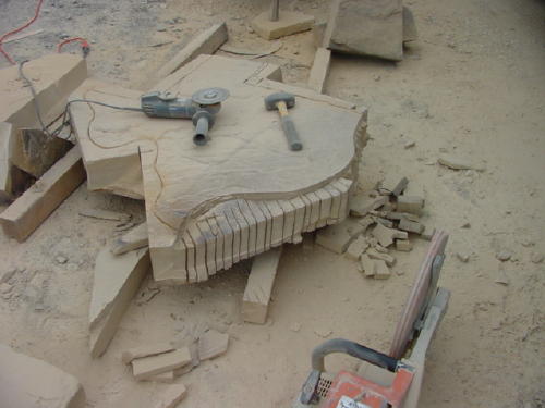

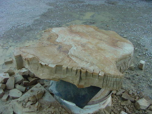

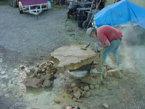

At this point in time I've already taken off most of the non state stuff with the Stihl 510.
I'm using a Bosch small angle grinder with a cut off blade.

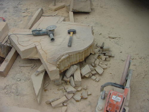

What I'm doing is cutting into my guide line with the angle grinder. Then I use the mason's hammer to break off the small pieces.
It's tedious.
It's hard on the back.
There's a lot of dust.
Here's what's sick. The doing it is more important right now than what it will be like in the end. I'll enjoy it when it's done. But each cut has it's own personality. Each stroke with the hammer causes a different affect. There are hard and soft spots in the stone. That makes it even more interesting.
Yes. I'm having fun.
No. I don't want to trade places with you.

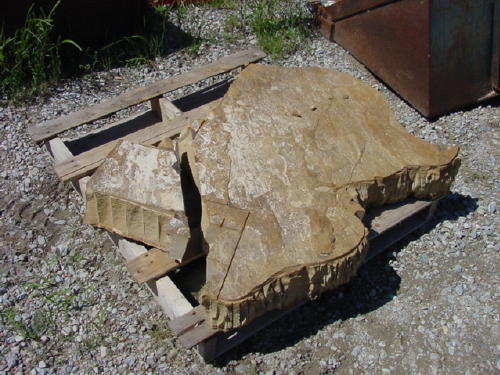

#116
A long day.
I also made the turning table to make it easier today.
Tomorrow we'll have the state of Texas in stone and maybe a "D" in the middle.

Harv, my back is hurting. Is'nt there some way to get that rock up to table height?
Sure looks like a good job though. I'm looking forward to those final pictures.
/ The gate
#119
Good morning Neal.
Actually some thought went into the table height. My big concern involved the Stihl chop saw. It isn't light. It does grab. And it doesn't cut all the way through with one pass, even with a fourteen inch blade.
This height allows me to use the Stihl comfortably. I get to use my hips, legs, and my back.
And even though it isn't visible it's good for the angle grinder. Cutting the rock isn't like grinding a weld. The blade wants to grab. One has to put pressure against the grinder as it cuts stone. This height again allows me to get stronger parts of the body involved.
