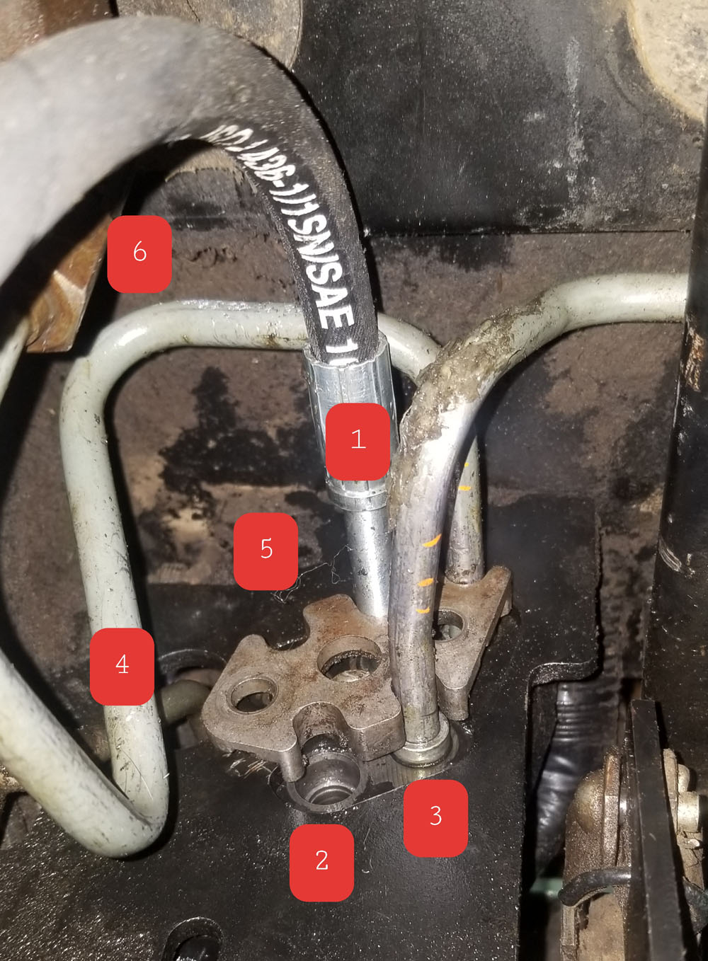

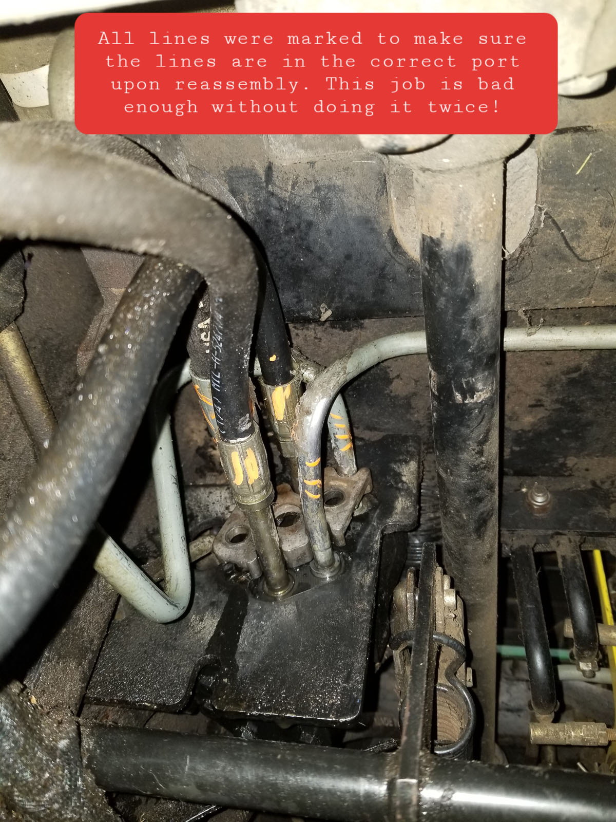

I have listed below which lines go into the respective ports of the steering valve assembly and where the other end of the lines connect to.
Remove the female swivel fitting at the tee, shown to the left of #6, second picture up. Next, at the valve assembly on the outside of the frame, loosen and remove the swivel fitting below #3. I had to remove the lines #1 and #2 to access #3. These steps require a 3/4" open end wrench and 13/16" thin jam nut open-end wrench and possibly a pipe wrench.

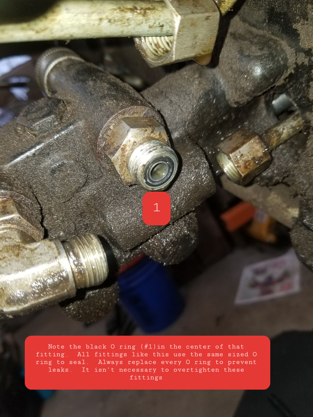

If any of the male fittings are removed or become loosened during the loosening of the swivel nut, the O ring(s) must be replaced to ensure a leak-free repair. There are two O rings on this fitting shown two pictures above. The O ring seen on the male adaptor fitting is part # R26448. The O ring in the center of the other side of the male adaptor in the second picture is part # T77613

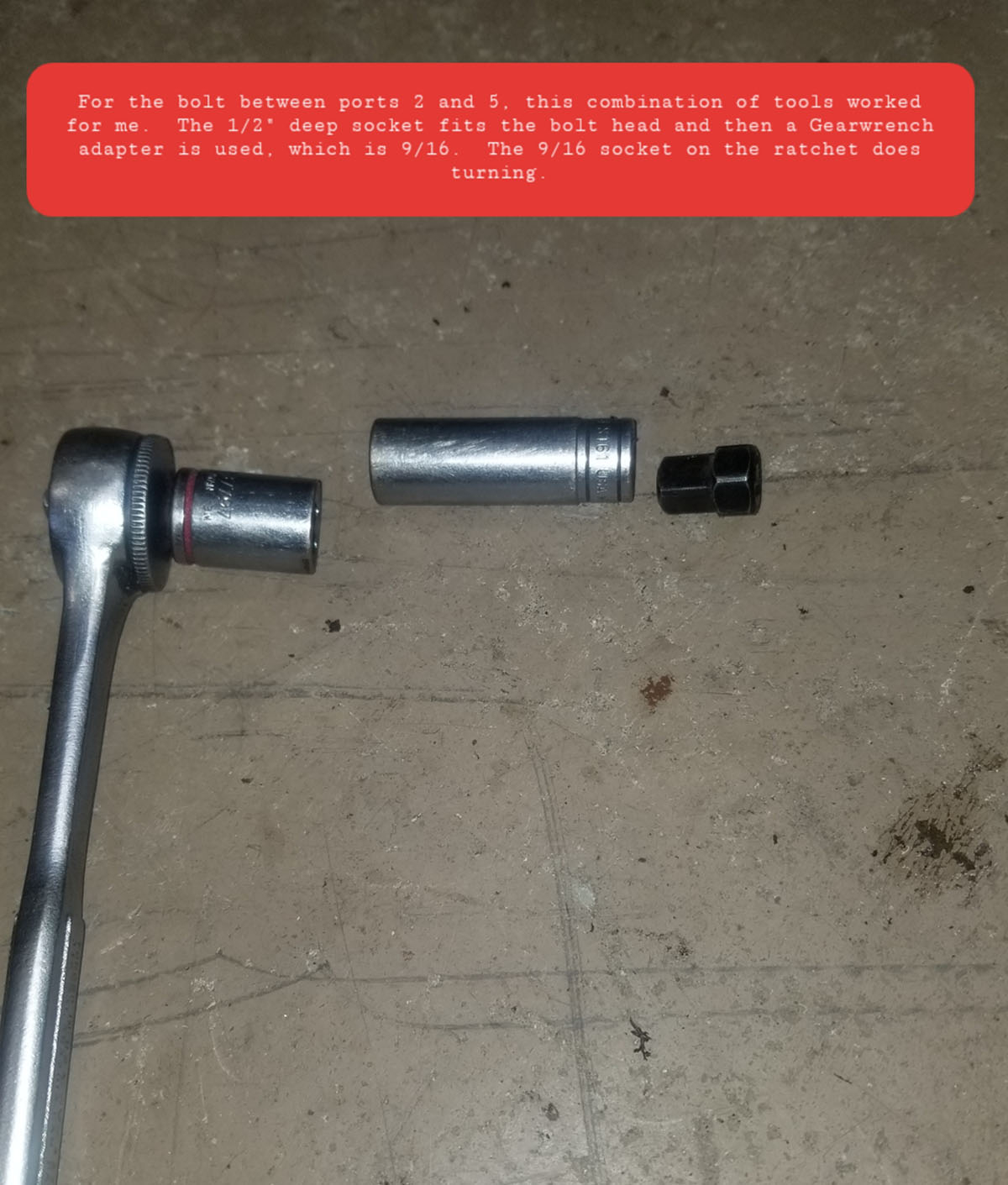

Alternately, the bolt can be removed with a flex extension and 1/2" deep socket.

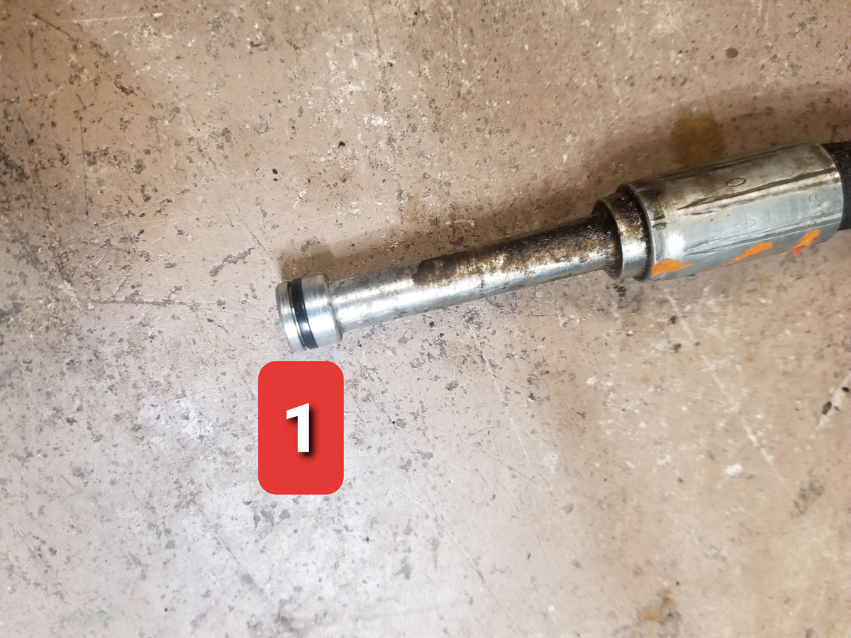

The five lines that plug into the steering valve assembly all use the O ring shown in this picture. The part number is T36492 and you will need 5. I would buy an extra or two in case you damage one while trying to install it. Always insert into the ports, well lubricated.

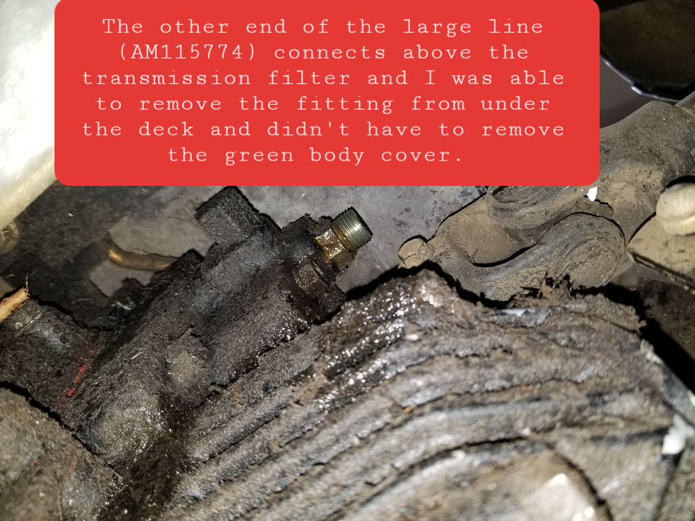

Next, I removed the female swivel nut of the large 3/8" line at the transmission, which can be done from underneath. There will be an O ring (part # T77613) to replace on the male adaptor where the hose connected to. Again, if the male fitting becomes loosened during the loosening of the swivel nut, the O ring(s) must be replaced to ensure a leak-free repair. (See above) This also applies to the power steering fittings.

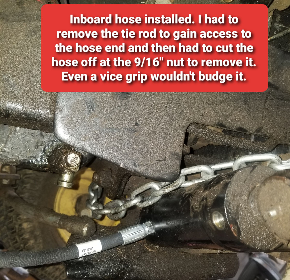

Then remove the fittings at the power steering cylinder. I wasn't able to unscrew the male fitting, inboard side, so I had to cut the line and use a socket on the hex fitting and this required removing the tie rod end of the right wheel, using a 7/8" open end wrench and a 3/4" deep socket.
The power steering outboard side at the wheel uses a 45 degree fitting. There is an O ring on each side of that fitting that must be replaced. The O ring part # for the male end that screws into the cylinder is R28728. The O ring that goes in the center of the opposite end of the 45 is Part # T77814.

All swivel fittings on the steel lines use a NEW O ring (part # T77613) in the center of the male side of the joint. See two pictures above, item #1. Install the lubricated O ring (T77613) into the male side of the T #6, (steering valve assembly underneath) where steel line #4 female swivel will be connected. Install the same O ring into the male fitting on the valve body side of the frame where the female swivels 1,2 and 3 will attach.
Port #1 is flex hose AM119164, which goes to the outboard side of the front power steering cylinder, closest to the right tire.
Port #2 is flex hose AM106911, which goes to the inboard side of the front power steering cylinder.
Port #3 is the pipe that goes through the frame to the valve body.
Port #4 is the pipe that connects to the tee to the left of #6
Port #5 is flex hose AM115774, which goes back to the fitting above the transmission oil filter.
See picture below, item #1
Install lubricated O ring (part # T36492) on to the end of the steel tube that is inserted into port #4. Insert steel line #4 into its port and seat it. The new O rings make inserting the lines into the ports a bit harder. I inserted the end far enough to get the O ring into the port and then lightly tapped on the fitting with a hammer and punch to fully seat it. The clamp plate will finish the seating when it is bolted down.
Put the clamp plate in place and with each of the remaining four lines, you will need to slightly raise the plate to insert the lines into their ports.
Install the lubricated O ring (T36492) on to the end of flex line (AM119164) and insert it into port #1 and seat it.
Install the lubricated O ring (T36492) on to the end of flex line (AM115774) and insert it into port #5 and seat it.
Install the lubricated O ring (T36492) on to the end of flex line (AM106911) and insert it into port #2 and seat it.
Install the lubricated O ring (T36492) on to the end of steel line #3 and insert it into port #3 and seat it.

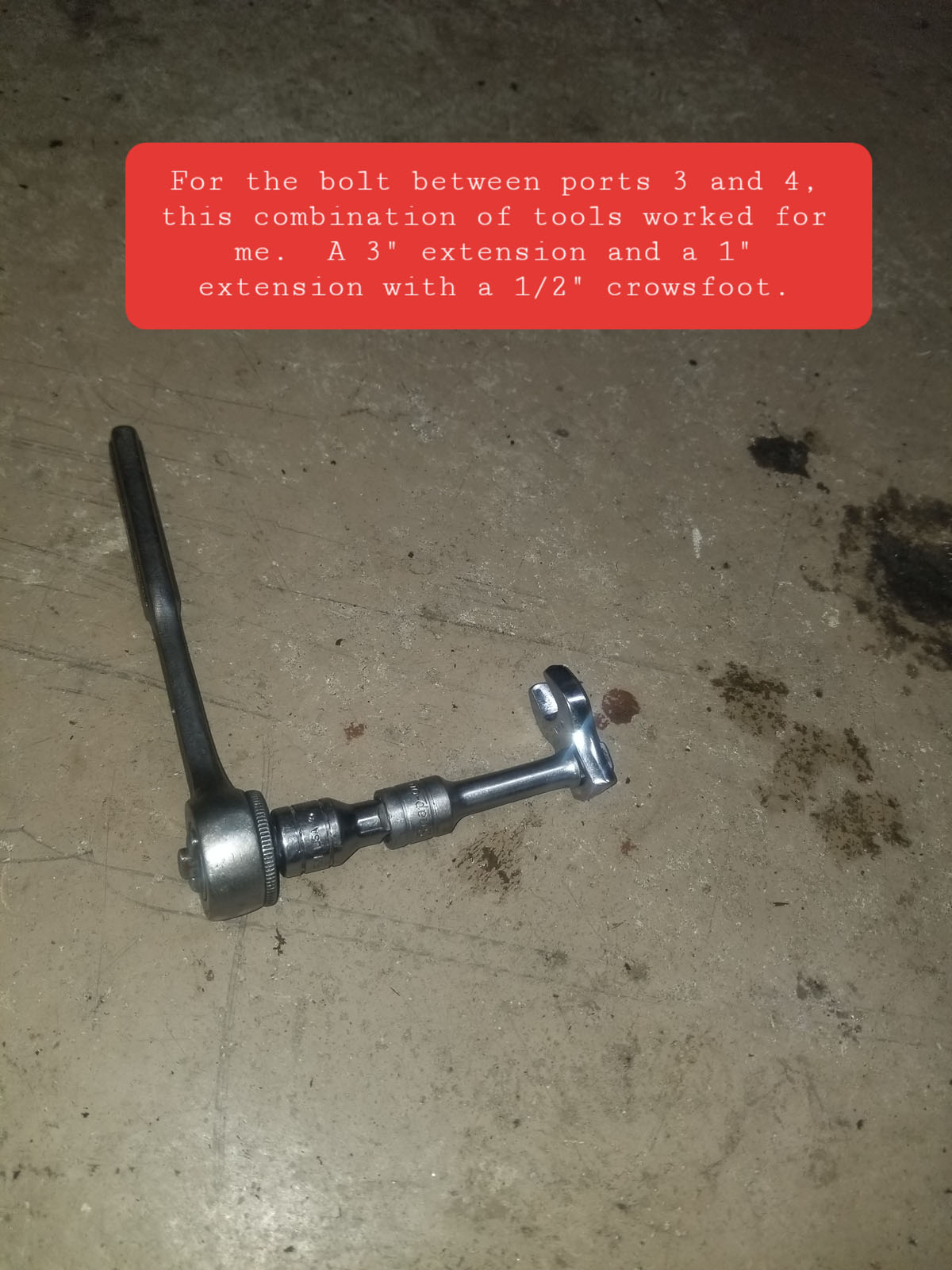

Install the two bolts into the clamp plate and turn them in by hand so that they make light contact with the clamp plate. Then attach the two female swivel fittings of steel lines #3 and #4 and tighten slightly.
Tightening the clamp bolts required different tools, so as not to round off the bolt head. The right bolt was tightened with a crows foot. The left side bolt used these tools, shown below.
Tighten the clamp plate bolts and torque to about 15 foot pounds. Then fully tighten the two female swivel joint fittings of steel lines #3 and #4.
