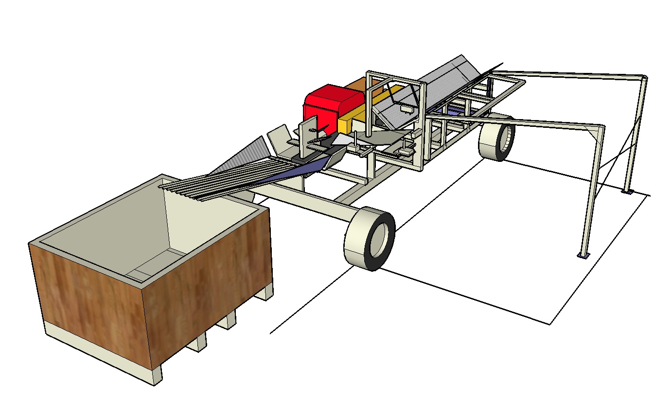

Was I ever WRONG. So, I made a nice Sketch-Up plan, not much detailed, I will wing it as I go along. And I did, I did measure, remeasure, cut, recut, weld, re weld, grind and regrind times and times again.

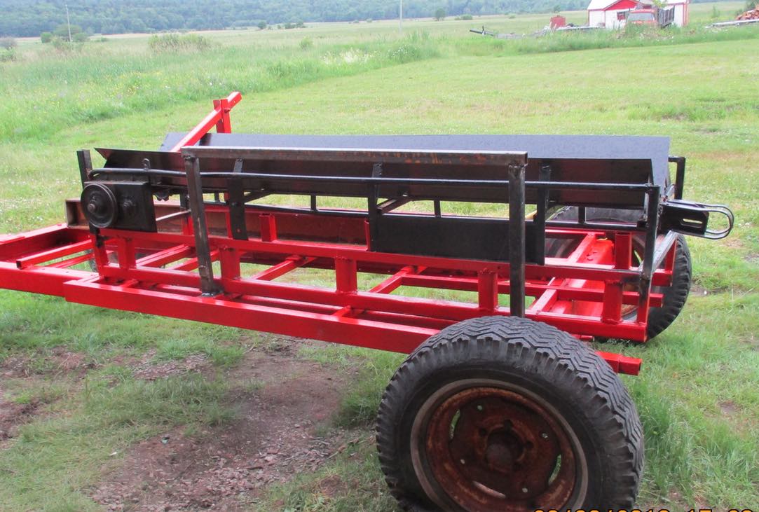

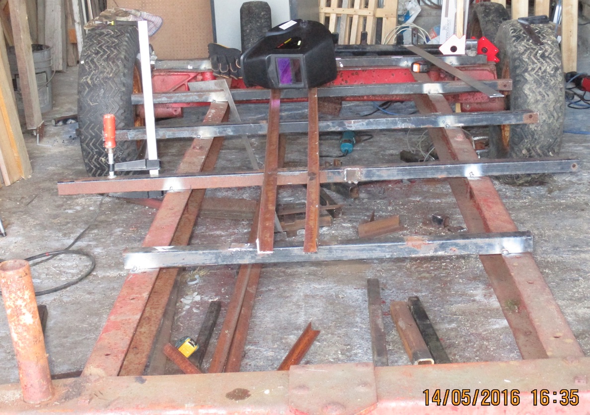

I used an old hay wagon that had to be reinforced and enlarged it to make it a 5 feet by 10' platform.

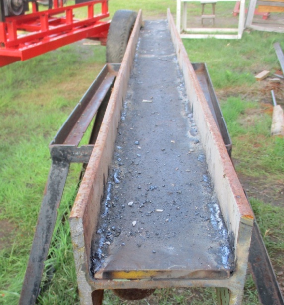

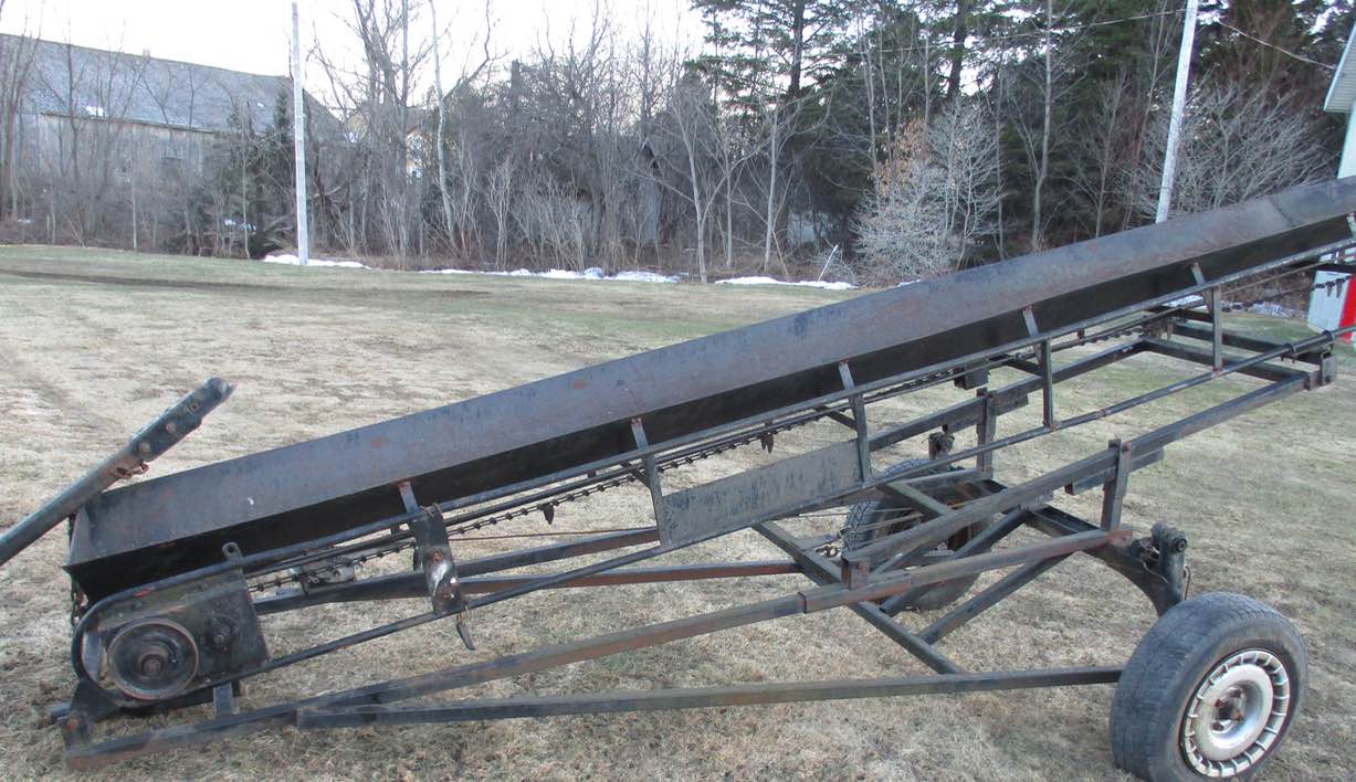

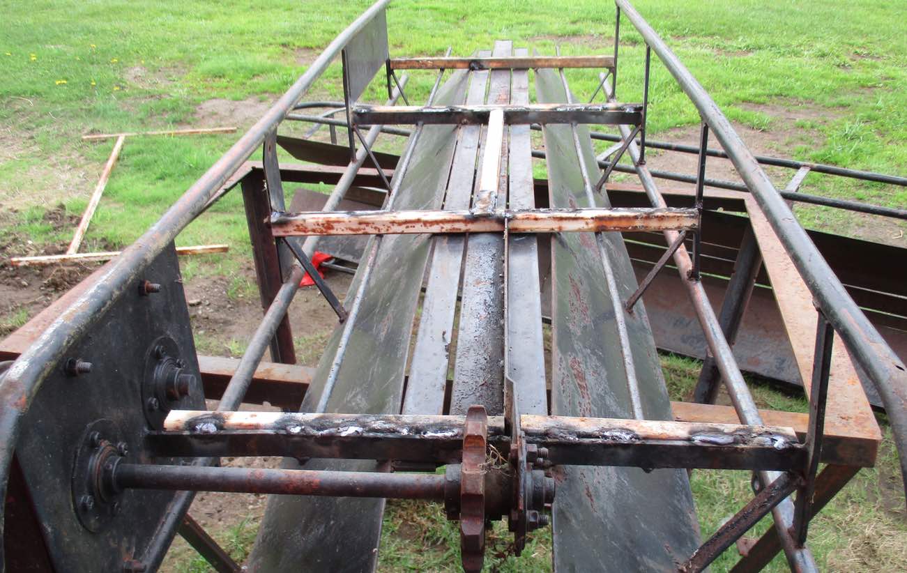

A 7 feet length of an old hay conveyor is cut, reinforced and, jacked up as a trough for my 8 logs, so the cut log will roll down to the splitter.

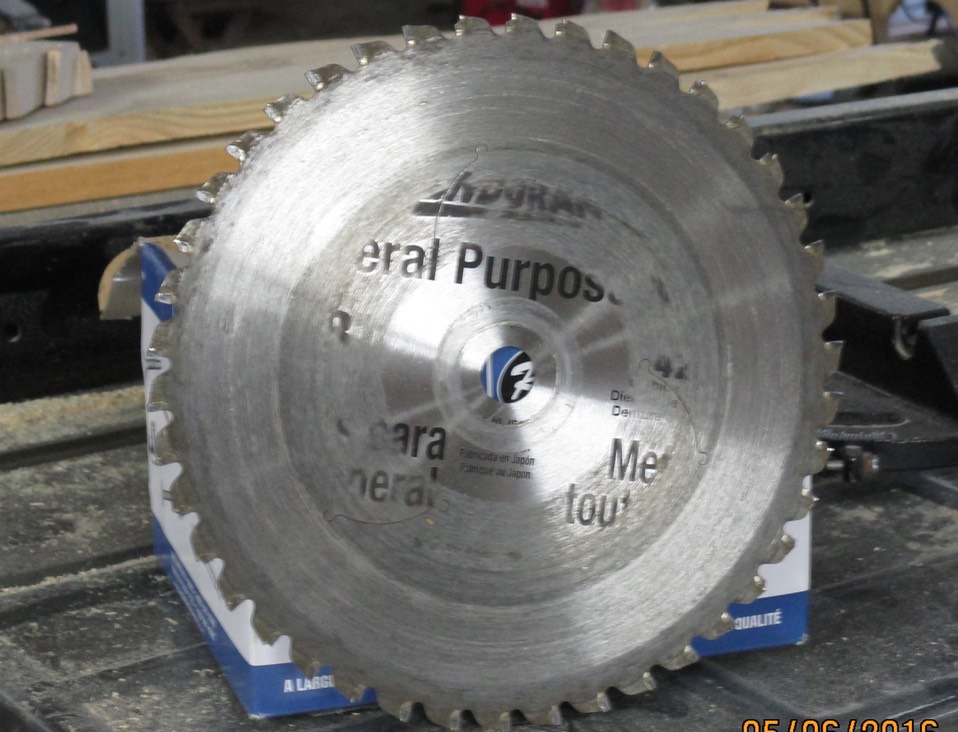

I bought a great metal saw with 8 inch long lasting blades. WRONG. The expensive blades makes super clean cut, but wont last if you cut 3/4 or 1 inch thick stock. I have 7 or 8 to prove that. I may try to resharpen some that still have enough teeth, next summer.

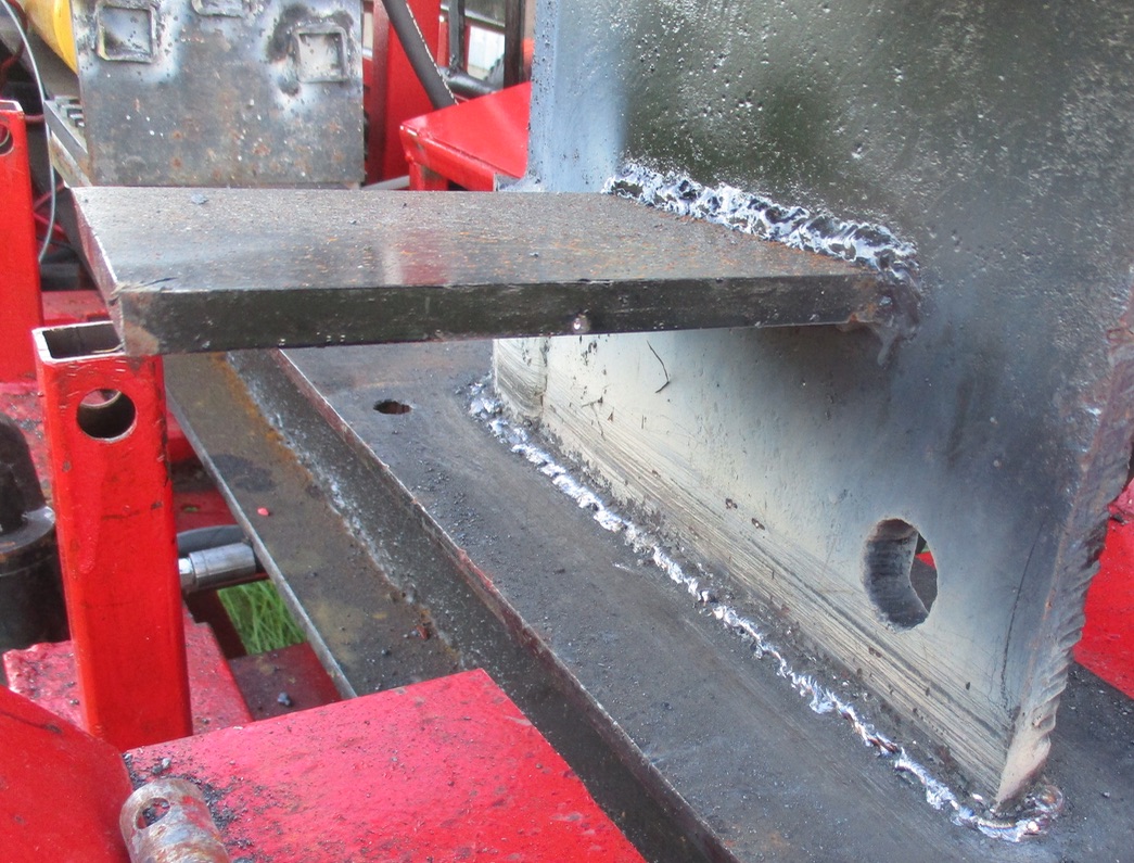

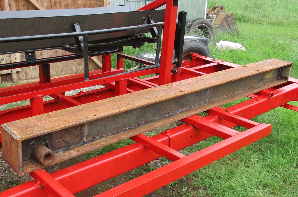

For 150.00$ I bought a 1/2 inch x 6X6 H beam. Scrap metal is expensive here at .60 a pound while new one is at 1$. I though it should be rigid enough. WRONG. With the centre only 3/8 thick, I was told it would bent. So, I welded a 1/2 inch plate on one side and a 1/4 inch on the other side. Now the vertical is 1 1/8 inch and should hold on well.
Once the H beam in place, I built a slanted table for the cut logs to roll down to the splitter, but a little higher and close to the beam. BAD IDEA. The split pieces can go wide and they did and unwelded that table as well as the posts holding the log lift.

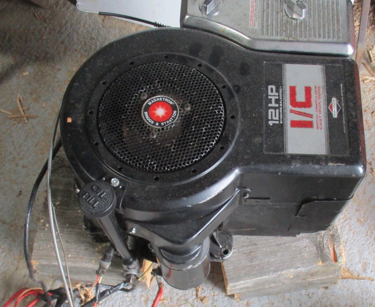

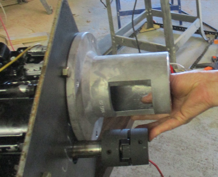

I bought a used 12hp lawn tractor motor thinking it would be easy to make it fit to the 16 gpm hydraulic pump. WRONG. First, the screws for the mounting bracket go in specific holes the are on dedicated motors, no on any or all motors. So a plate was bolted on the motor and holes were drilled to correspond to the bracket bolt holes. Second, the motor shaft needed to be 4 inches and now, because the plate shortened the available shaft to only 3 I had to weld a piece of 1 inch shaft, something I was not looking forward to do.

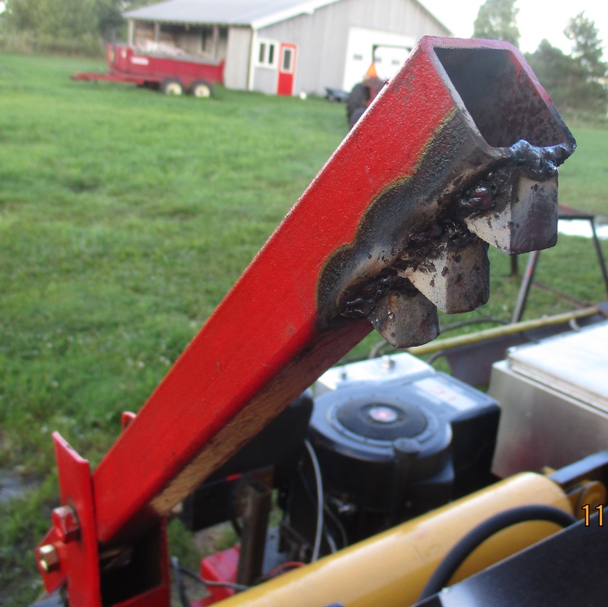

I decided to use a 3 1/2 inch cylinder to move the arm that keeps the log in place since it does not need to be that strong. WRONG. These small cylinders are stronger than I had anticipated. The pivot post unwelded after a few time holding log. I should have made my welds stronger since now it will be difficult to reweld and reinforce because the space is tight. However, scrap triangles, from my excavator thumb, welded on the arm work well to keep the logs in place.

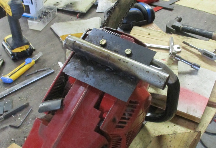

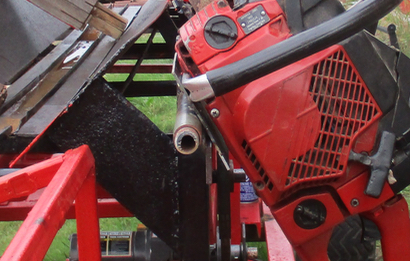

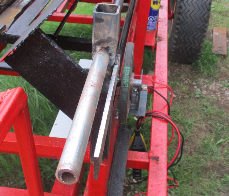

One part was easier than I expected. But it took a while to figure out how to attach the saw to the processor. It had to be easy to put on and to pull off. I decided to try with a piece of pipe, welded to the side of the trough. I was surprised it was holding on so well. I looked around and found another pipe the would tightly go over it. Fixed it to the saw, slipped it on and with a pin, locked it in position and it works perfectly. A couple of pieces of steel were added to prevent it from going too far forward or backward.

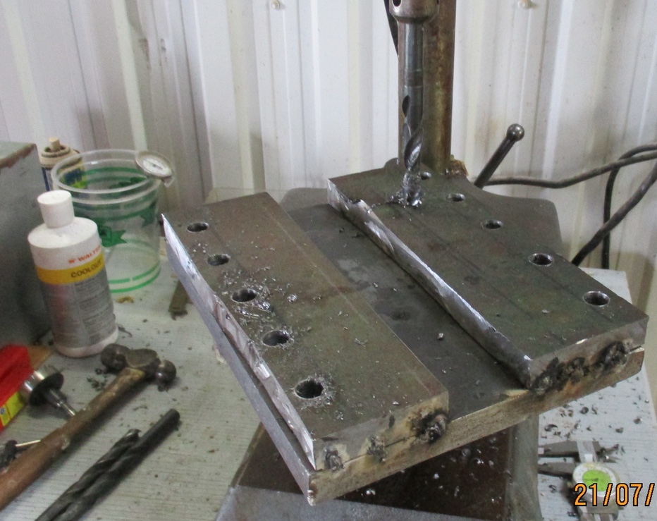

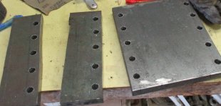

For years, I threw away my drill bits when they became dull. WRONG. This is not what a machinist does and one taught me how to resharp them on a bench grinder. My cheap bench drill press is ok for wood, but too fast for metal as it create heat. I manage by going slowly with the help of a new product to me, CUTTING OIL. This special oil made it easy on my bits and me since I had to drill a large number of holes for that project.

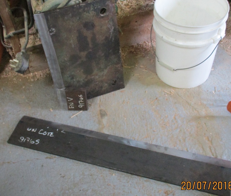

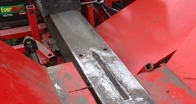

I thought grinding my wedges would be easy and fast. WRONG. Life is too short to grind 51 inches of steel to perfection, so I went to a milling shop. Not cheap though.

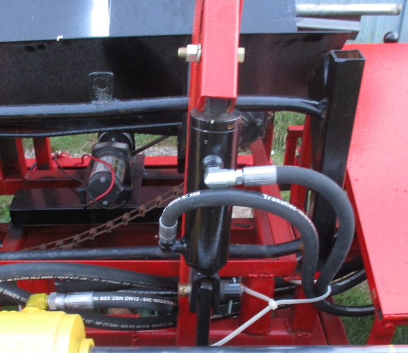

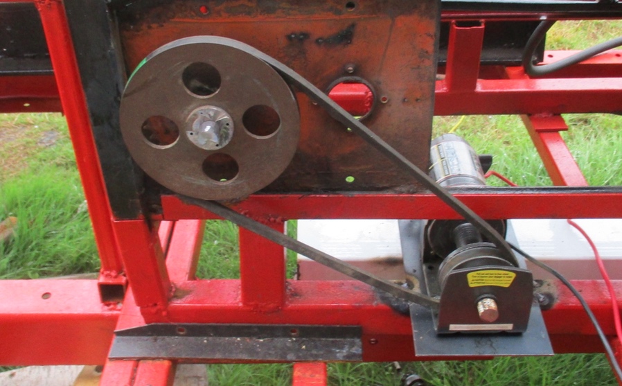

My plan was to use a DC winch to move the log forward to the saw. I was sceptical regarding the force it would take to do that with a log weighing hundreds of pounds. WRONG. The first time I used it, it pushed the log stopper and unweld it.

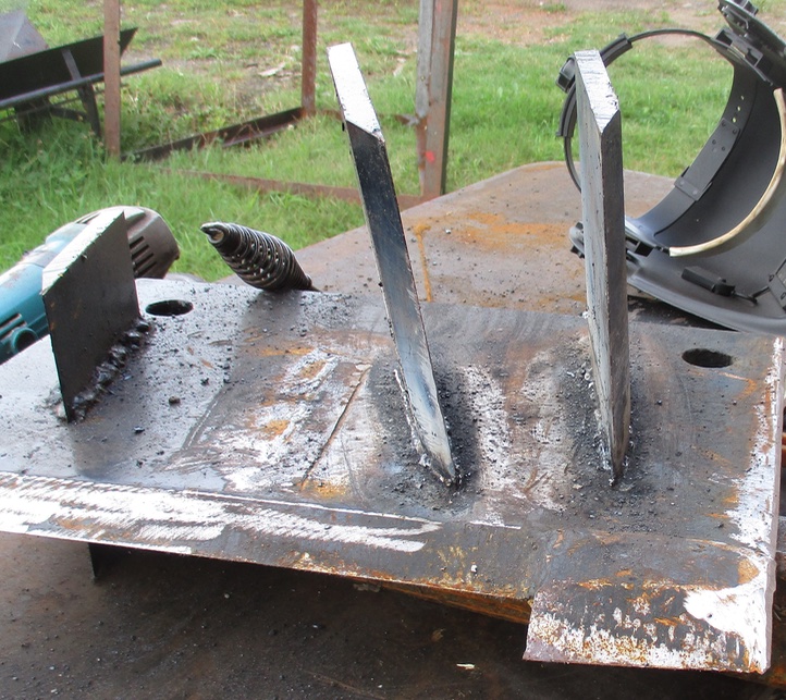

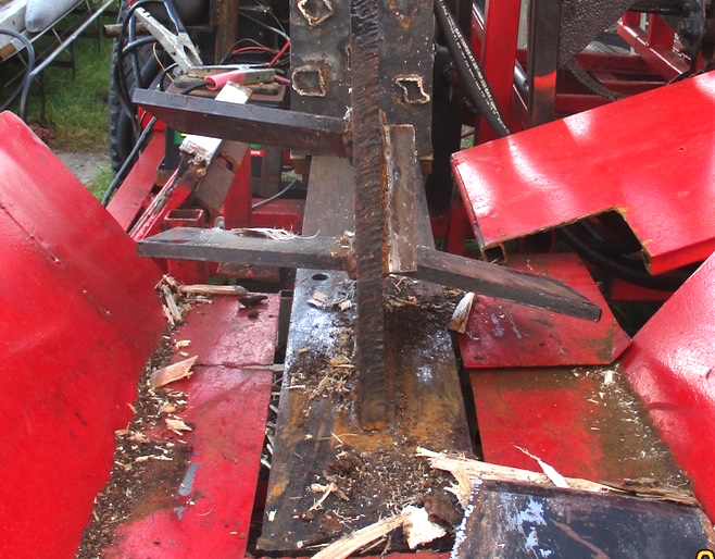

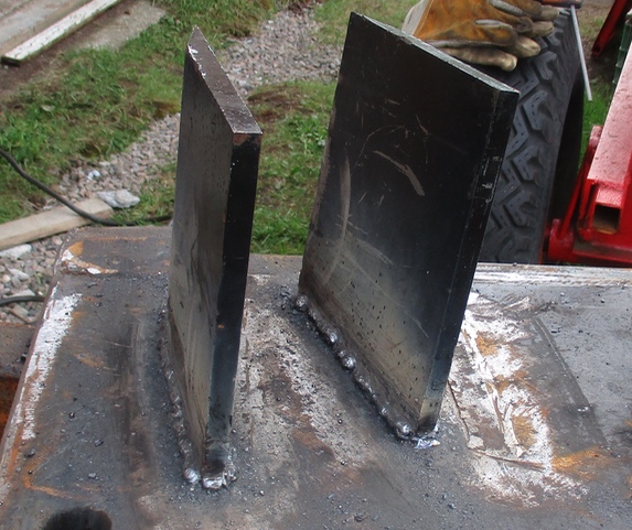

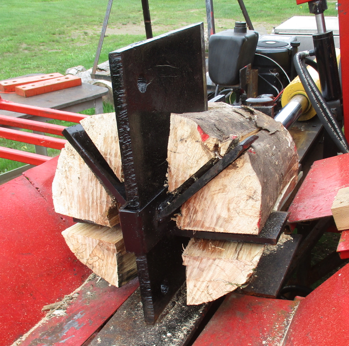

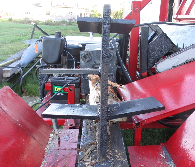

Now for the piece de resistance: THE WEDGES.
To me, this is the heart of my firewood processor to achieve my goal of cutting a log in 6 to 8 pieces, quickly and effortlessly.

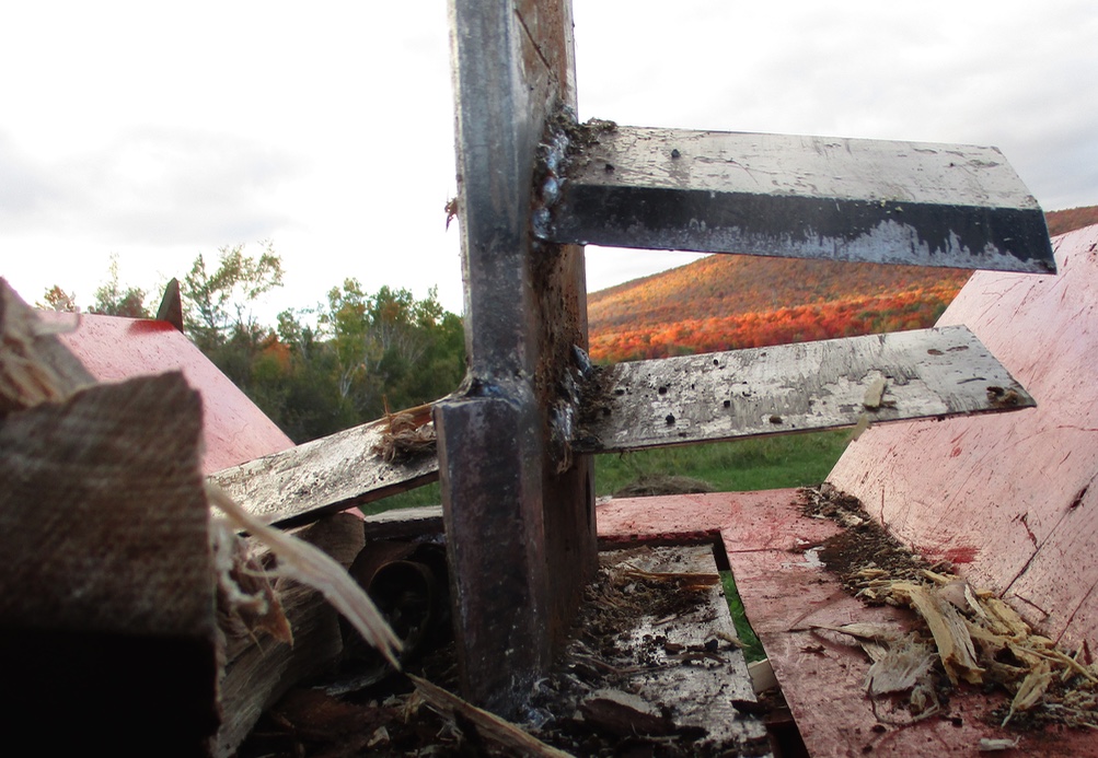

It could have been simple and easy. But one is not to shy away from experimentation and creativity ....at a price.
I found out, as expected, this was a time consuming and frustrated part. I had been advised it would not work. But I wanted to prove that it could be done. WRONG. This is a picture of my first set. It did not work for many reasons, some of them I now know. The angle of the knives were keeping the pieces of wood captive.First, I believe that if 2 of them are welded on the main wedge with a 4 inch distance, that distance should be higher at the tip to allow an easy escape. Secondly, the 2 small ones at the top cannot work properly because they are too short and mostly because the wood is going to be captive between this knife and the one below. Thirdly, the welds need to be stronger than the ones I did.

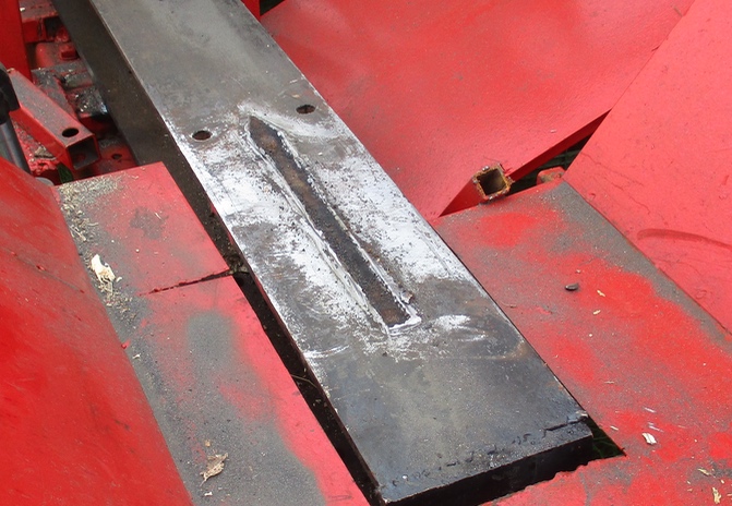

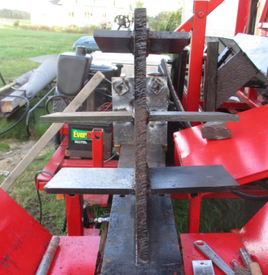

Believing the first set needed only some minor adjustments, I spent a whole day taking it apart and grinding all the welds. The next day, I put everything back on the beam and I was ready for phase 2. NOT GOOD. Soon one of the knife popped out, another one bent downward. One side was fairly intact. But I wanted to know more. So the next log was done slowly, taking pictures every couple of inches to see what was really going on. I was mostly intrigued by the middle part of the log, going in normally at first, like 4 inches and then, at the end, like one inch. Is it the fact that, unlike cheese that would follow the angle of the knives, a log cannot bend?

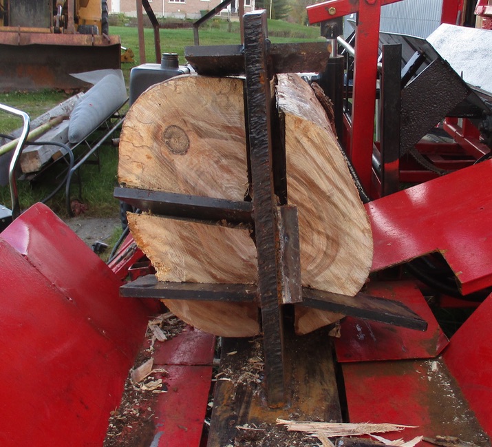

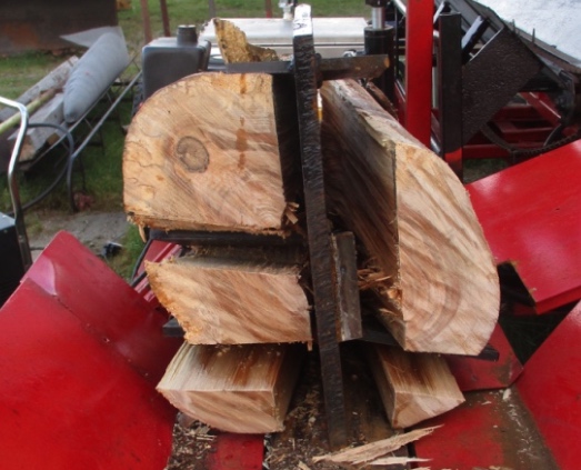

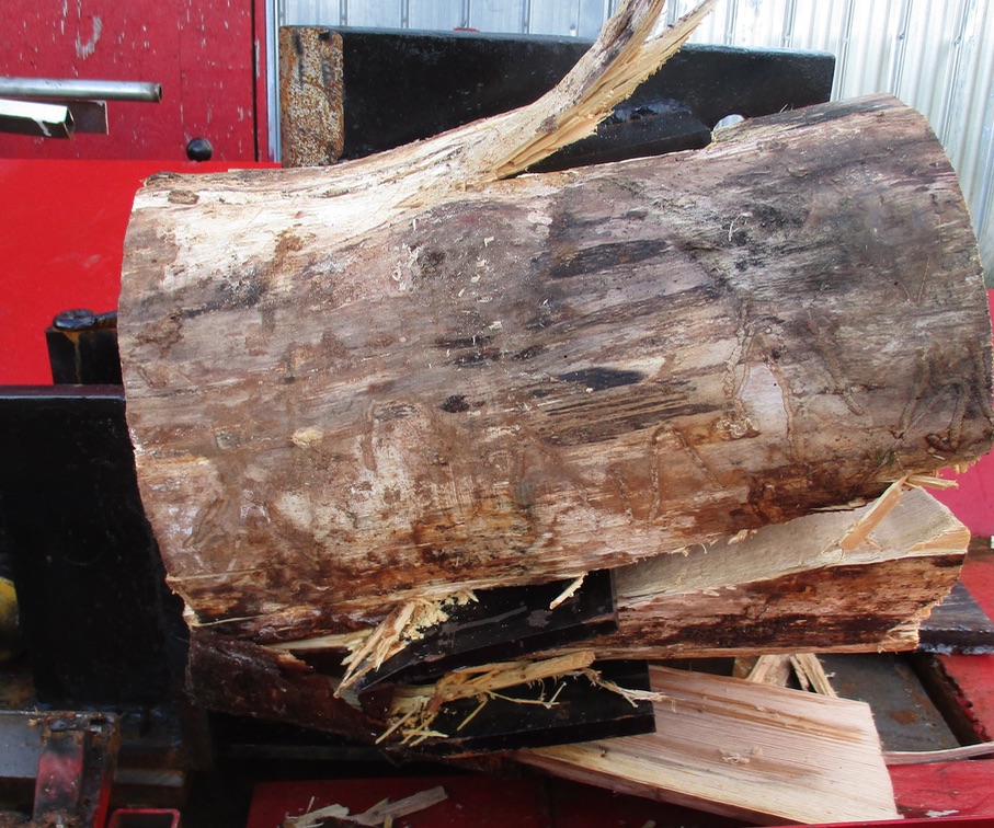

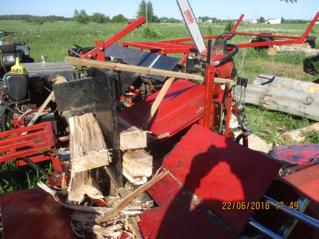

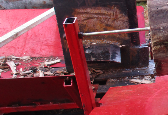

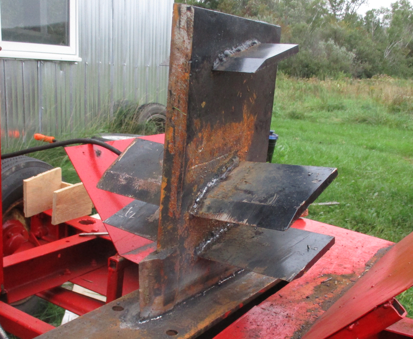

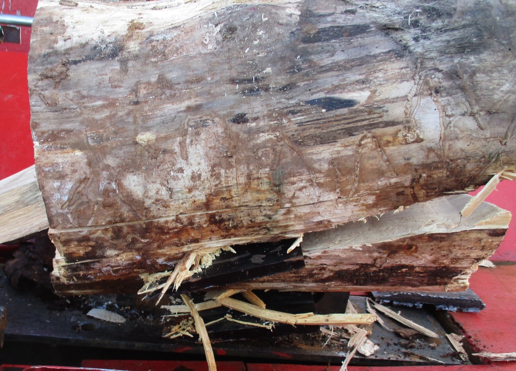

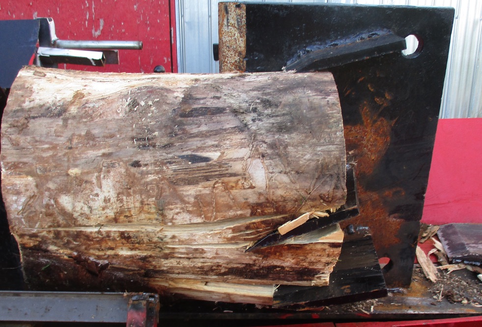

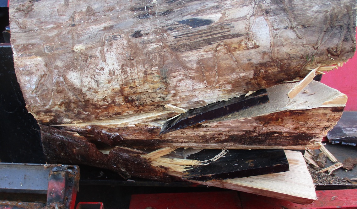

This is the moment I took many pictures while spitting a log. The log was advanced inch by inch to see the effect of the knives so that I could understand (still no sure) what was going on even with only one side working.
WEDGE 13.jpg WEDGE 14.jpg WEDGE 15.jpg WEDGE 16.jpgWEDGE 17.jpg WEDGE 18.jpg WEDGE 19.jpg
Since I did not have the proper answer, the third set of wedges was made simply with only 2 horizontals. GOOD.
Works like a charm. But with lots of resplitting. Not what I wanted in the first place. It was then late october, time to put everything inside till next spring.

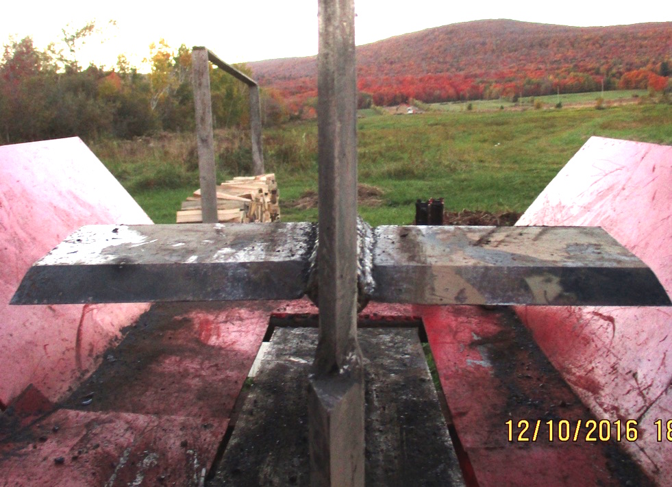

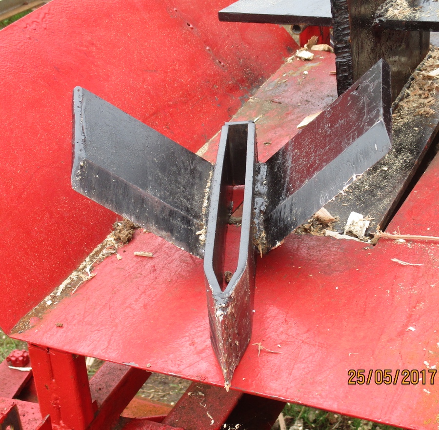

Now, early January, something else came to my mind. Why not make a floating wedge to slide on to the main one?
Will it work? I will know in May. So, a suivre,,,,,

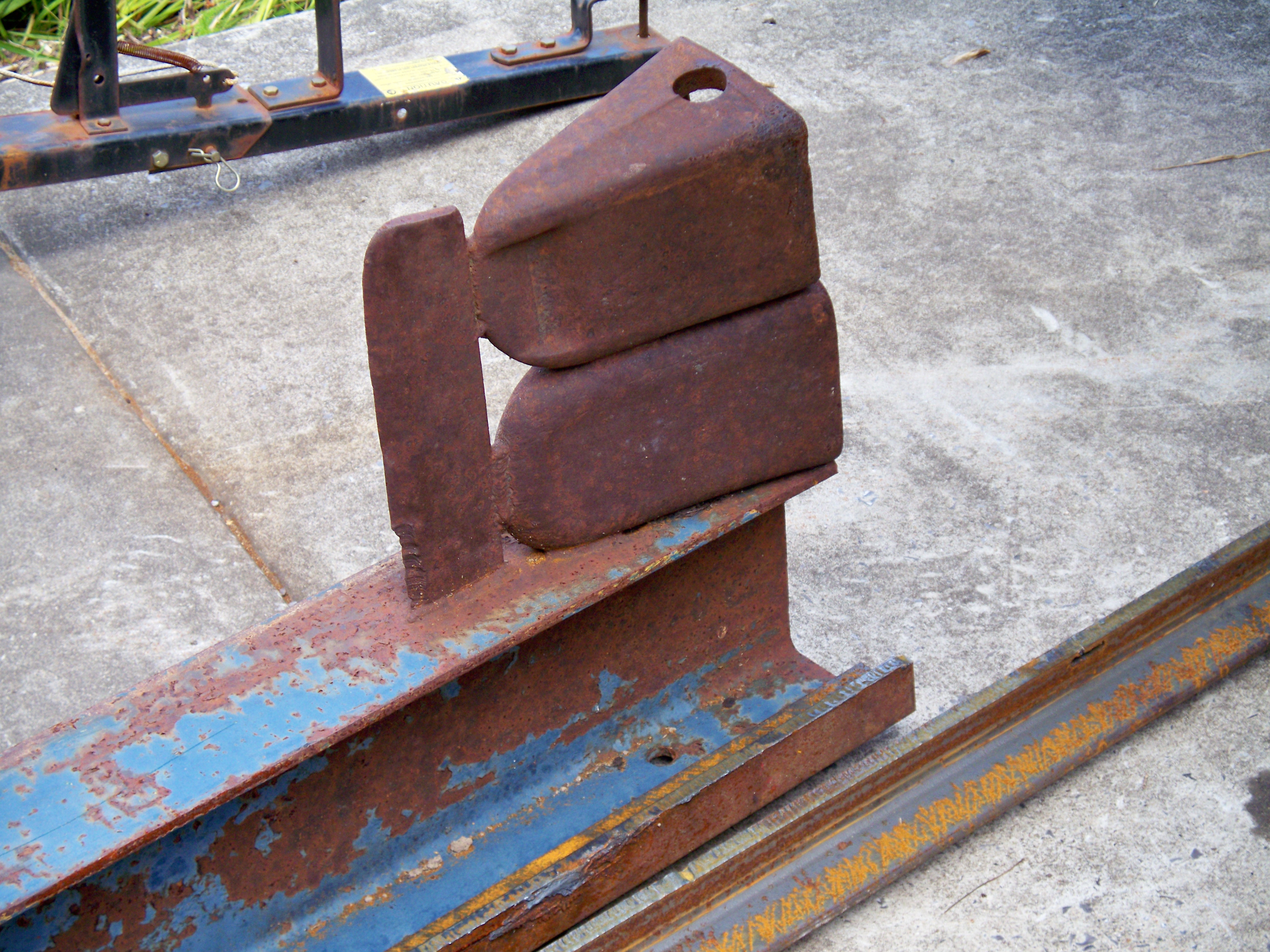

Here's a similar wedge as to what I plan on building when I build my splitter. image-1705111327.jpg I've built a wedge before and we shaped it with a cutting torch. The end result was nowhere near as nice as your bevels, but it was cheap.

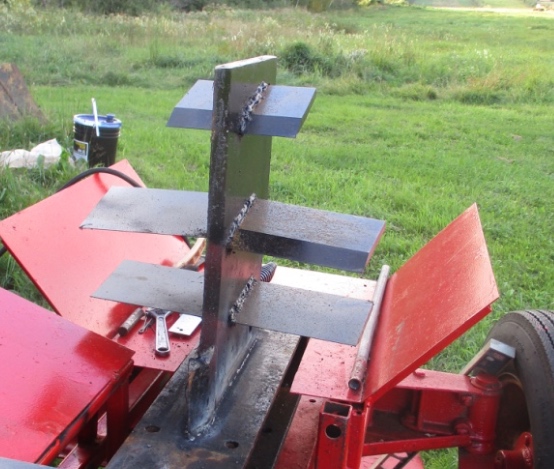

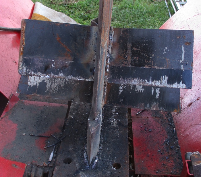

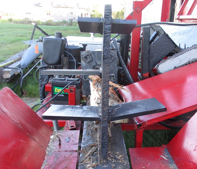

The first thing I did, working back on my processor, was to weld pieces of steel to make a slip-on wedge
so that I can split in 6 ways. I was a little apprehensive that this would work, having lost so much time trying
to make it work with fix wedges.
Well, so far so good. I have split a few logs and its working perfectly. I will know in the long run if
it stays solid. I have the material for about 15 face cords that I will cut and split in the next week. I hope it
will work well, but since its a new build, minor adjustments might be needed to the wedges and to the processor.
And for a while, I will stay away from hard to split pieces.

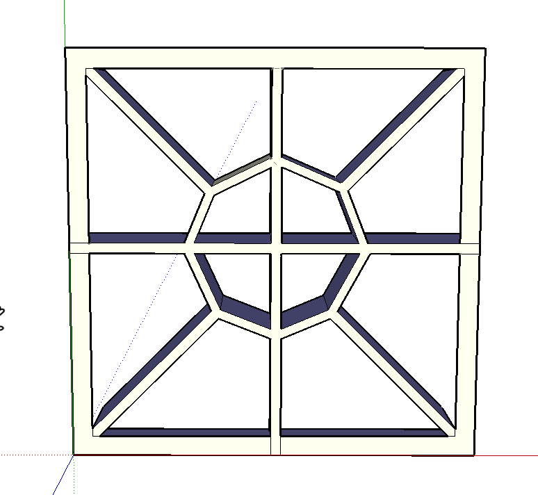

Your first 6way is very similar to what I have on my splitter,View attachment 511307.The difference is my whole wedge is height adjustable. I can leave the wedge lowered and use the top wings as a 4way, or raise it to use as a 6way. The wedge is raised and lowered with a hyd cyl using a lift arm. Since the wedge just sets on top of the armView attachment 511310. it can float up if a split gets wedged under it. I have found that even with a 6way wedge, I still have a lot of resplitting to do. Even if you manage to split a 24in dia round into 6 even splits, each of those splits is still 12 inches wide. Since I usually split a lot of large dia wood, I have built a 12way box wedgeView attachment 511311 I will be using on my processor if I ever get it finished
A wedge controlled by an hydraulic cylinder would have been ideal, but for me, I thought it was outside of my league. You're right, larger pieces need to be resplitted. But with my 6 ways, I'll keep resplitting to a minimum. Your 12 ways box wedge looks like a skillfully made monster worthy of a commercial processor. I wonder what kind of cylinder or cylinders you're gone use to push the wood through. Thanks for your comment.

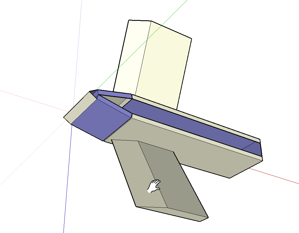

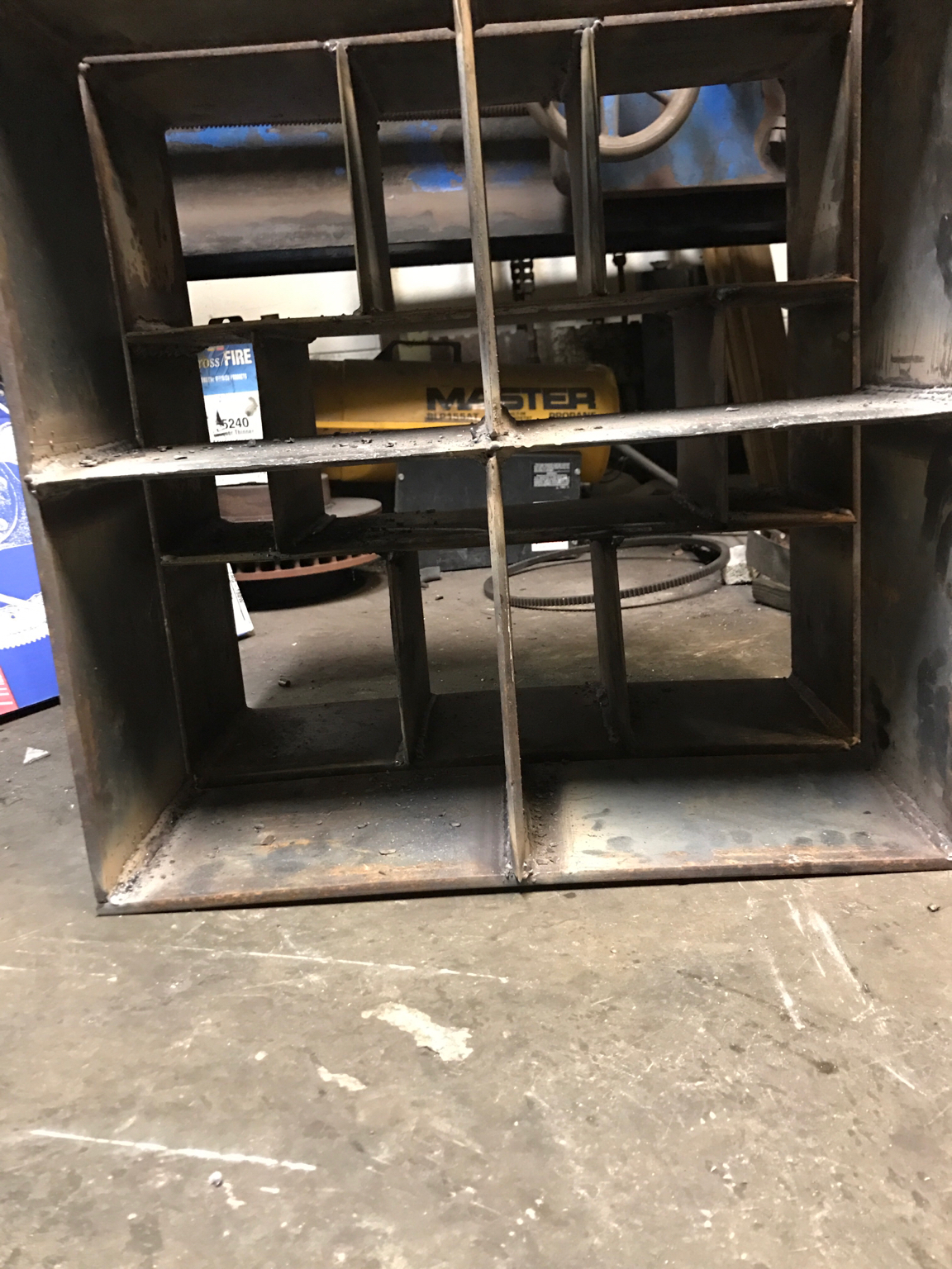

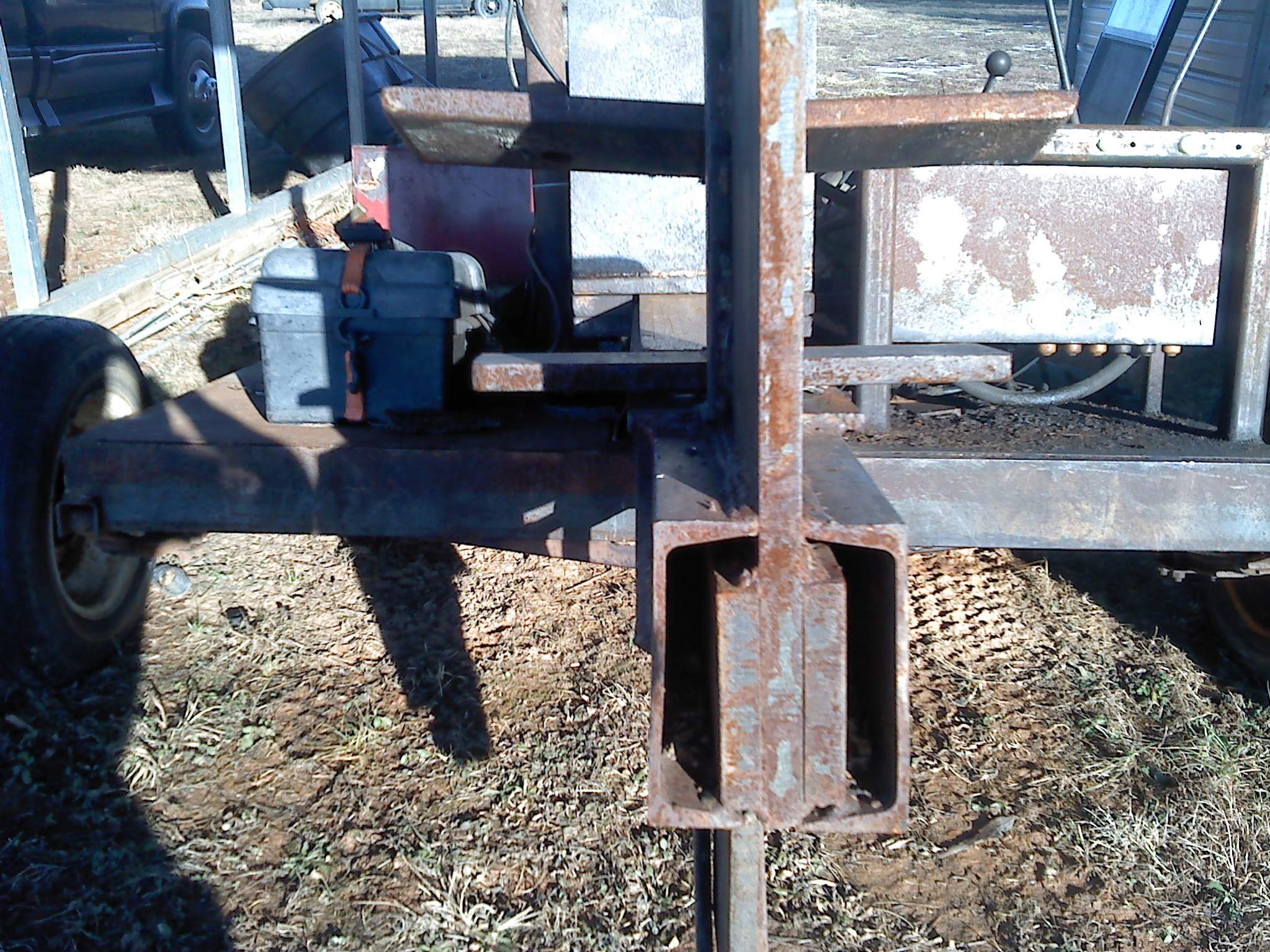

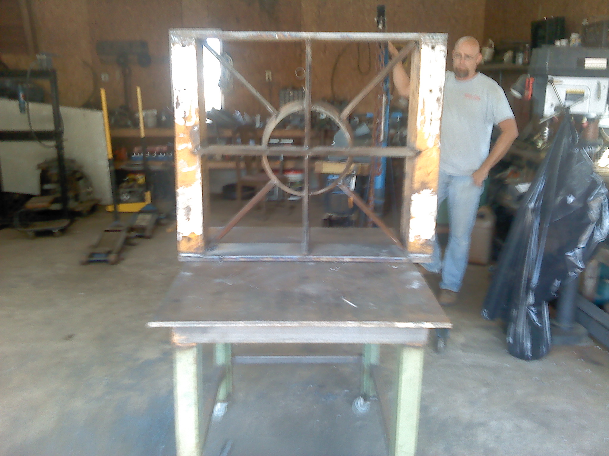

Have you tried your wedge? Here's a wedge I built but it's yet to be tried. IMG_9787.JPG
/ My firewood processor: a learning process. #13
Have you tried your wedge? Here's a wedge I built but it's yet to be tried. View attachment 511411
No, I havent finished my processor, between a torn rotator cuff and total knee replacement, I havent done much of anything for the last year. I bought the motor to pull the pumps with before Christmas, but I keep putting off any fabricating.
Hard to say how well your box wedge, or mine, will work. With enough tonnage pushing the wood it will be come, bleed or blister, Bust, split or break. The set back of your secondary wedges should help prevent some of the binding. I cant tell fro the pic if all the wedges are set back, or just the 4way. I designed my wedge with each split being set back behind the one before it. The first single wedge starts splitting 2 inches before the 4way, then 2 more inches back to the circle and another 2 inches back for the diagonal wedges. The circle wedge is also angled wider in the rear than it is in the front to allow the wood to spread while splitting. As for tonnage, I have 2-4.5inx2.5inx30in stroke cylinders.

I have 2 separate boxes that makeup my wedge. I'm pushing with a 5.25" cylinder.

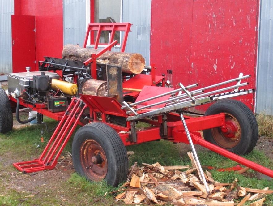

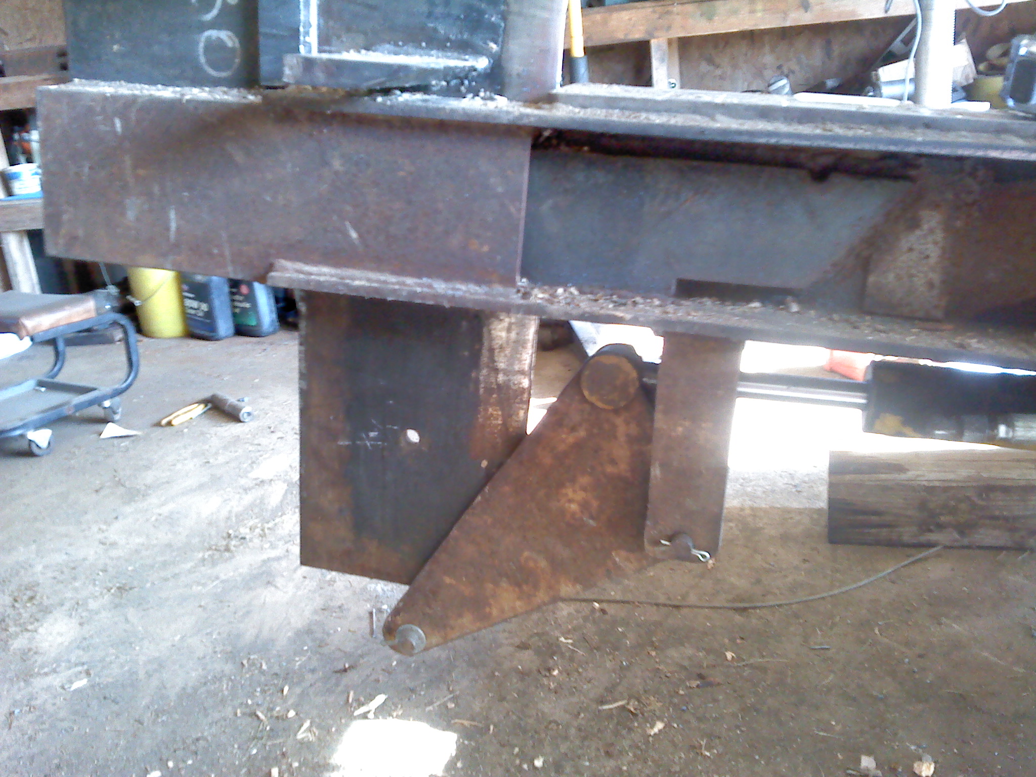

After splitting dozens of face cords of firewood, I can say I learned a lot about fabricating and
using my processor. Is it up to my expectations? Not completely. It still is lots of work but
not hard as expected. Very few things have changed from my original design. The most
important one being replacing the deck with lifting arms. It was supposed to be used by
two people. Unfortunately I had to work it by myself most of the time. So, after cutting and splitting
3 or 4 logs, I have to move on the other side for resplitting the large pieces. Being too far from the splitting valve,
I use a stick to make it work. Not what I had envisioned. Can I change it so that it can split logs
up to 16 inches in one go with all parts the size I want? I could, but that would need a complete overhaul
of the processor. This one does a decent job, but not the one I want. So, I am going to let it as is, and go for
a new one. I learned a lot in working on this processor and I hope to learn more on the next one. Now I know
the end result I want and it can only be achieved with a box wedge. What is needed to make a 20x20 inches box
work efficiently? Motor, hydraulics etc... Well, that is my next thread.
