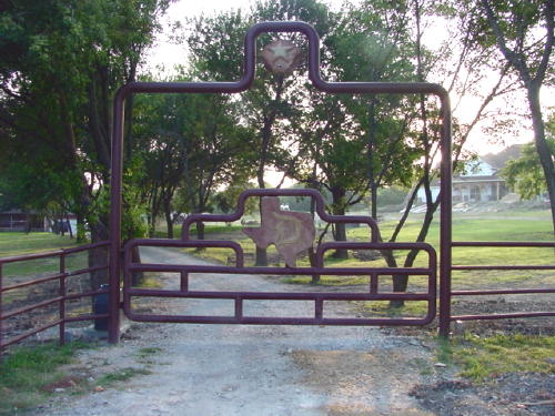

Here's the finishing touch on the job.

That was the only carving done with a sandblaster.
It's really quite simple to do. First you freehand out your desired inscription on a sheet of aluminum. Then you cut it out with the plasma torch. That is the template which is clamped to the stone of choice.
Blast it.
Remove aluminum template.
Drill two holes in backside of the stone and epoxy in studs. The studs are welded to the pipe fence.
This job is done.
It seems like it's lasted forever.
The highs for me were many. You see I get high on challeges.
It's a good one. There will be another visit to finish out all the trick stuff on the gate when the new home is complete. Right now I've got the power temporaried and the gates open and close only with transmitters and the keypad. But in a couple of months we'll feed it from the new cabinet with all the computer controls and video feed.
So until then this will be the last picture.
Bet you're glad for that. /forums/images/graemlins/crazy.gif

<font color="blue">Bet you're glad for that.
</font> Nope. Always happy to watch a pro do what they do best /forums/images/graemlins/grin.gif especially when they're teaching me the little tricks along the way. Thanks, Dale

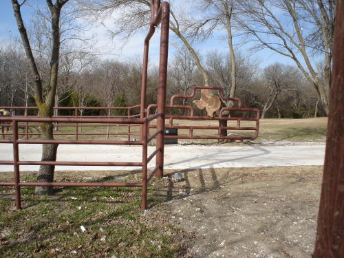

Here's where the star used to hang.

What really hurts is this was open and it's only about fifty to sixty feet away from the rock gate.
About fifteen of sixteen drivers didn't have a problem with getting their concrete trucks to the pour.

Harv, that really hurts to look at. After being there and seeing what a great job you did, it makes me a little nauseous to see the damage. /forums/images/graemlins/tongue.gif What's the prognosis on repair? ...start at the ground and work up? /forums/images/graemlins/frown.gif

I've given an estimate to the adjuster. And they've agreed to my guesstimate on what it's going to take to make it back like it was.
First the star stone is a total. And new stone has to be found, carved, plumbed, and rehung. Due to new law this month I'm not allowed to hook up the camera so that will be done by another vendor.
I will remove the gate and hinges from the hinge post. I will remove the overhead at the sweeps. I will prepare the posts for pulling. This will involve welding a strap suitable for a thirty five ton truck crane's lifting ability.
Once the old posts are gone. Then I will install new posts, reattach the overhead, rehang gate, install new star stone, and then paint the whole structure two coats of paint.
If everything goes according to plan they will get by with spending something over nine thousand dollars. If it doesn't go according to plan, concrete driveway gets broken by pulling hinge post or a fifty ton crane is required etc. It could easily exceed ten thousand for the repair.
The insurance adjuster's first words to me was "when I saw that gate I said a prayer of thanks that he didn't hit that too."
