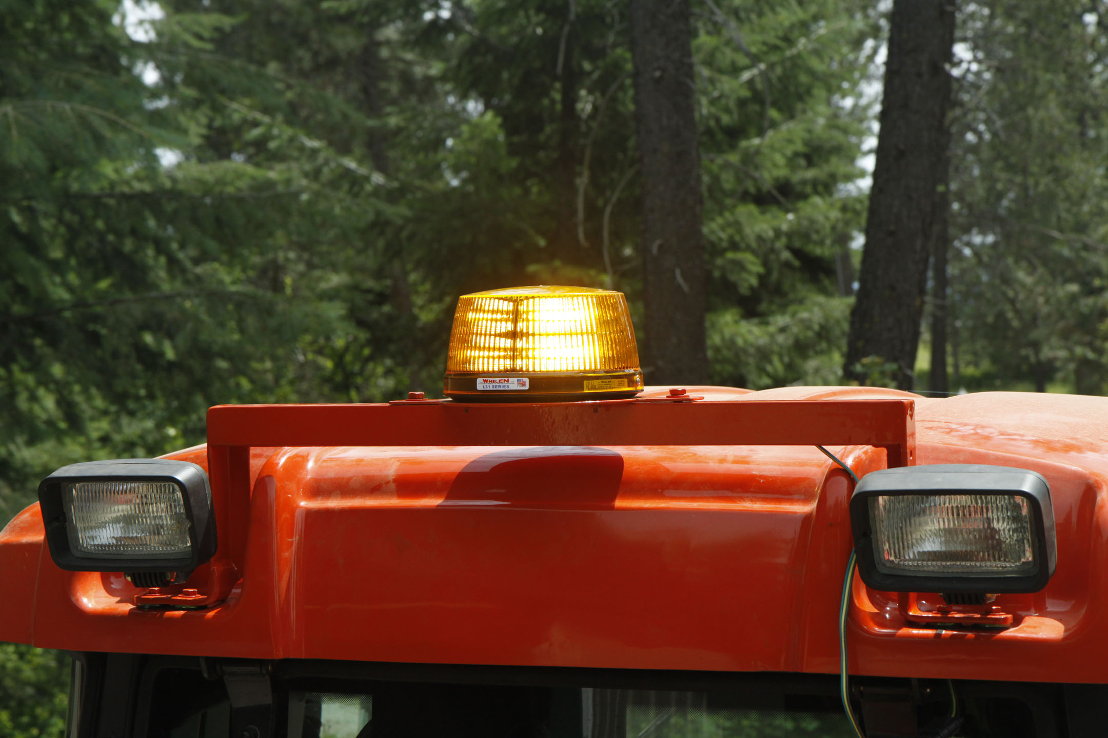

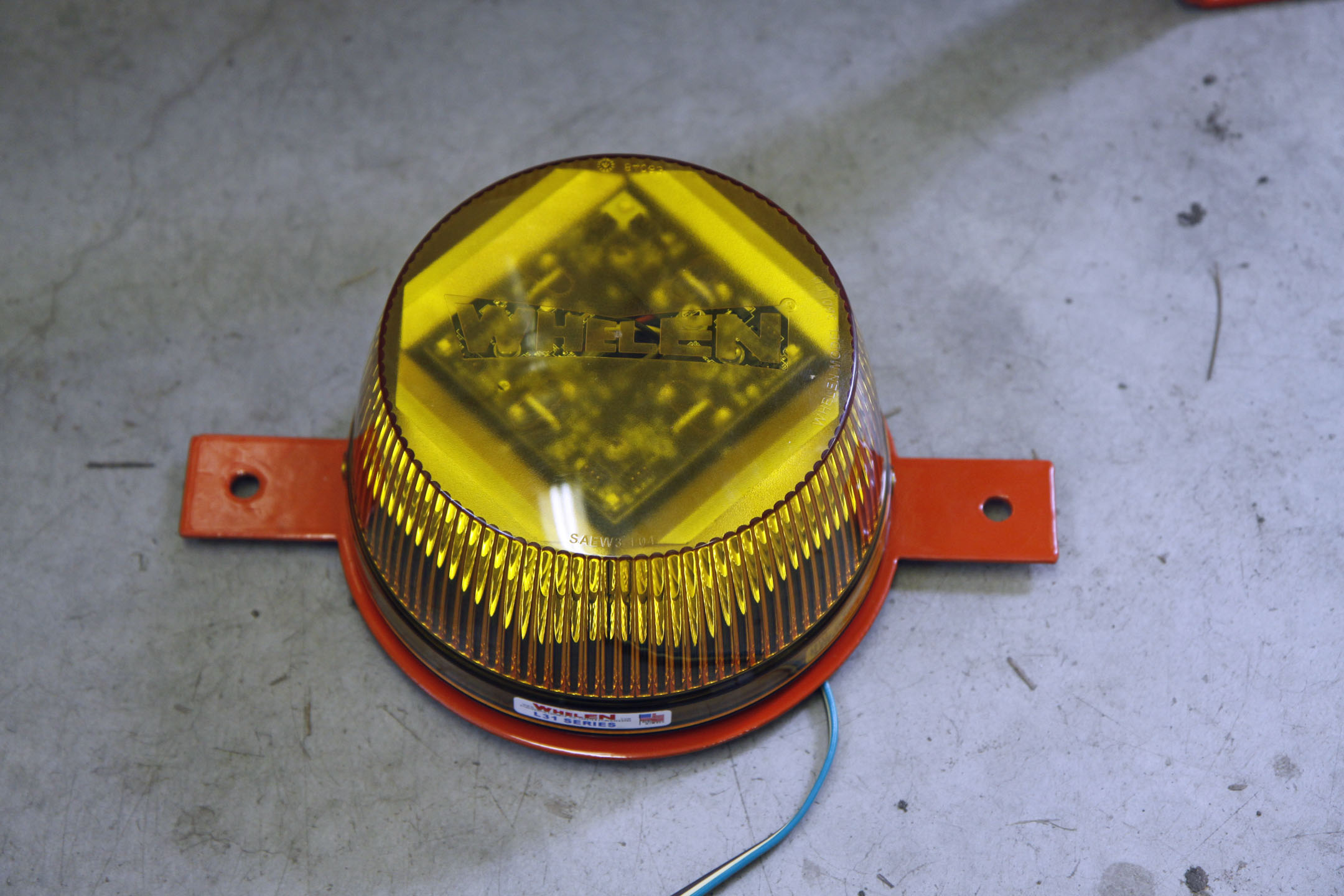

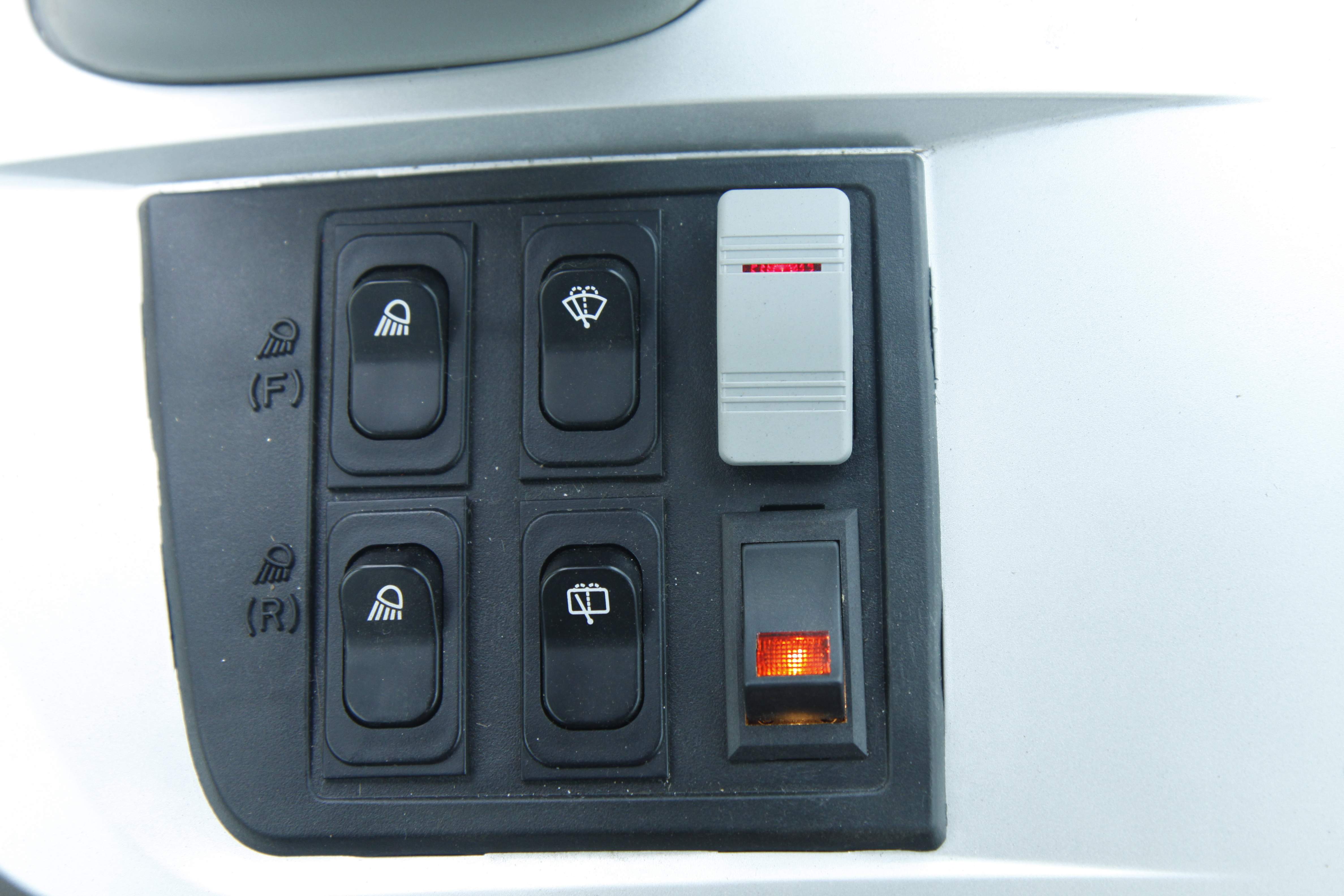

I really like my light on the tractor. I went with LED cause the circuit i tied into was only 10 amps and included the cig lighter. I hooked mine onto a rocker switch instead of the cig lighter though. All wiring is hidden that way, except for the wire outside. This wire is a 3 pronged trailer flat plug for easy removal come summer.. For a temp situation i wouldn't have cared.

You could easily use the running light power for the beacon. The one that grsthegreat shows in his post is top of the line (that's kick ***) and only draws about 5A.
