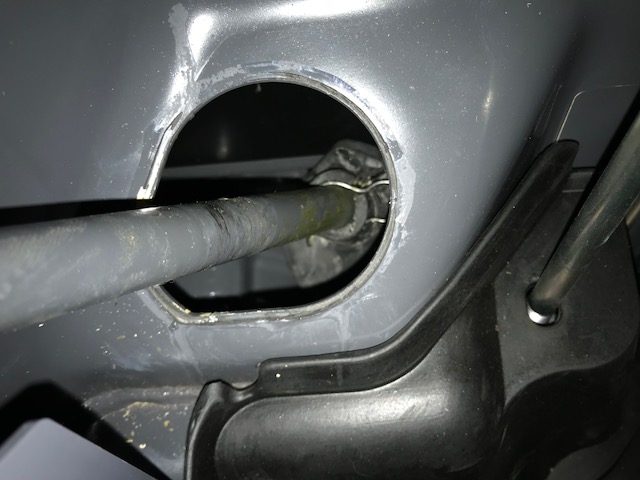

Steering grommet that I resolved before fixing:

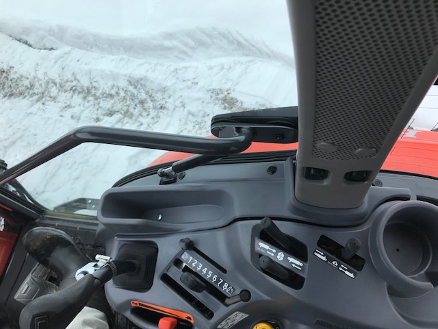

Not ever having a cab one thing I immediately noticed as you somewhat lose the feel of being on a tractor, which is good and bad. The bad part of that is to realize where the cab is in relationship to low things like tree branches. Another bad thing is I feel like the tractor is more stable than my last tractor, but it is likely due to being closer to the ground since my last tractor was a New Holland WorkMaster 55 and sat higher. On hills, it feels more like being in a pickup truck and not really feeling tippy. Perhaps it isn't, but it makes me nervous to not even have the feeling since I was so used to that. The other negatives I have noticed is not being able to hear every slight sound, like hitting something with your loader (which I've already scrapped one of the lean to posts on my barn once with it because I didn't hear the initial contact). The obvious good thing is the fact it is a lot easier on your body, and you can pretty much sit things wherever on the sides of you an expect them to still be there when you park it.
The couple things I did notice about the loader joystick are it is a bit stiff compared to my last loader (Ansung on the WM), and the loader lockout I have hit with my leg twice now and locked it out while using it and had to reset the lever. I haven't used the throttle up feature much, but because the tractor is new I reduce the throttle up from the max setting to about 2000 rpm. I have found it handy when I need to raise and dump a load of snow as it speeds things up. My grapple is on order so I can't speak to the third function, but I do think the on/off for the third function is honestly a bit hokey the way they use a strap to attach it to the joystick. If they wanted a switch for that, they should have just put it on the side like back where the loader implement hydraulic disconnect switches would go over on the right.

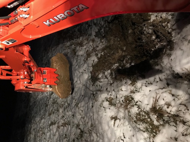

The backhoe is pretty nice, although it's a bit clumsy to get on. It's a bit of a small area and leaves you feeling somewhat trapped between the seat and the controls, especially since I am a bit taller. I haven't had any issues with the controls, and it does everything I would expect it to. I haven't done anything serious as I was trying to break the tractor in gently. The mechanical thumb already paid off as I lived a large rock out of a drainage ditch beside my driveway that was causing issues as I mentioned earlier. In the position it was in, I would have likely had to manhandle it over into the loader bucket which would have been difficult. The thumb was easy to adjust. I have the rubber pads on the backhoe, and that was good because I didn't do any damage to my driveway (despite being gravel) when using the hoe. I've read in the manual the stabilizer pads can be flipped over and it appears so by removing a pin and turning them to the other side, so the triangle is down and you can get better traction if you were in dirt and didn't need to protect the ground. Reaching the backhoe controls from the cab is a bit of a challenge, as I have to open the back window, turn around, put my knee on the seat, and reach out the back window. The backhoe sits further back from the operator seat on the cab model and this is done obviously because of the cab. There is a second mounting plate that is on the backhoe that allows it to sit further away from the tractor cab to make it work on the cab tractor. I haven't tried to get to the loader joystick from the backhoe station, but I doubt it is doable, at least not easily.

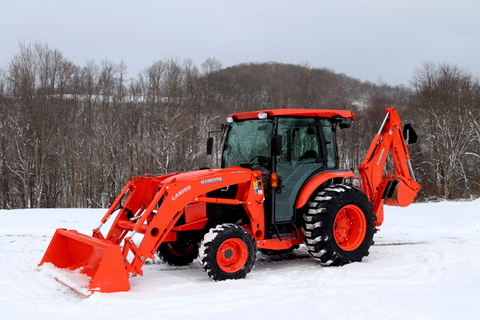

Tractor picture in the snow:
I did a lot of research prior to purchasing, and thank everyone that has posted thoughts on the L, grand, and cab models in the past. Likewise there were a few good YouTube videos where folks did a pretty good walk around of the L60 cab models which really helped my purchasing decision in know what options I wanted and which I didn't think I needed.
