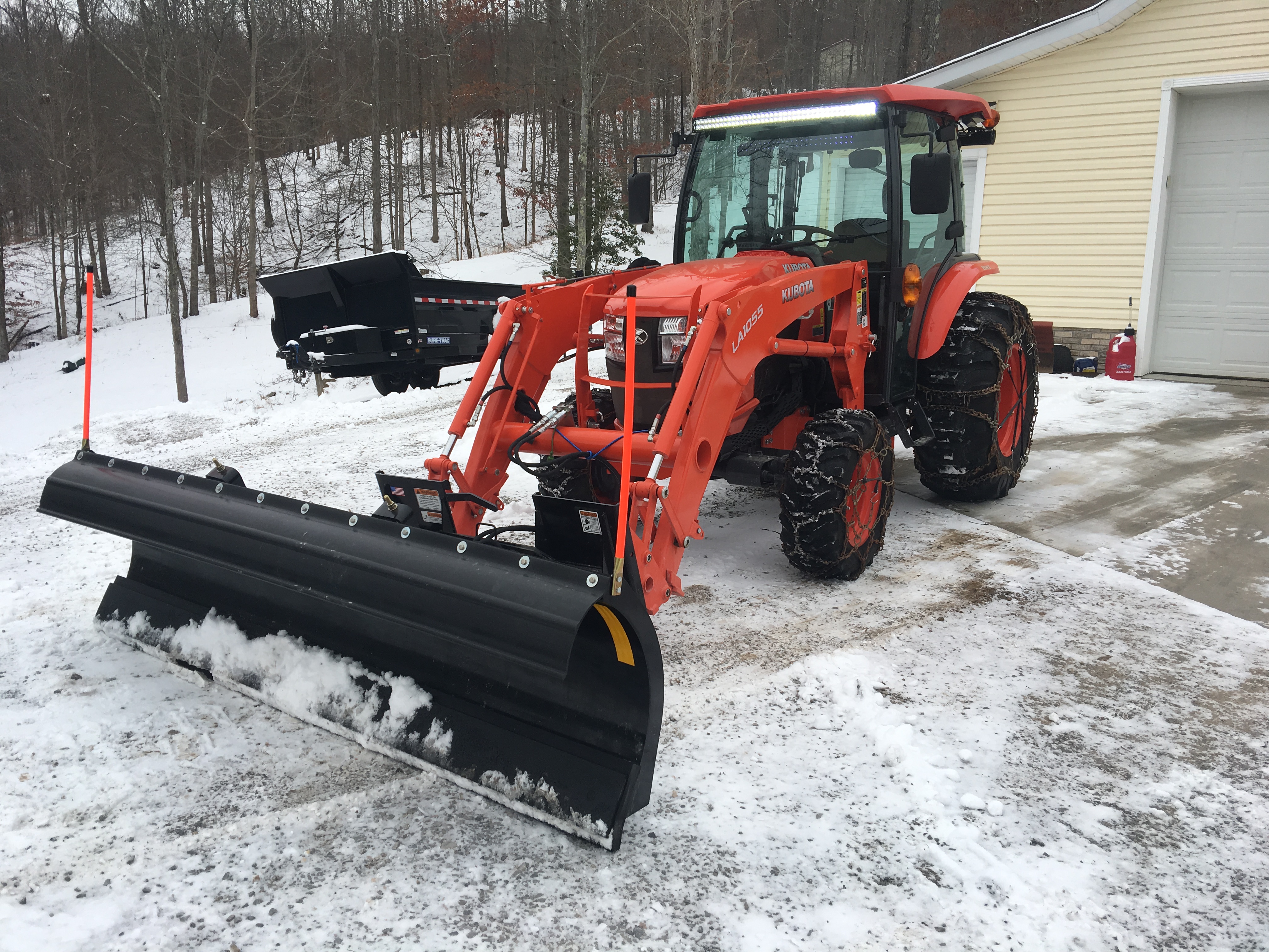

It was a bit involved on the front light bar, it's a 42" curved light bar and I had to fabricate mounts to bolt up to the stock tabs, I also drilled through the heat sinks on the light bar and had to add spacers to keep from collapsing the fins... took some time and fabricating but it was well worth it, it fits good and I think looks good on the tractor, this light bar turns night into day and lights up the sides as well.
this is the light bar I used... Amazon.com: MICTUNING 42" 24W 3B339C Curved LED Work Light Bar Combo Off Road Driving Fog Light, 24-Month Warranty: Automotive
The rear lights were much simpler however and they just bolted on in place of the factory lights, these could be used on the front as well with less work, these are the ones I used on the back.... Amazon.com: LE 9 Inch LED Light Bar 18W Waterproof Driving Spot Light Three Row 18lm for Off-road Truck Car ATV SUV Jeep Cabin Boat: Automotive

The 42" curved light bar does a great job of lighting up the front and sides, this thing turns day into night....
On my other tractor I found on ice that the chains helped greatly, I took a couple rather exciting rides without them so since I had them left over from my other tractor decided to put them on, the front chains really help with steering with the front blade on, they really help with traction in the woods too.

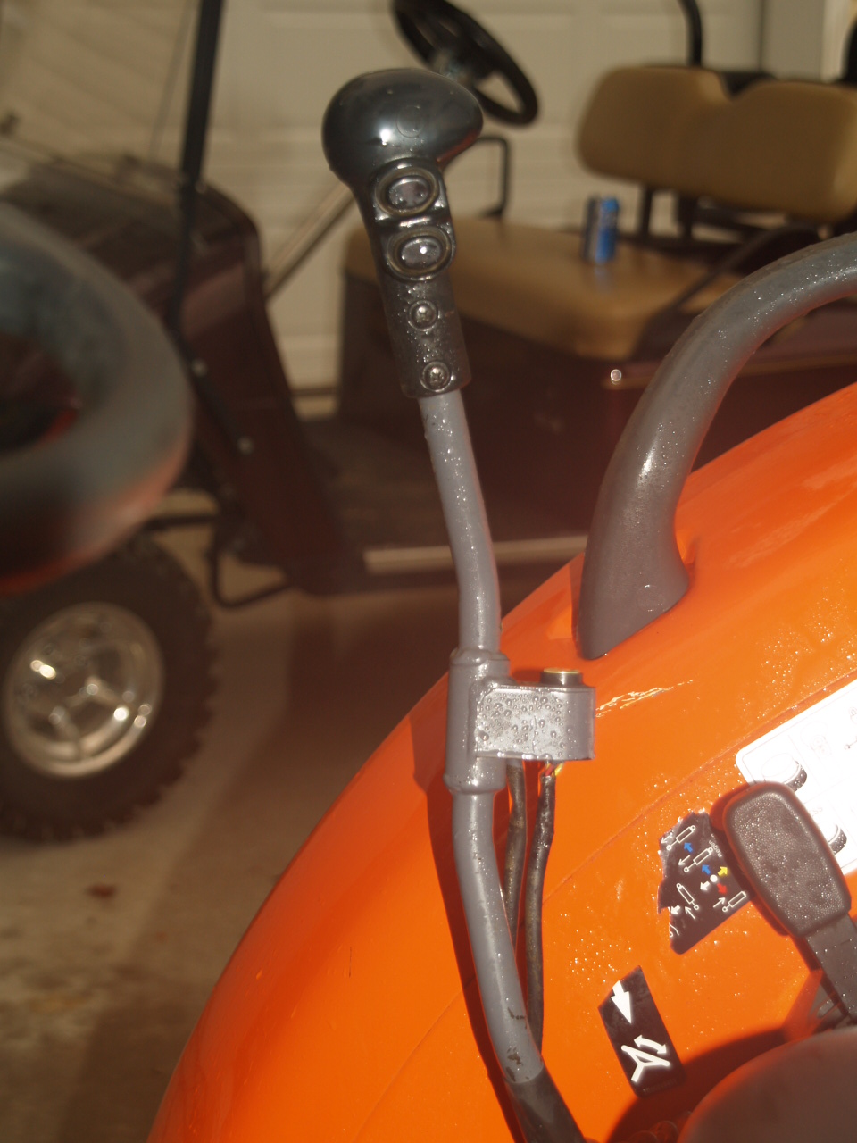

The 3rd function on my 3940 was very clean and as stated above integrated into the joystick... this clamped on switch must be something new...
this is a pic of the 3rd function switch from my old tractor..

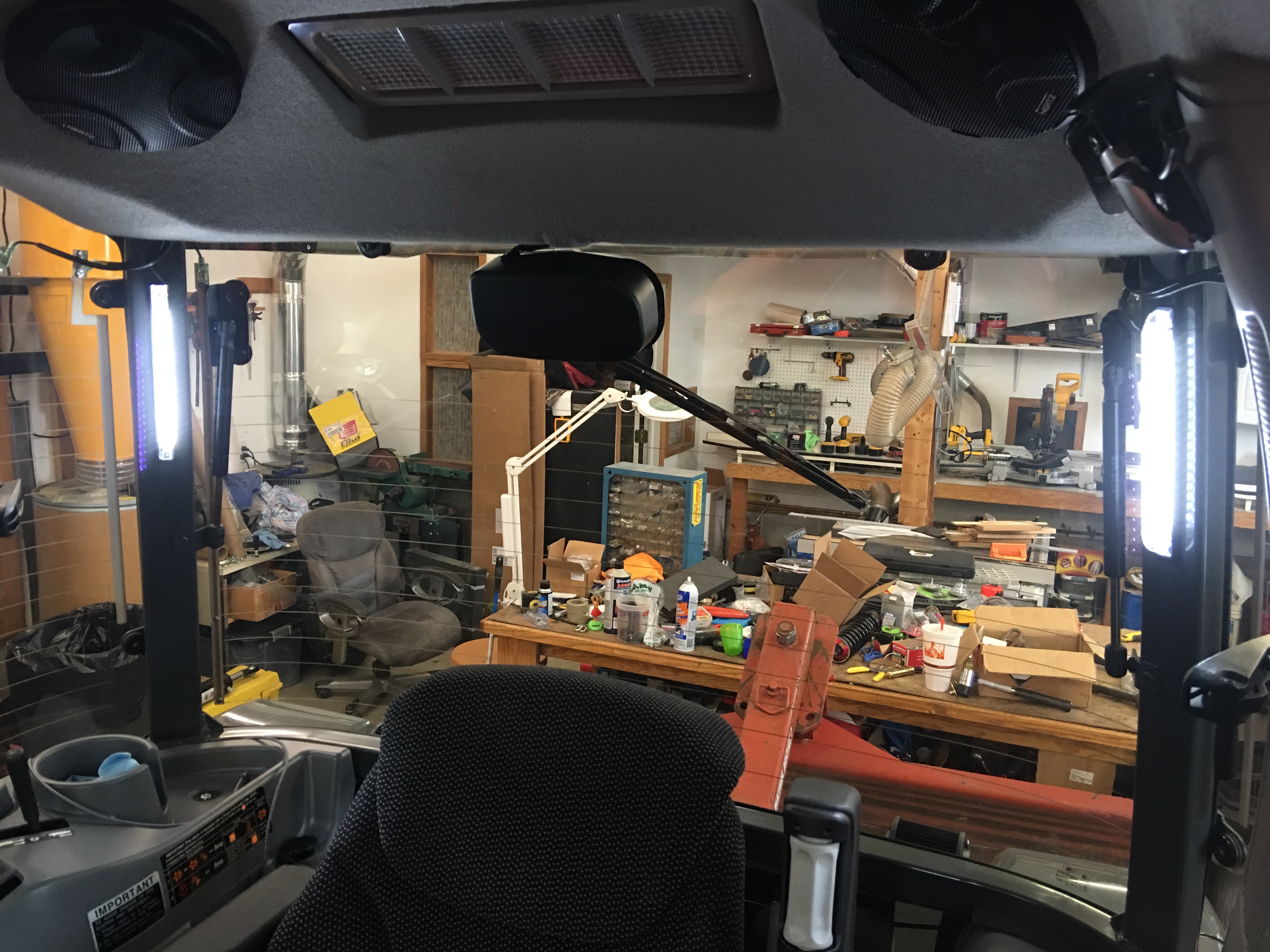

I replaced the work lights with LED light bars and upgraded the headlight bulbs to LED as well, it makes a BIG difference and provides so much more light.

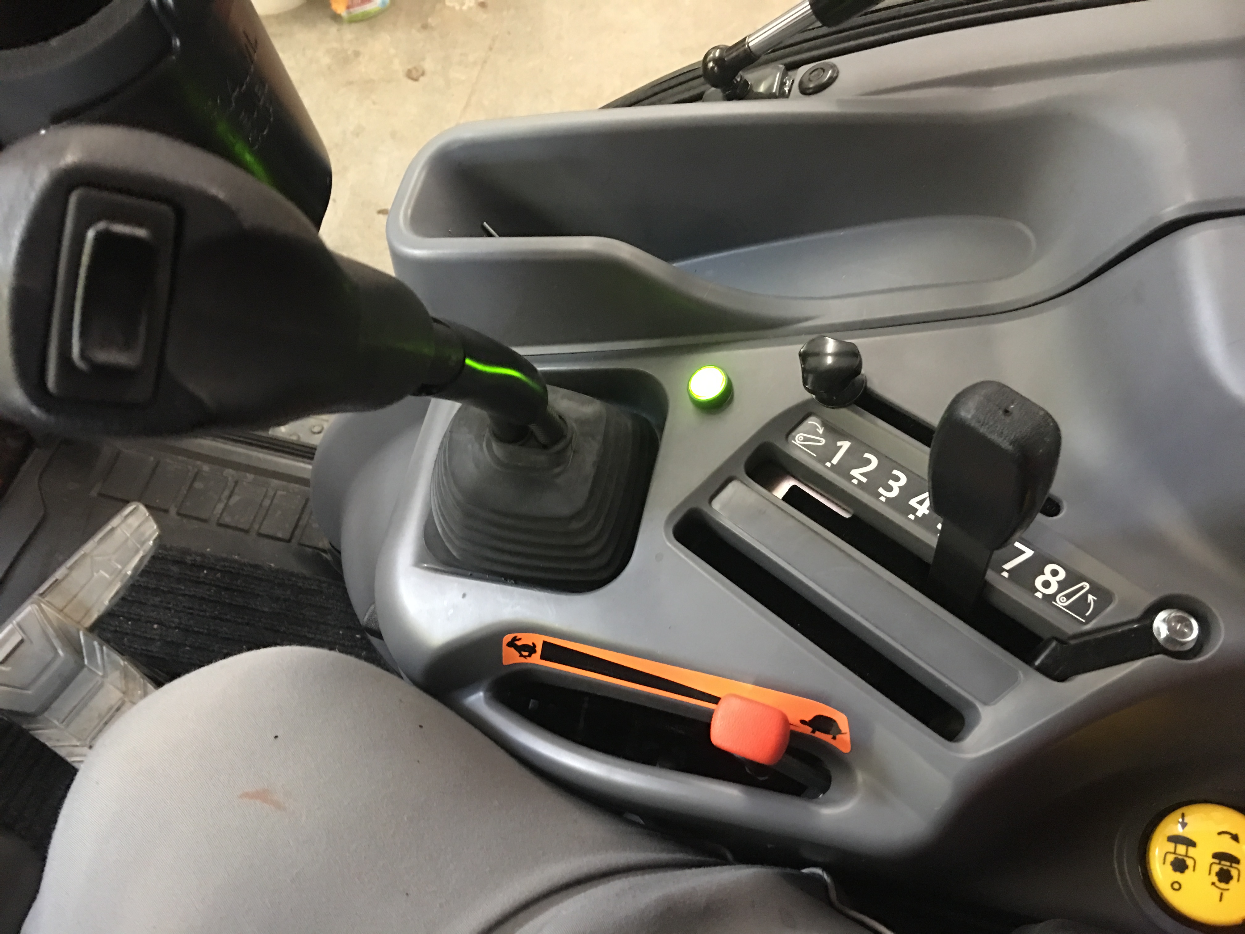

I've attached a pic of what I did with my 3rd function switch as I did not like it mounted to the lever with the clamp either, my switch was actually bad and the dealer gave me a new one to replace and I decided to drill a hole and mount it as pictured...
Great idea with the third function switch, Steve.
I will do the same with mine.

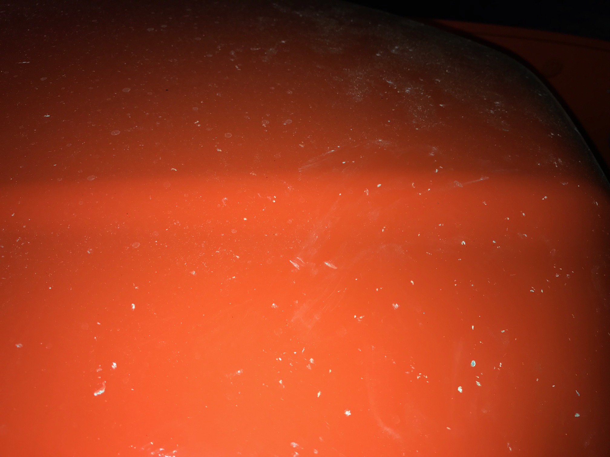

In testing the loader, I had a pile of 3/4" gravel that I used to get a load, lift it, and let it down. In years of owning tractors, I have never managed to allow gravel or anything else to fall out of the loader onto the hood by accident. I was lifting the gravel extremely high to test the loader circuit and all was well with keeping the bucket level. But I let off the joystick too quickly and it bumped back and gravel went over the top (full bucket) and onto the hood and front frame. It looked like something out of one of the JD advertisements showing off their plastic hood that won't chip. Well, I think those JD guys were onto something, because the Kubota hood and frame did chip when the gravel hit it. Bummer. If anyone has any ideas of how to properly repair that let me know. I didn't notice any dents, just chips. I'm rather peeved at myself for this one as I have never done it before and should have taken smaller bites of the pile not being fully accustom to the loader controls yet. I will say the loader does smoothly curl in and out when raising/lowering as I would expect to keep things from spilling (I don't have the spill guard btw). I could definitely see how you could get yourself into trouble not having the spill guard and forgetting to roll the bucket forward. Honestly the only time I have ever lifted anything that high practically is when I was dumping trash into a dump truck with my last tractor. I was very surprised how high the LA1055 loader could go, let alone lift a full bucket of gravel without any issue.
Here's a picture of the hood:

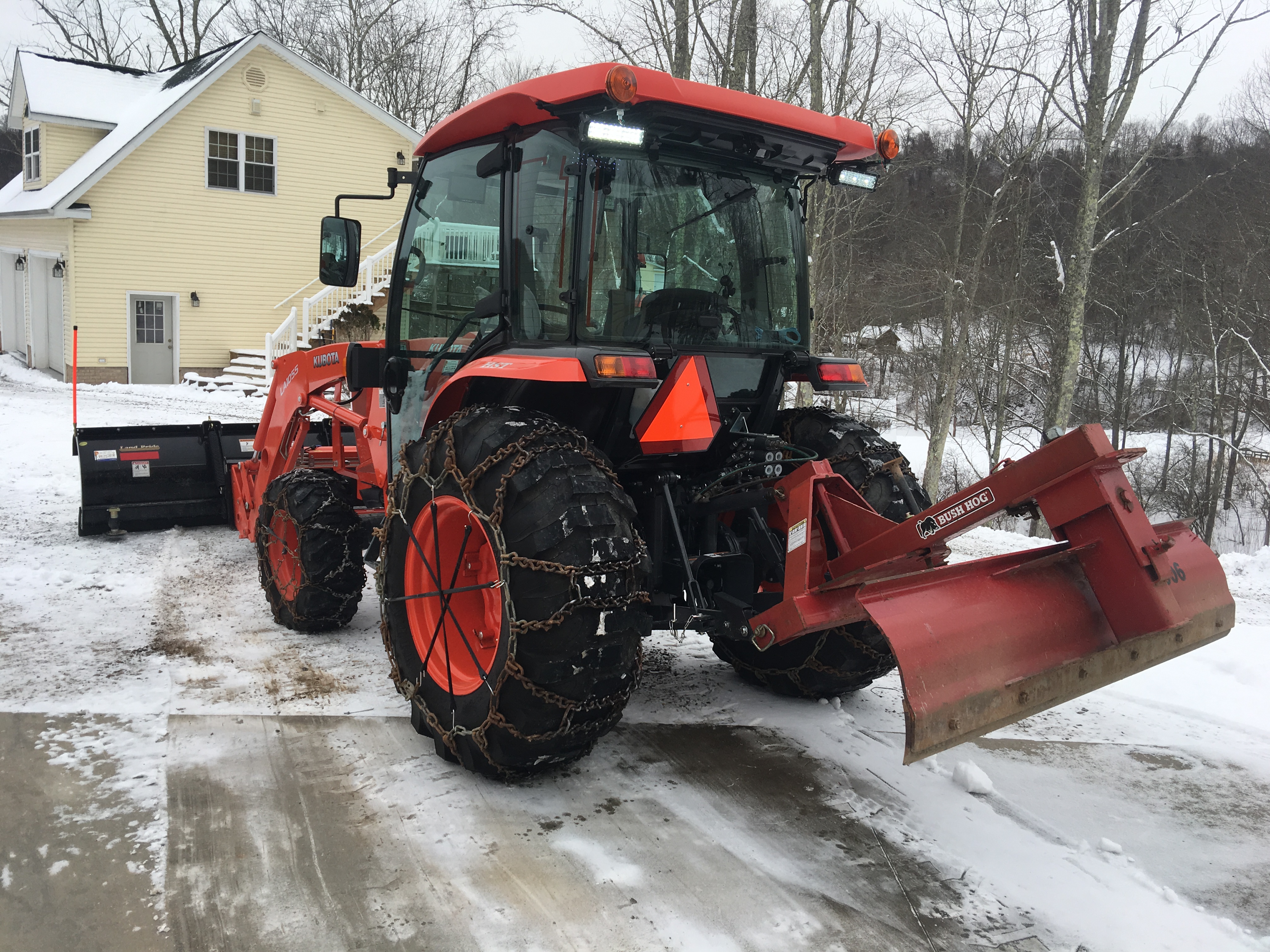

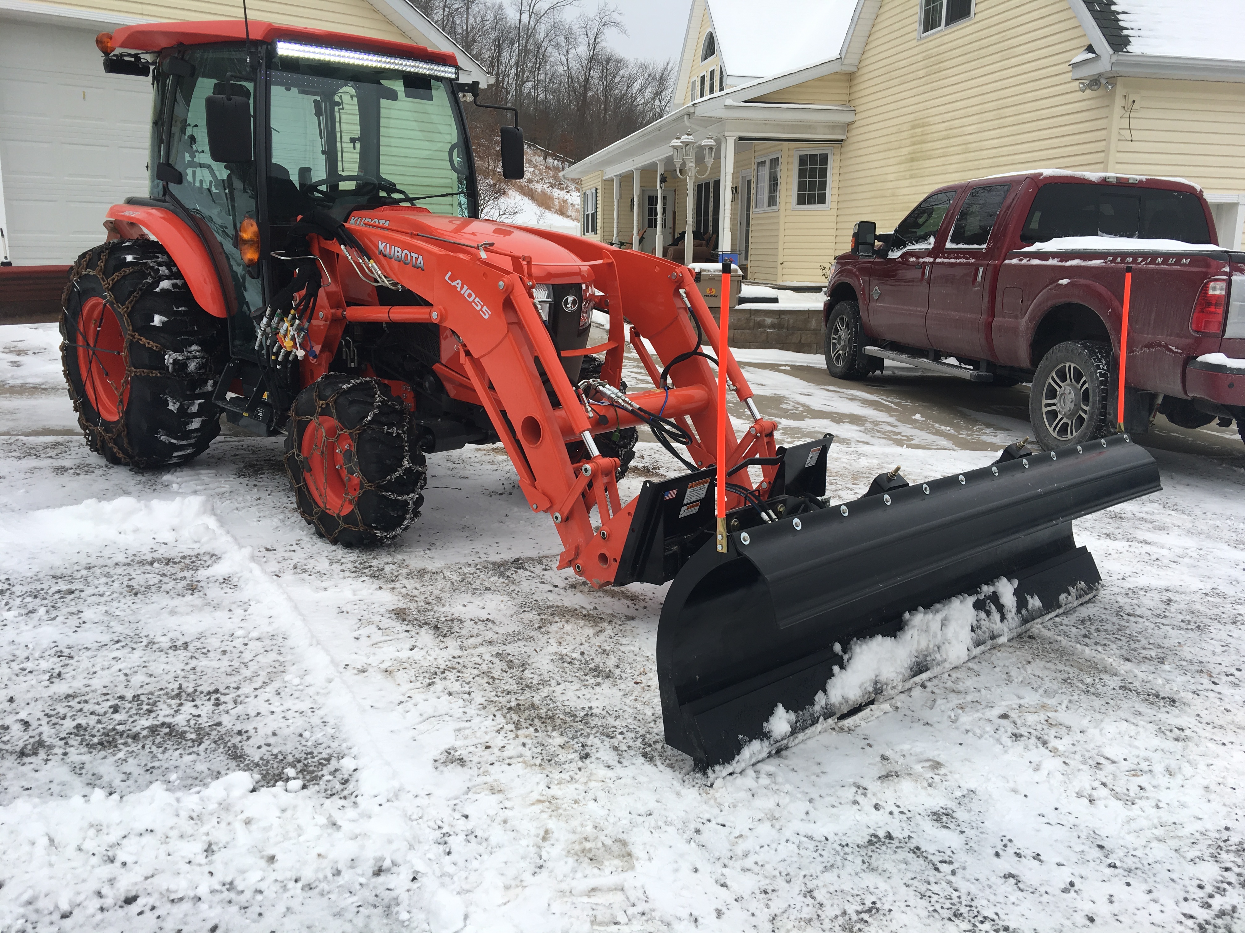

I plowed some today with mine and am so-far very pleased as well......
The only thing I wish this tractor had was more than one speed on the windshield wiper, I'm going to try to figure out a way to remedy that, years ago you could buy a box that installed on the windshield wipers in cars to accomplish this but since all cars now come with this option I doubt it's readily available anymore...

Interesting, I could see that as an issue. I haven’t had to use the wipers yet as it stopped snowing by the time I was off work.
I love the front plow setup you have. That looks very convenient.

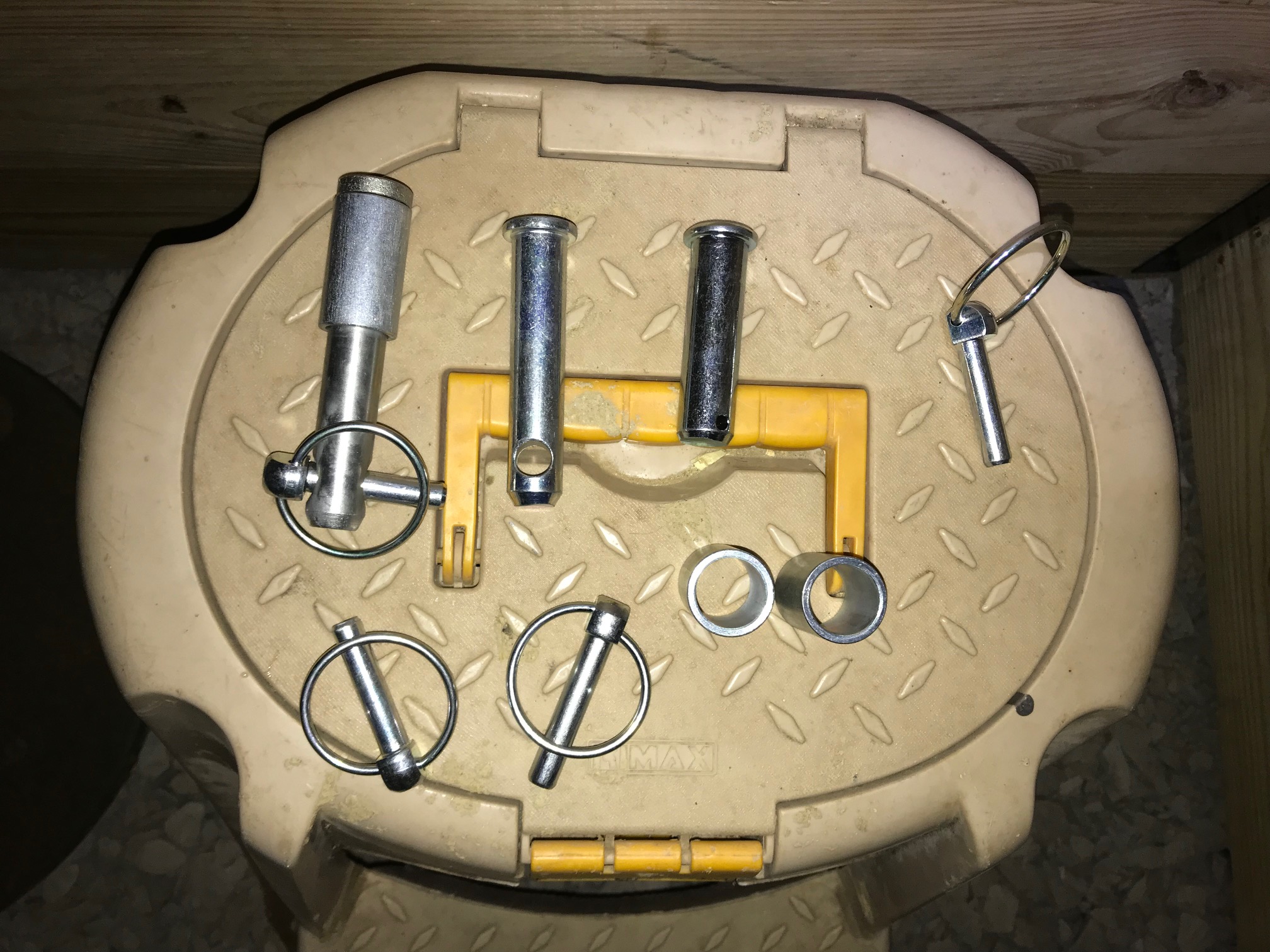

I also haven't figured out all the three point pieces. I haven't removed the backhoe yet as it is supposed to go back to the dealer Monday to install the defogger switch and for them to look over a few other minor things I have pointed out in this thread. It looks like the three point system needs wrenches to install. If so I am somewhat disappointed in this because I figured it would be faster to install and uninstall, as everyone raves how easy it is to remove and install the backhoe.
I have three pins I have not quite figured out. I think the fourth one is a cat II top link pin which I inserted into the top link so I didn't lose it. These other three pins I haven't figured out what they are for yet.

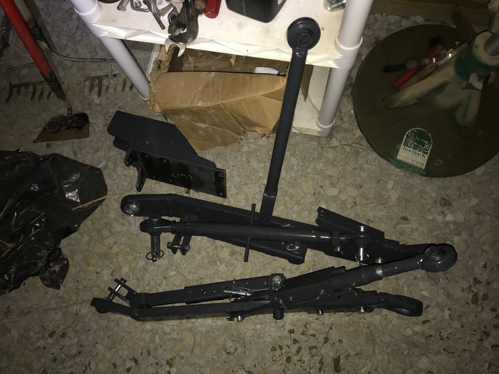

And here are the lift arm pieces:
I think when it comes back from the dealer next time I may drop the hoe and try to figure it all out. My concern is if I have all the parts I need so I don't go to use my blade and realize I can't work until I get the correct parts.
