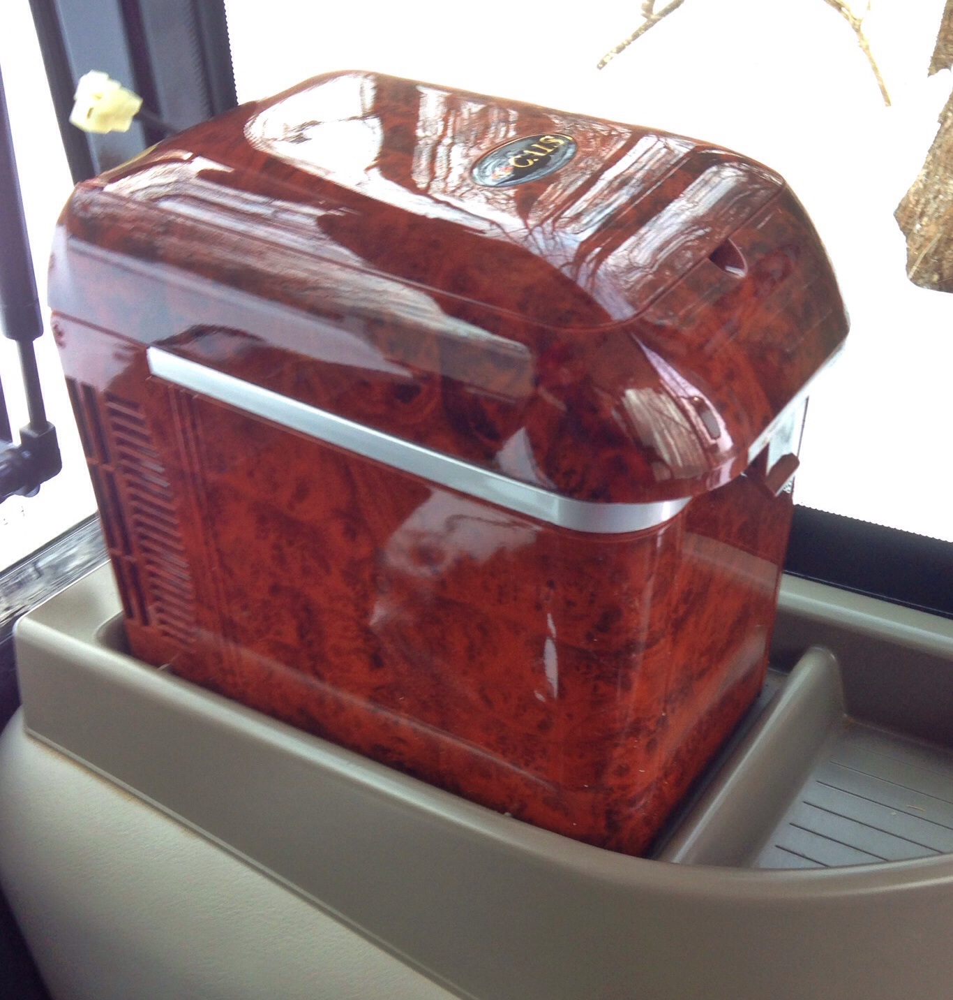

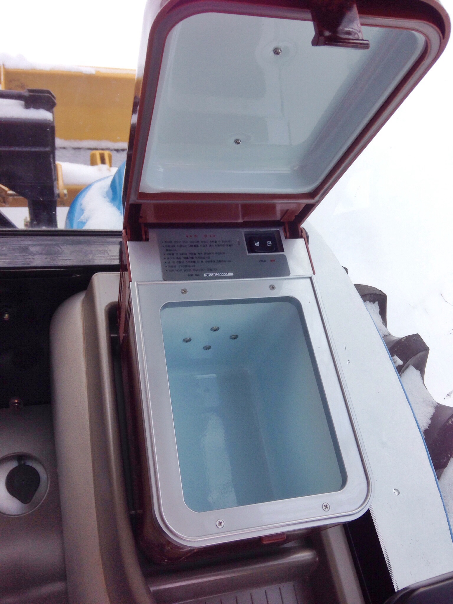

I put a Marine suction cup mount beer holder on my windshield.
