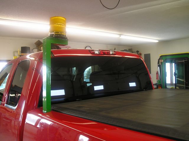

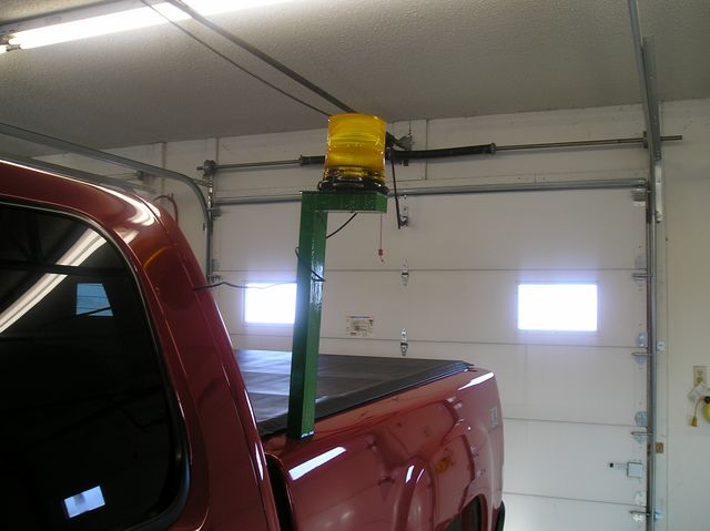

That is the very reason I got my Whelen model L22HAM. I even made a mount for the magnet mount to sit on so it didn't scratch the roof of the truck. Just rip a 2x4 to fit your stake pockets, screw on a short 2x4 to the top, add a hunk of plate steel and paint your favorite color. Then you can turn it inside or outside.
