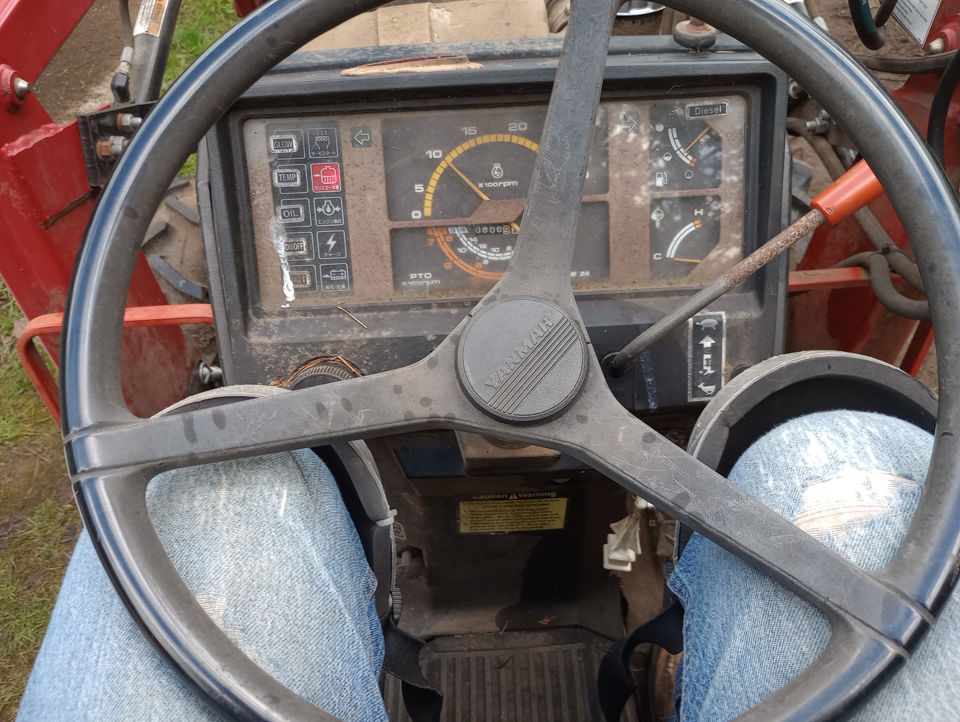

Have an F20D with aTemp light that comes on the moment I turn on the key and remains on till I shut it off. Wanted to try to figure out what the problem is but I'm at a loss as how to access the instrument cluster. there are two screws on top that I thought would be the key, but no luck initally and I didn't want to force again and cause more problems. Can post more picutres of the dash area if necessary. Also what might the problem be as far as the light is concerned?

Maybe I missed something but why do you want to take the dashboard out? The light seems to be working so it's not from there?

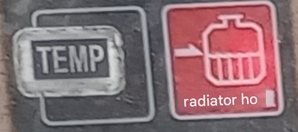

Anyway, to me, that symbol indicates coolant level and so does the text under the symbol after translating it. Have you checked the level of the coolant at both the radiator and expansion tank?
The coolant temperature gauge is on the right side, under the fuel level.

The TEMP light translated says radiator running hot.
Do not take the dash apart.
Instead, check to see if the tractor has enough coolant, the radiator is not plugged up, and the water pump is working.

The water level sensor is installed on the expansion tank. It's empty, the light will turn on, so it's working as intended.

When I translated it to Portuguese, it translated to "radiator water amount" and the arrow does indicate level.
I used google image to text. I wonder if the other two image-to-text translators would do a better job.
I would agree with your findings. Even the image shows fluid level. (y)
Maybe it does both ? :unsure: It is a temp light.

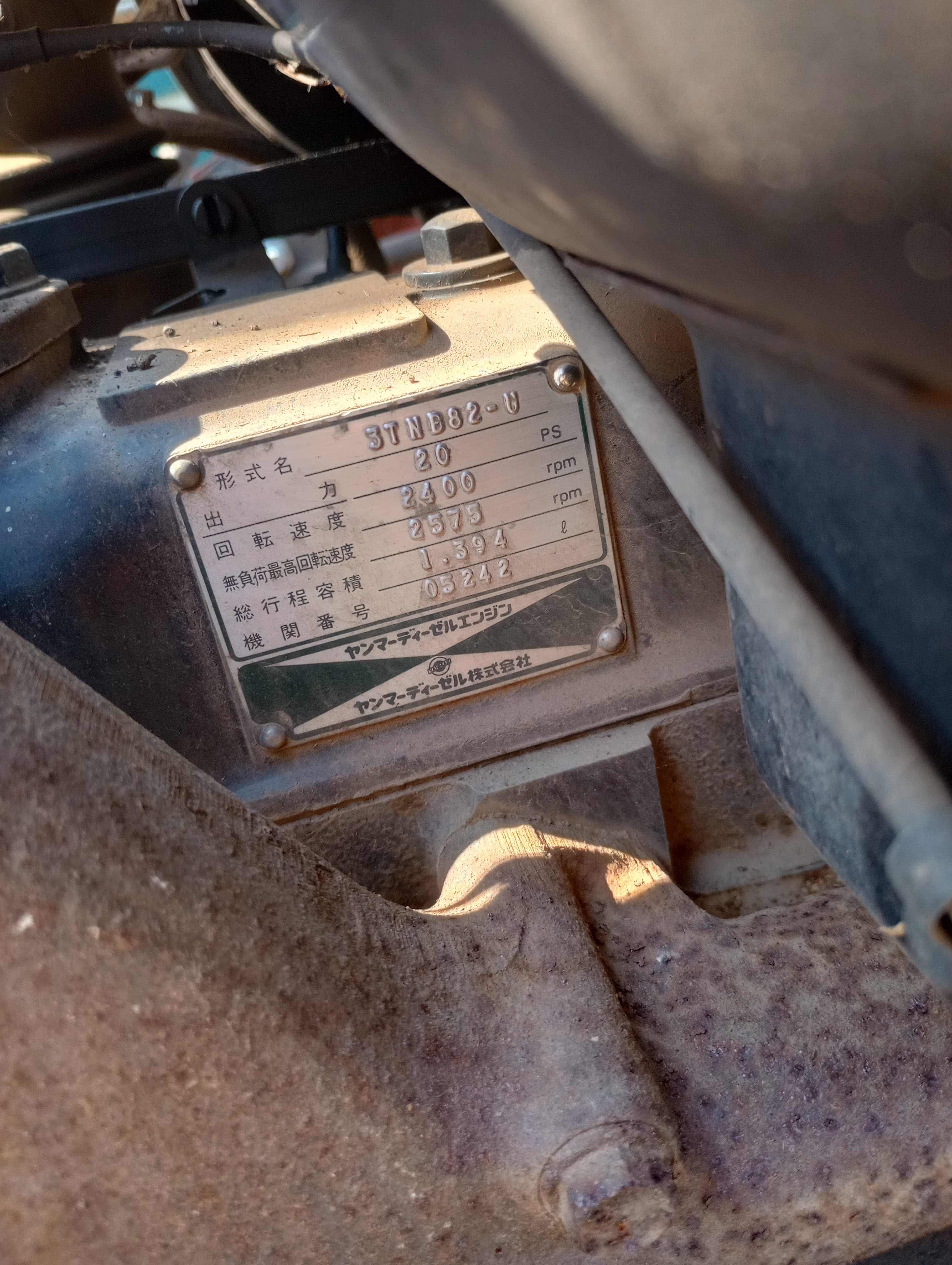

Not sure how it differs, mine reads 3TNB82-U

Light went off the moment I started it with the expansion tank filled to the full mark. Thank you, I've never used the image-to-text translators spoken of here, I have to check them out.

Not sure how it differs, mine reads 3TNB82-UView attachment 5473179
3TNB82-U
3 = number of cylinders
T = tractor or any land based use engine
N = next generation engine family
B = the emission engine family
82 = piston diameter in mm
-U = non-sleeved/liner engine block
As your machine is a non-sleeved/liner engine block type, take care not to rev the throttle very fast from an idle to high working rpms and likewise from high rpms quickly to idle. This will extend the life of the engine and many years of use.
