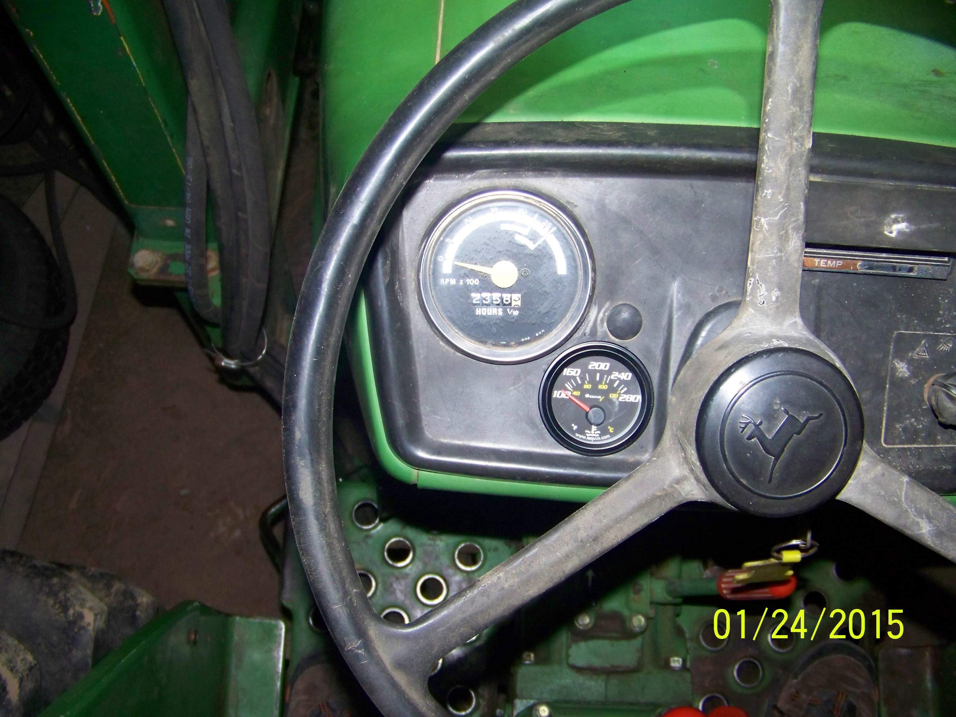

Just installed this gauge on a 1050 John Deere. Equus 6262 - Water Temperature Gauge | O'Reilly Auto Parts Although the on line information does not state this, it comes with adapters, one is the m16-1.5 adapter required on all these grey market Yanmars. Several wires to do on it although it comes with some terminal spades it does not include wire. Takes a 2" hole for installation. Includes illumination light.

looks real good there Winston, I plan to add a temp ga to mine, may have to "borrow" the install location from you !!!

Winston, were you able to splice into the stock sensor wire or was there a new sensor that goes with the gauge and if thats the case, did you need an adapted to make that fit or was it the correct size to screw into the stock sensor location? And I AM GUESSING but since there is a backlit gauge, was that another wire going to the ignition?

The gauge requires it's own sensor. The correct sensor and adapter is included in the kit. Yes, you would need to splice into a dash light wire to illuminate. I cut the wire going into the old warning light and used that wire from the new sensor to the new gauge.
Many people prefer an oil pressure gauge over the warning light. I prefer the light. I am much more likely to see a light come on than to see a gauge drop pressure. I do regularly check to make sure my warning light is working. You can install a pressure gauge that reads off and elecrical current. Just requires its own sensor. Your threads are 1/8"bpt, 1 thread per inch different than npt.

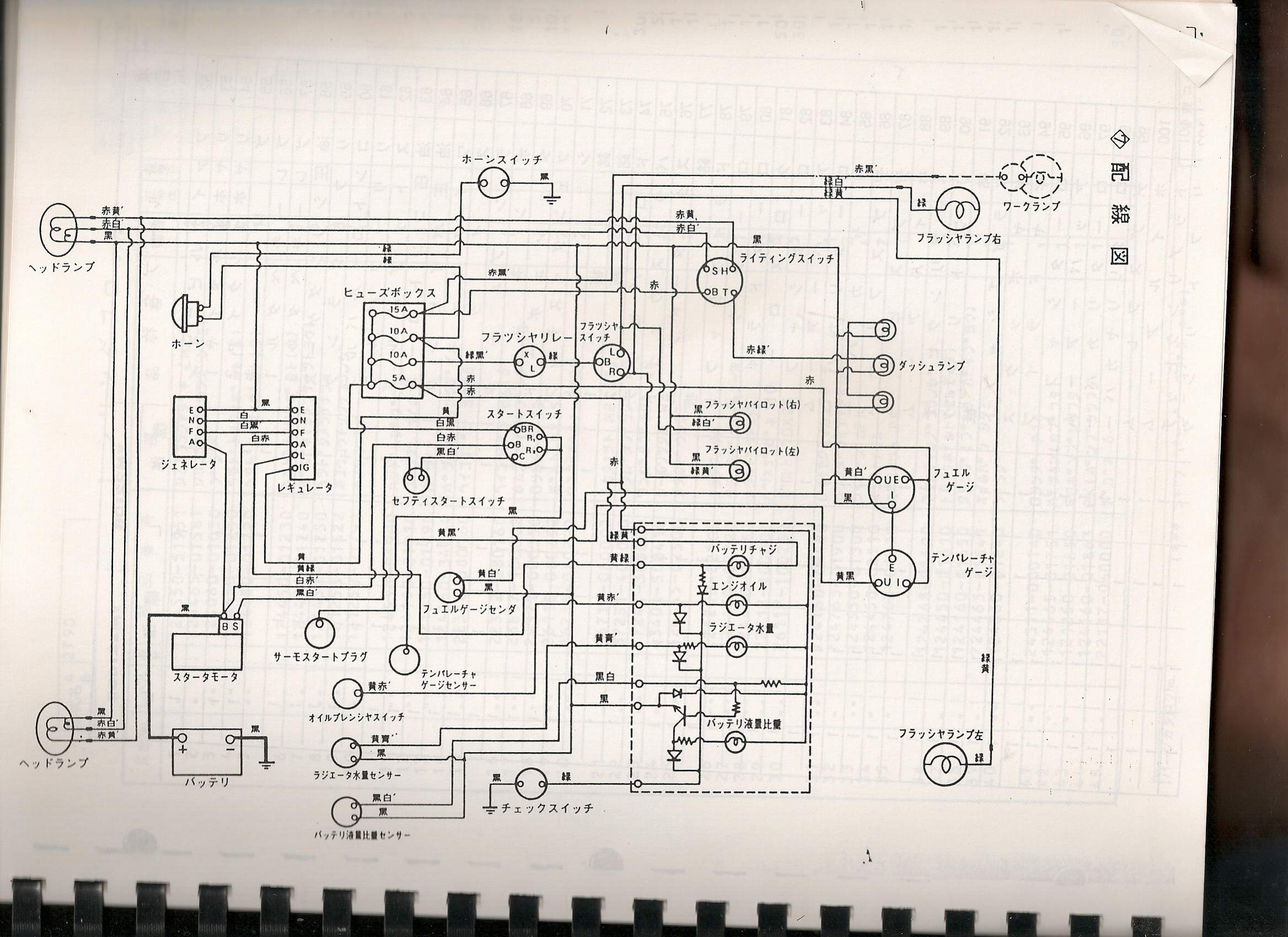

You may have a old fuse panel. Old Fuse Links maybe wire looking on a Flat pane "no cover". Just to the left under the dash. The are probably burnt just like a Glass fuse. The System is simple. Temp. Oil. and Charge. Ground out the wire and the light on the dash will come on. That tells you your Circuit is working and probably your gauge is to. Turn the key on and Oil/AC. Charge will come on. Crank it and they should go out. Get it working then I would add Gauges if need be. Here's a Diagram of a Ym2000. It's not your model tractor but it's basically the same. Crank it up and Oil/charge light goes out then your good. Ground the water Temp Wire out and it should come on. Hope that's right it's early for me!

Thanks for the replies. I thought I REMOVED THE FUSE BOX ? As I did find it. But the pic tells me a lot as it shows me the fuse sizes. Mine has four fuses and they are all huge amp fuses, which tells me they either had issues with then or were just out of fuses. I have zero lights on in my dash and nothing works, horn, headlamps ect. Since I am used to cars/ trucks I am used to a HOT leads coming off to a fused link off of the positive. This has a hot battery cable that goes directly to the starter solenoid and then from there the harness goes behind the dash are. I have five rusted screws holding that metal plate on under the dash/ steering wheel so I WILL remove that. My main issue is my shop is not done, just enclosed and I am waiting to add another sub panel to give me more lighting and its cloudy cold and dark. so I will have to wait. so I sprayed all the leads and screws with WD40 so as to be able to get it all apart. If all else fail I can wire a temp gauge in from scratch using all new wiring. Thats almost easier for me. Once I have some light, I will use my test light and start tracing power.

I managed to clean up the connections on the fuse box and now I have power to my OIL and CHARGING lights. This was the far left or #1 FUSE in the box and it also fixed my horn, which now works.
I have a TEMP LIGHT but I also have a TEMP AND FUEL GAUGE, neither of which work. I have NO POWER coming from the connector that comes out of the dash to my fuel sending unit.
I have shown a picture of the fuse box. The fuses are listed 1-4 from left to right.
#1: fixed my two working dash warning light OIL and CHARGING.
#2 IS UNKNOWN
#3 IS UNKNOWN
#4: LIGHTS.
Does anyone know what #2 and #3 source?

Looks like one middle fuse goes to the horn and regulator,other goes to the turn signals.
Pull the wire off the temperature sensor and with the key on touch it to ground and see if the gauge moves. If so, the sender is probably bad.
Schematic shows only one wire going to fender lights, they have to ground to the fender. Most likely the green wires going back there.
Hot red going to rear is probably for a work light.

would the regulator manage the OIL and CHARGE WARNING LIGHTS? My #1 fuse manages those and the HORN.
/ Temperature gauge #19
and YES--When I remove the TEMP GAUGE sensor wire (yellow) and ground it with mt test light to the battery it moves.
So that said, my plan is to add two gauges if possible. The TEMP gauge which winston1 has done and I want an OIL PRESSURE gauge. Can I install an oil pressure gauge to this engine without taping the block ect? HAS ANYONE DONE THIS?
And the GREEN wires with the yellow stripe that match the fender light wires are not hot when I have the lights on? Just the RED is hot.
