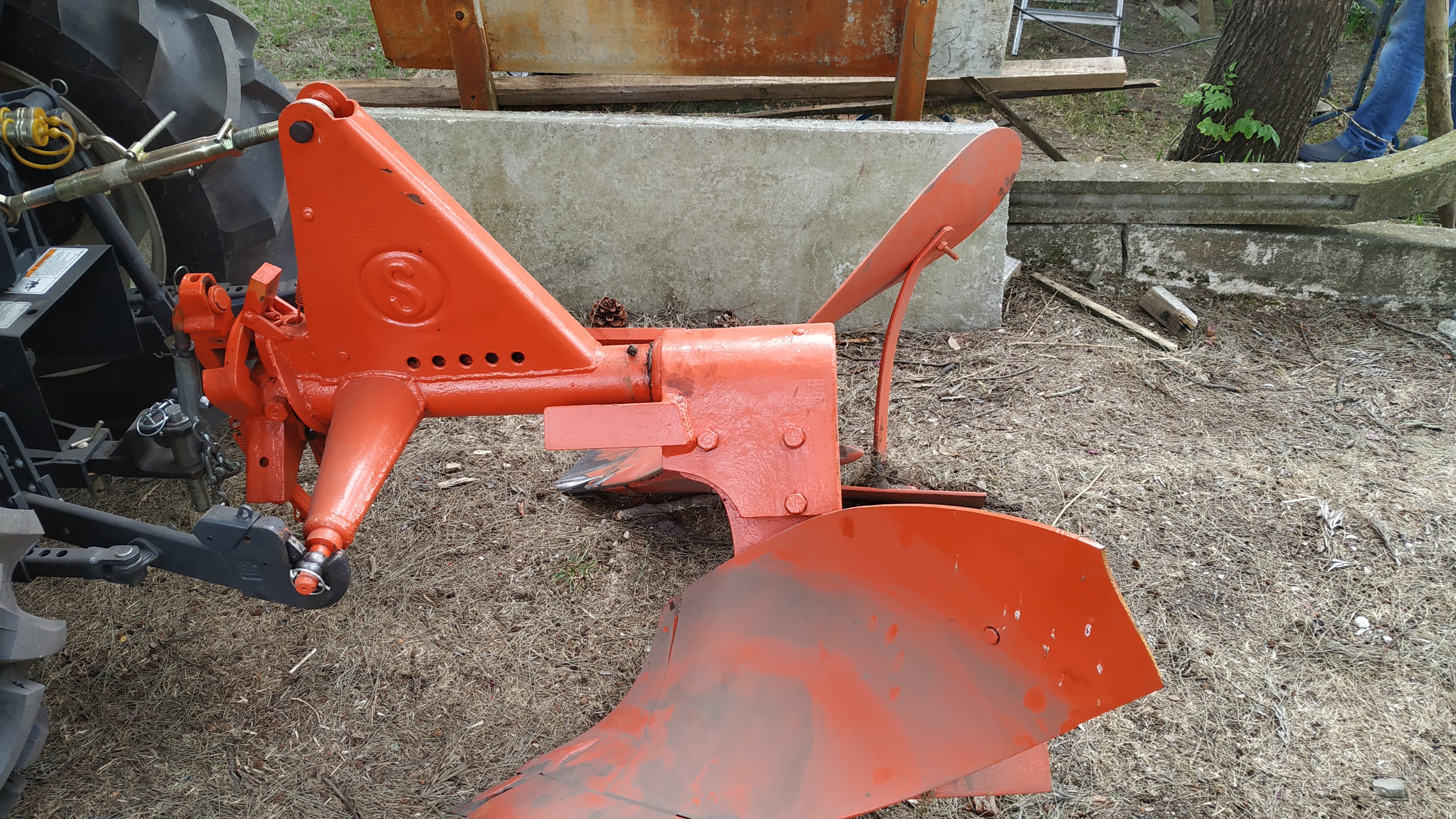

Although I don't have Pat's, I have what most likely Pat's is based on. The standard European Quick hook style:
In my opinion, this style is much stronger than the Pat's one, plus it's already welded on the lift arms, so no extra length there. The ball allows for more freedom of movement to prevent binding on any height position and allows you to offset the implement to one side or the other if it really needs. It will also self latch once the ball gets in.
Now, this style of hook won't need telescoping arms but it will surely benefit from telescopic stabilizers as it prevents the arm from moving around when trying to hook up to an implement.

/ Telescoping Lower Links vs Pat's Easy Change #19
"In my opinion, this style is much stronger than the Pat's one, plus it's already welded on the lift arms, so no extra length there. The ball allows for more freedom of movement to prevent binding on any height position and allows you to offset the implement to one side or the other if it really needs. It will also self latch once the ball gets in.
ptsg, not sure what you are referring to as the "ball".
I believe that Kioti has the Euro styl QH hooks as an option. They simply replace the extendable link slide in part with a slide in hook. :cool:
The balls that the Euro hitch connect on are typically left in place on each implement. ;)
Top link QH also pictured.
