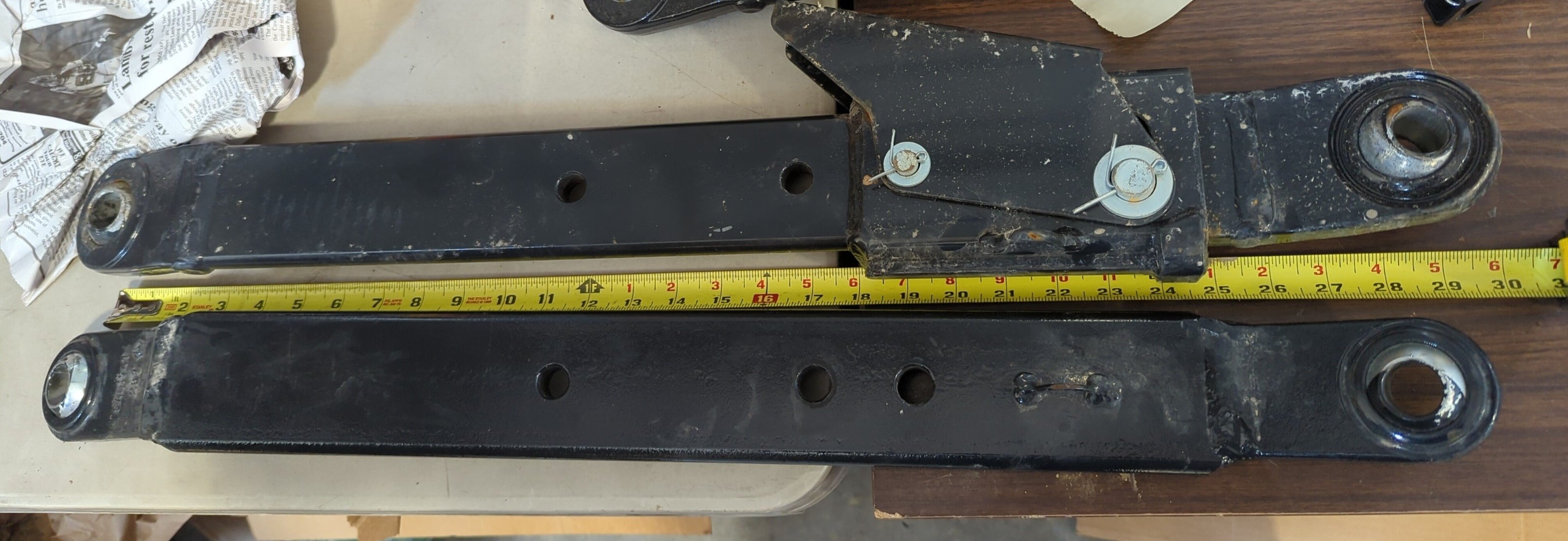

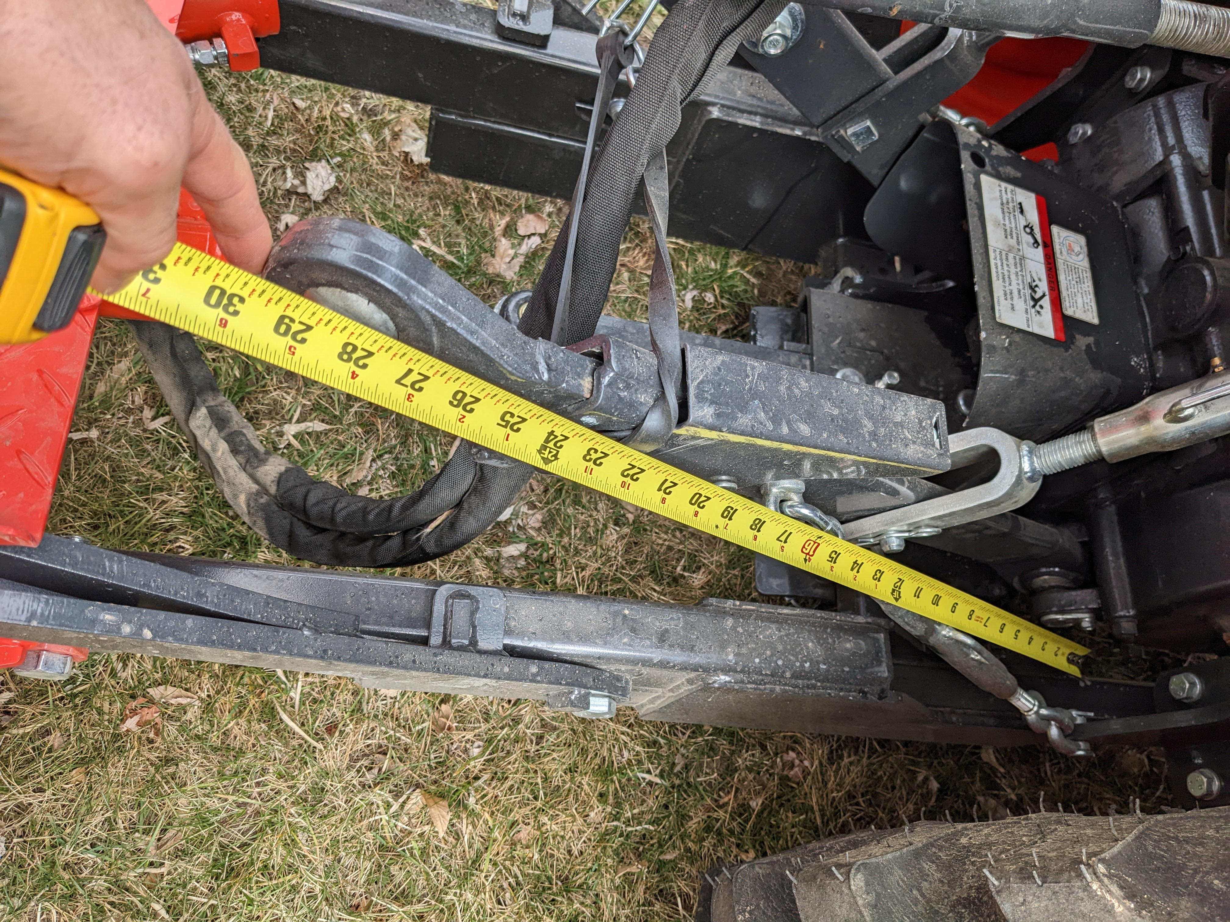

I have a 2022(1?) ck2610. I believe this answer would be the same for any of the other CK10 series. I HAVE the telescoping lower links, but am trying to choose a hydraulic top-link length and it's right in-between. I'm trying to determine if the "stock" / NON-telescoping lower links are shorter (I've never seen a pair, I didn't realize the dealer stripped them to install my factory telescoping or I would have demanded they provide them to me).
How long pivot-to-pivot are your stock/rigid lengths? For reference, the telescoping links are roughly 28.25" pivot to pivot.
The ck2610 specs it's 3point lift at 24 inches, which leads me to believe the stock links may be several (4?) inches shorter than my 28 inches?
Thanks!

Thanks for confirming. Unclear if this is accurate or not, according to my dealer, see below
Since I'm switching to easy-to-connect quick disconnect "euro hooks" as well as top-and-tilt, I will be fine without the telescoping links. I don't believe I've seen any practical limitations being ~4" further out than the stock, but closer can't hurt.

well, my dealer has a pair of fixed/non-telescoping links, ostensibly from a ck10, and claims they are 28" center-to-center. I never volunteered the length of my telescoping arms (also ~28")
On the one hand, this would make sense; there is no reason the telescoping units couldn't be built to the same length. On the other hand, why kioti rates the lift of the 3point to a shorter length than the stock arms ... it should be like "at the bucket pin" I would think.
They are a ways away from me, but hopefully I can make it in to get this cleared up.

I bought the shorter one and it worked great. Added pat's quick hitch and had to get the longer one

So both the fixed/stock, and telescoping links are BOTH ~28"
I suppose perhaps there could exist multiple lower lengths of fixed for ck10/ck20... seems less likely?
