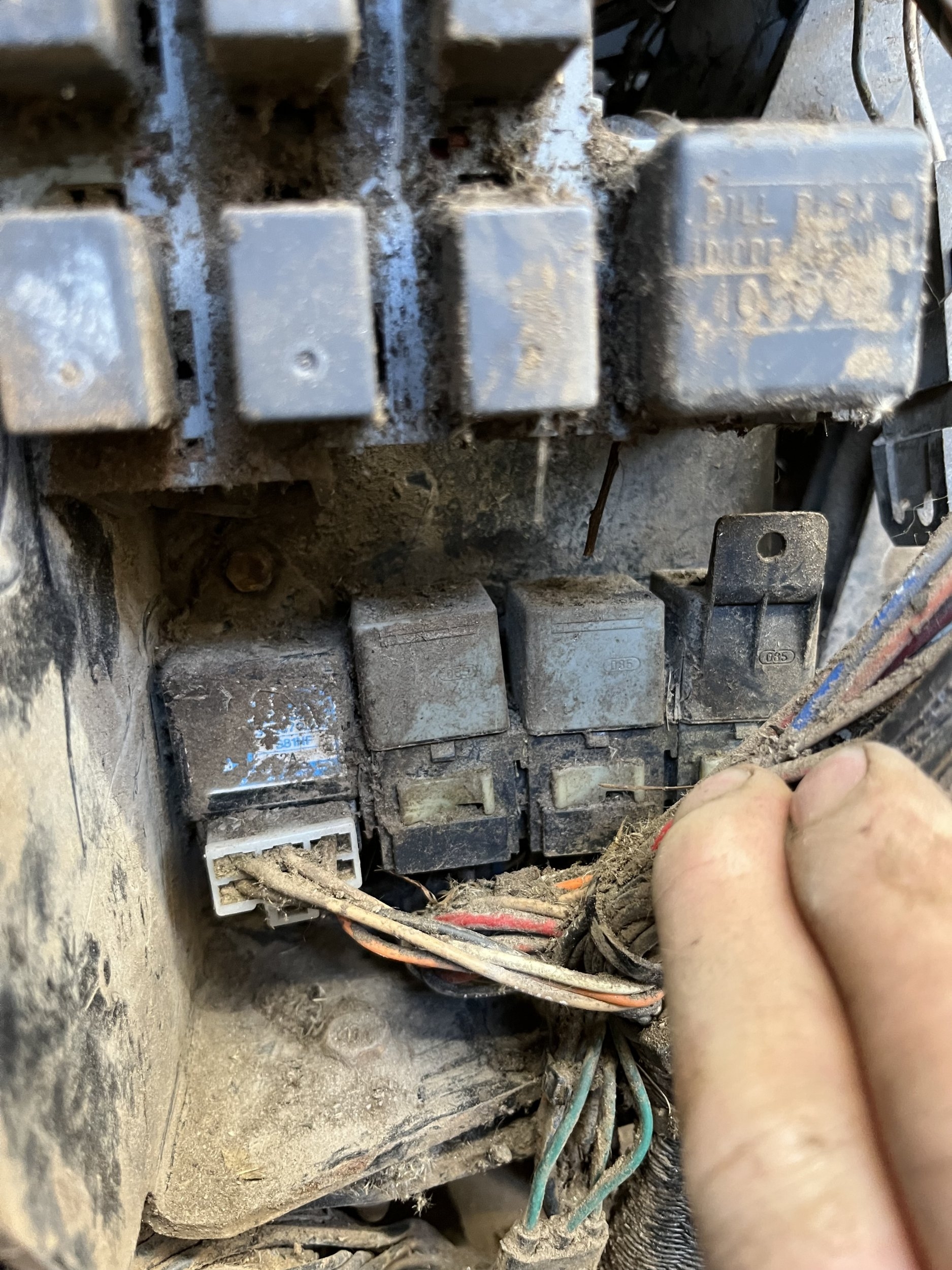

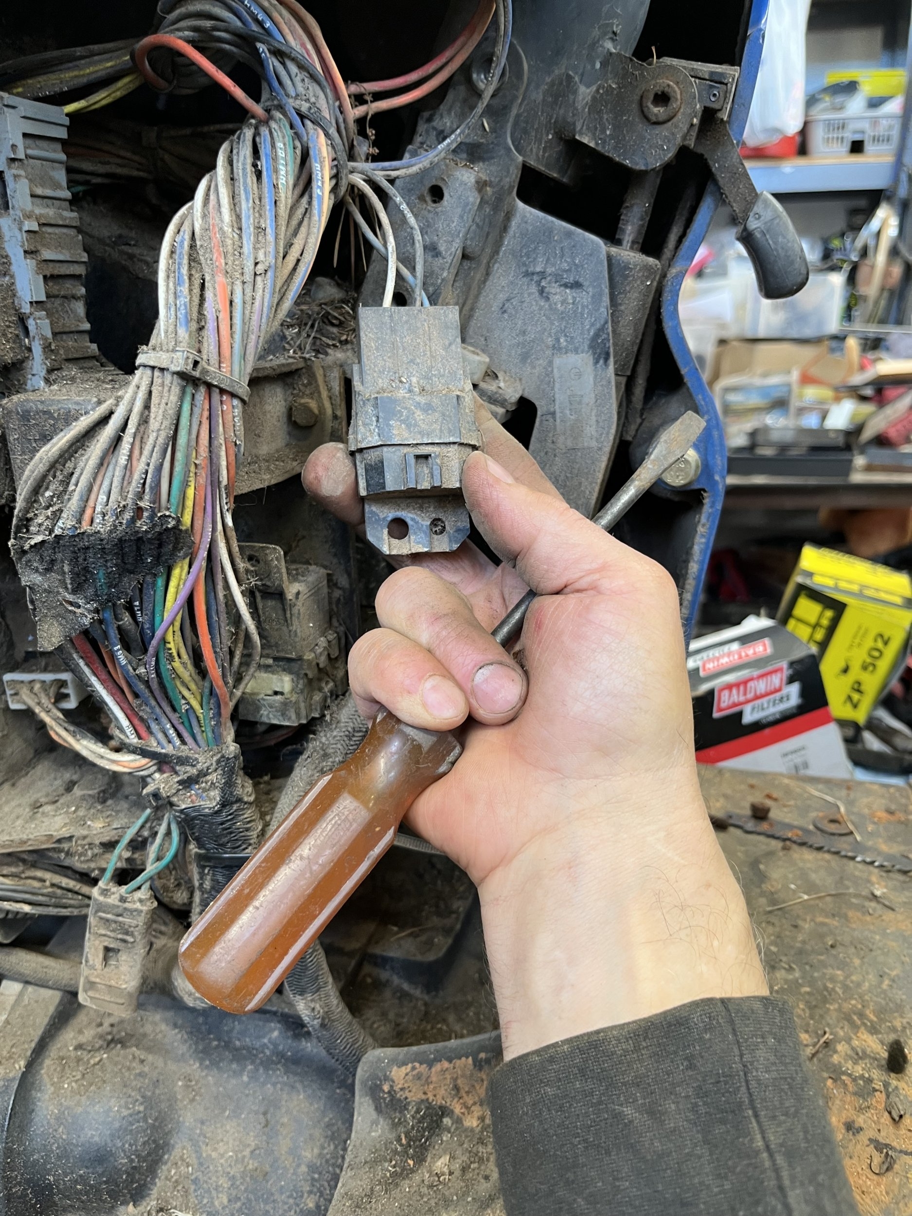

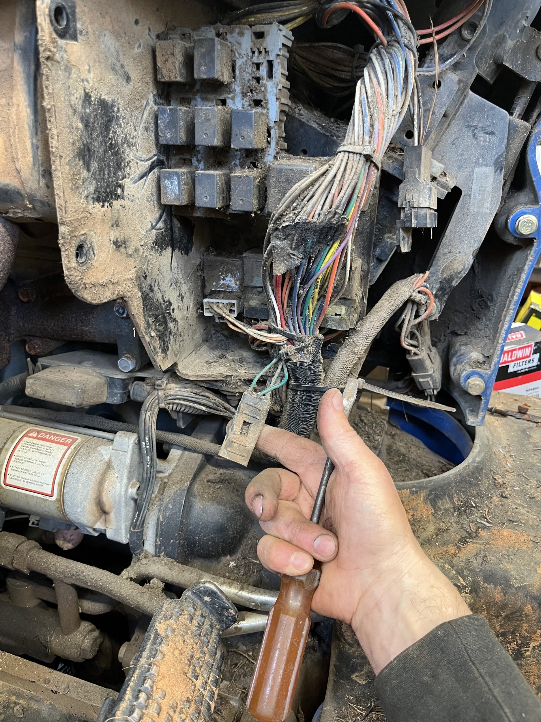

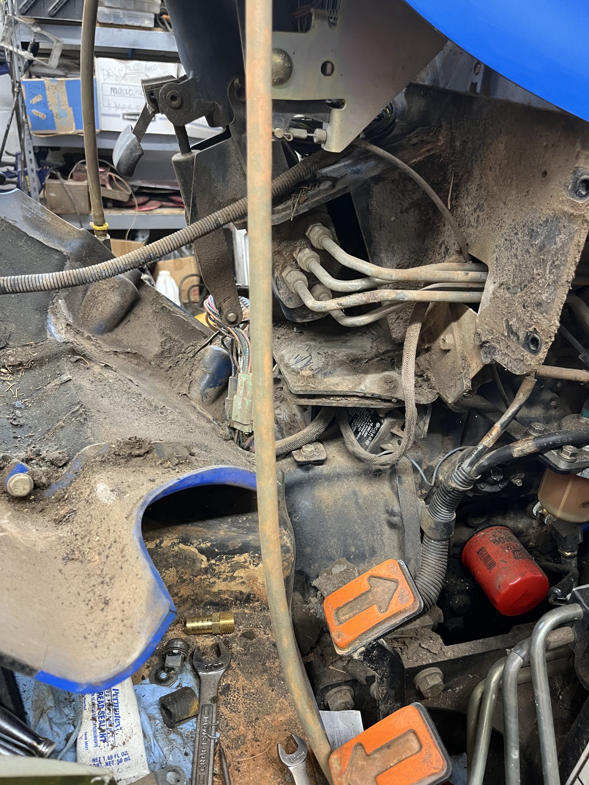

I don’t know what these two electrical plugs are for in the first two attached pictures of my TC45DA.
Also, in the last picture which one is the flasher for the hazard lights?

/ TC45DA Electrical Plugs #2
This might help:
  • DA Relay's.pdf
Thanks that covers all but the flasher unless it’s the diode #14.

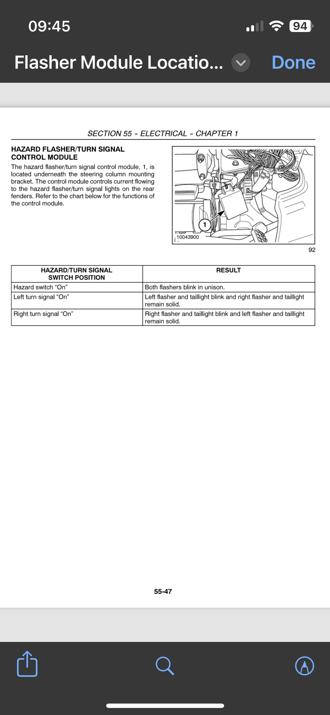

/ TC45DA Electrical Plugs #7
Here is the location of the flasher module:
  • Flasher Module Location.pdf
Looks like my tractor must have it in a different location than the service manual shows.
My TC45DA is a very late build, so it may have changed as they were changing over to the next series.
#9
Messicks shows it behind the dash, but the Boom 3045 newer series shows the same picture as thclimer posted. :unsure:
If the flasher costs what Messicks lists I’m not swaping it.

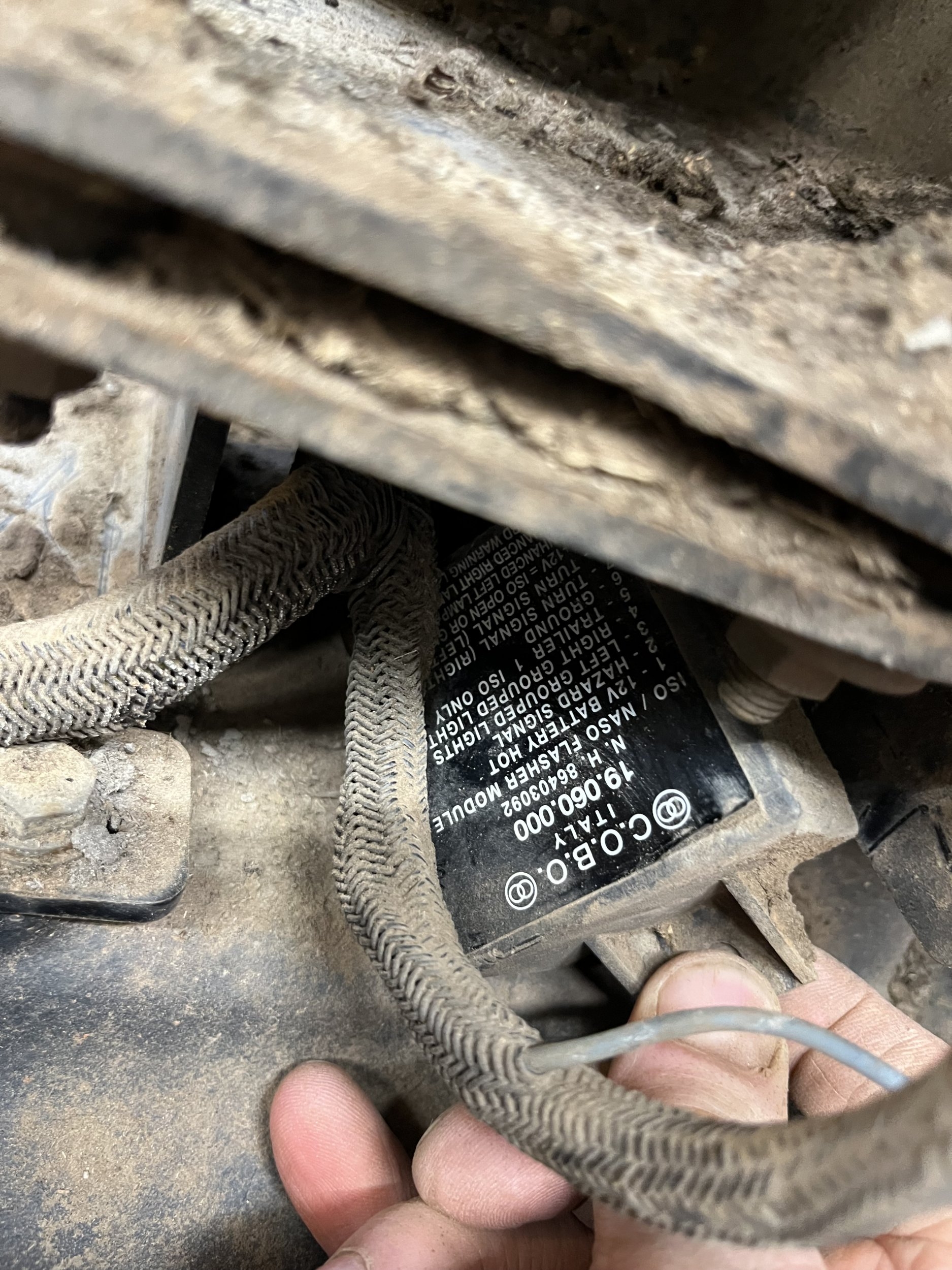

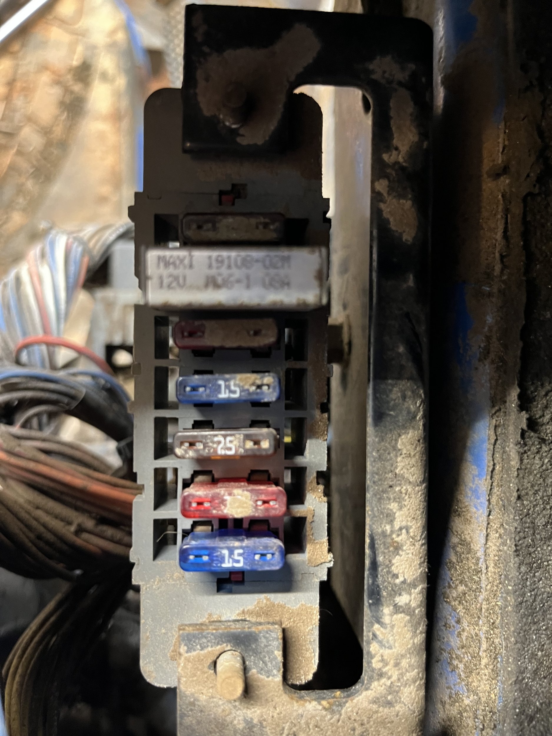

If the flasher costs what Messicks lists I’m not swapping it.
Well I found the flasher on the opposite side of the tractor.
Here’s a picture of the fuse box too.
The flasher appears to be an electronic too which is good.
#11
  • Flasher Module Specs.pdf
