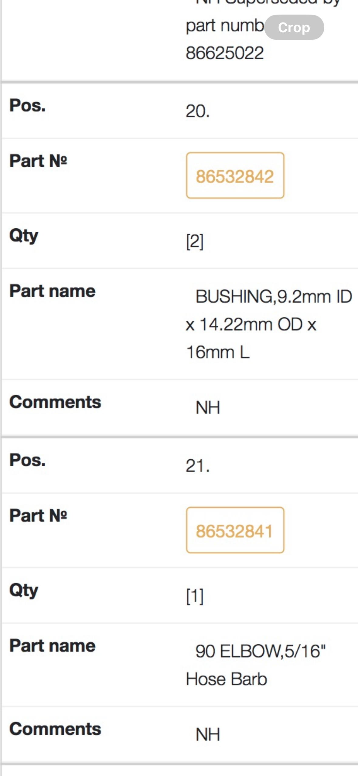

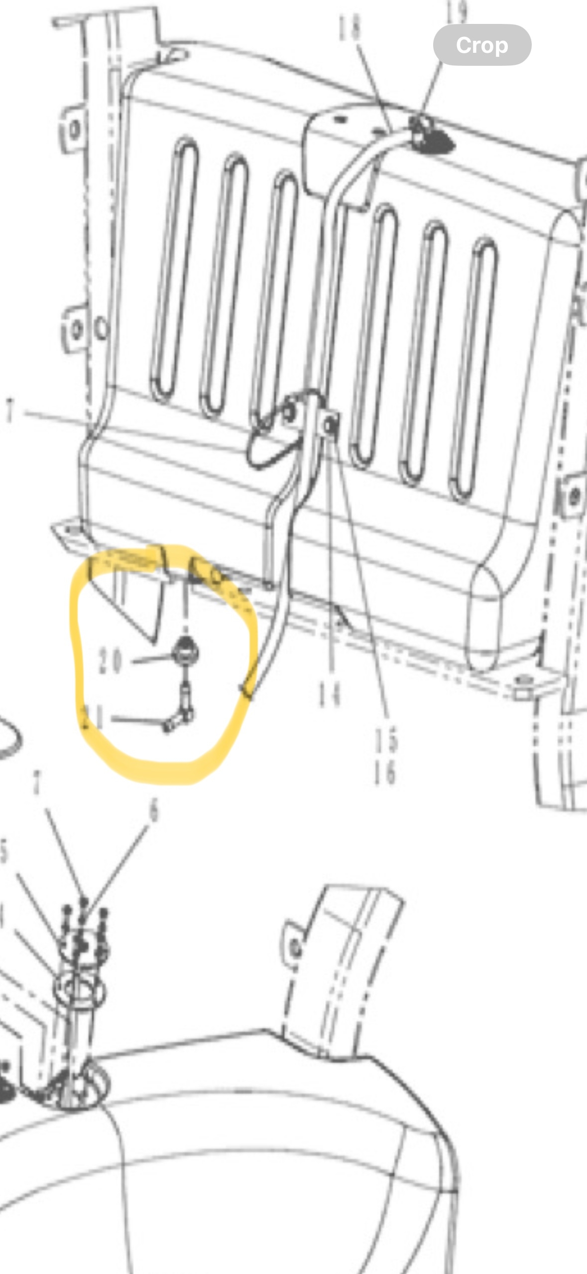

It looks like the fuel tank outlet on my TC45DA is a grommet with a barbed 5/16” fitting pushed into it. See attached pictures (#20 & 21).
Has anyone tried turning that barbed fitting to point to another location?
I am wanting to add a pre-filter to keep my factory filter from getting so dirty. If that fitting will turn it would make the filter fitment easier.

It is just a barbed fitting pushed into a grommet, so it will rotate, however I don't remember how much room there is to rotate it.

I wonder if twisting it would make it prone to leaking?
/ TC45DA Fuel Tank Outlet #4
I don't believe it will... I had our TC40D apart & replaced the fuel tank grommet & installed the fuel barb back in by twisting it back in... no leaks at all...
/ TC45DA Fuel Tank Outlet #5
If the OP is going to mess with it, he may want to install a new grommet too. It would be a good time to flush the tank out as he is having a problem with debris in the fuel anyways.

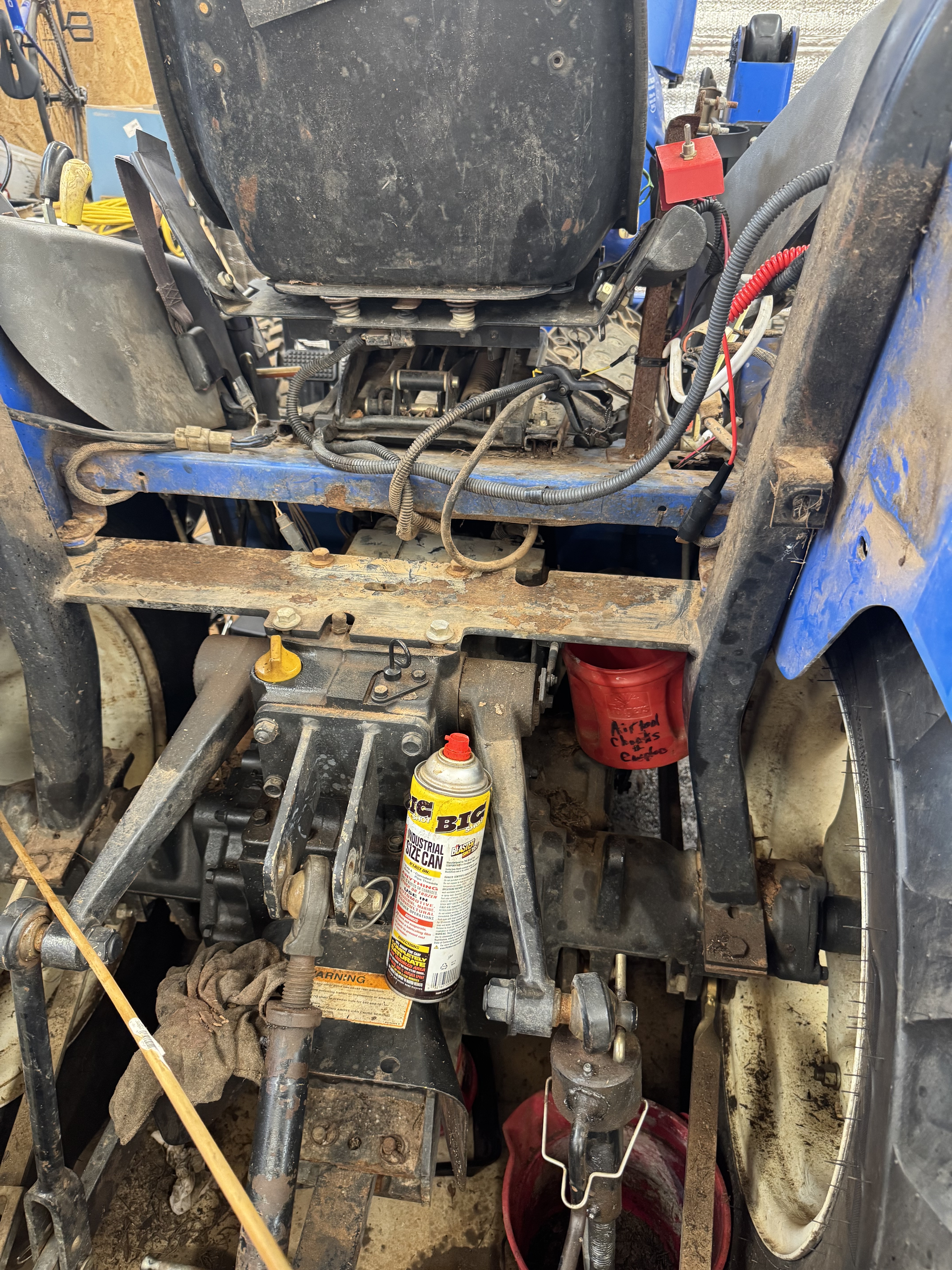

img_1206-jpeg.3209428
What’s missing?

I was surprised by how little junk/sludge seemed to come out since the supply line to the filter had plugged up before.
