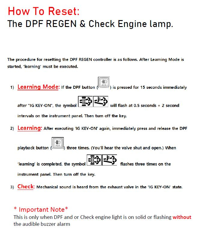

Yes, same lights, same tractor, only 10 hours after resetting, and neither TYM or the dealer care. I can not recommend anyone buy a TYM tractor. My first 2018 T574 had the DPF and MIL lights come on after using the brand new tractor for only about 10 hours. It was a 30 month ordeal with about 20 visits to my farm by the dealer and the lights coming on five times more in less than 90 hours that the PA attorney generals office was instrumental in TYM replacing the tractor in 2022. My 2022 T574 had the same lights come on a year ago with about 90 hours on the clock. My dealer and TYM was notified. Neither ever responded about fixing the tractor.
The great people at TBN wrote about a procedure to reset the lights. It worked. But now, with only about 10 additional hours on the clock, the lights are on again. I was in the middle of a one hour project unloading and moving pallets with forks when I got out of the cab to adjust the forks and when I got back in the lights were on. No fathomable reason what so ever.

On those engines if there is no Beep sound then usually the light just needs to be reset. of course if there is a defect somewhere then that might not help anyways....
