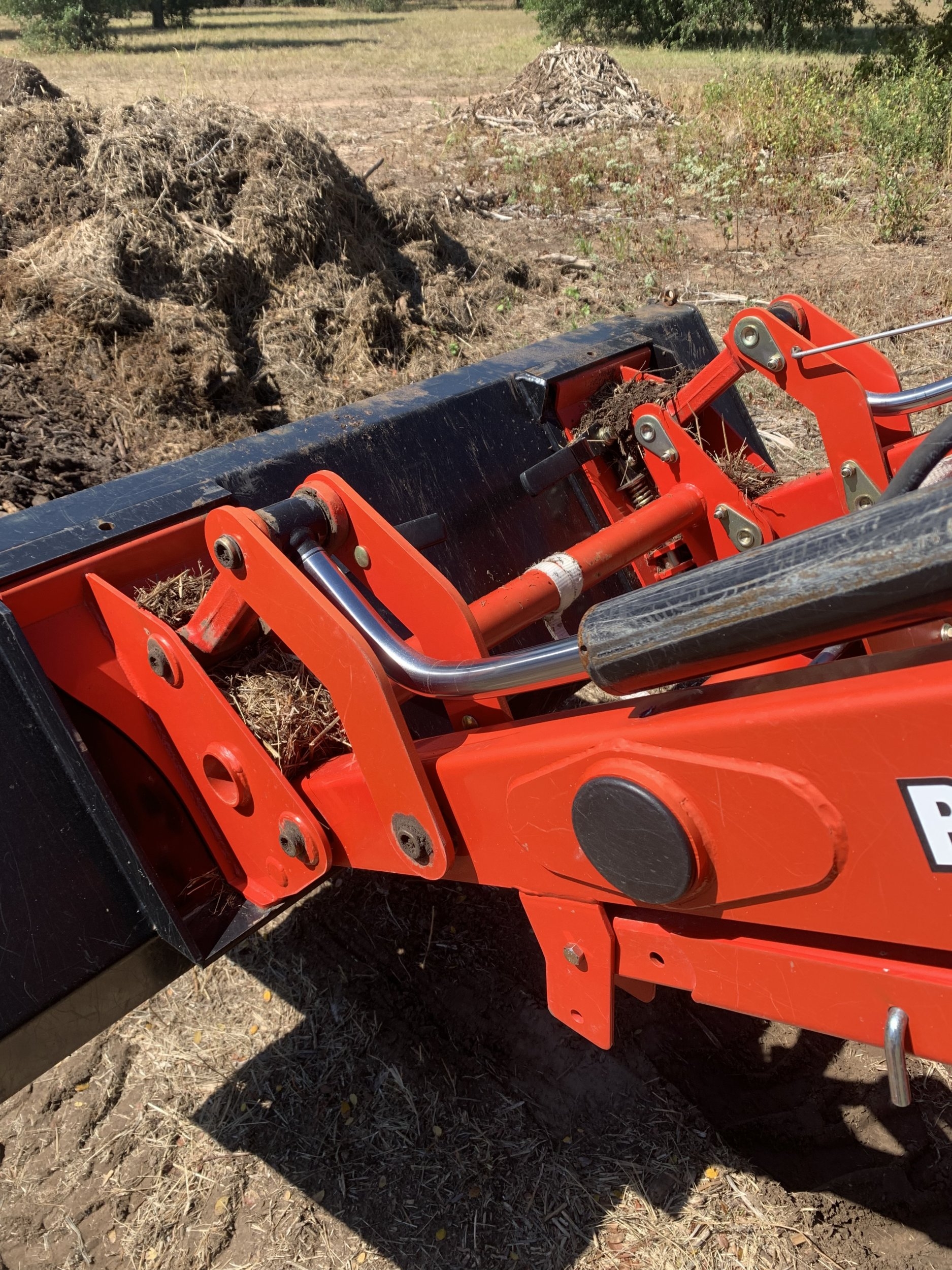

Couple of years ago I stopped by my local tractor dealer and looked at a Branson 3515c
basic tractor with cab and front end loader.
What convinced me to buy it was price was good and the 6 year bumper to bumper warranty.
Been pretty machine but recently had something happen that ive never had happen with any tractor.

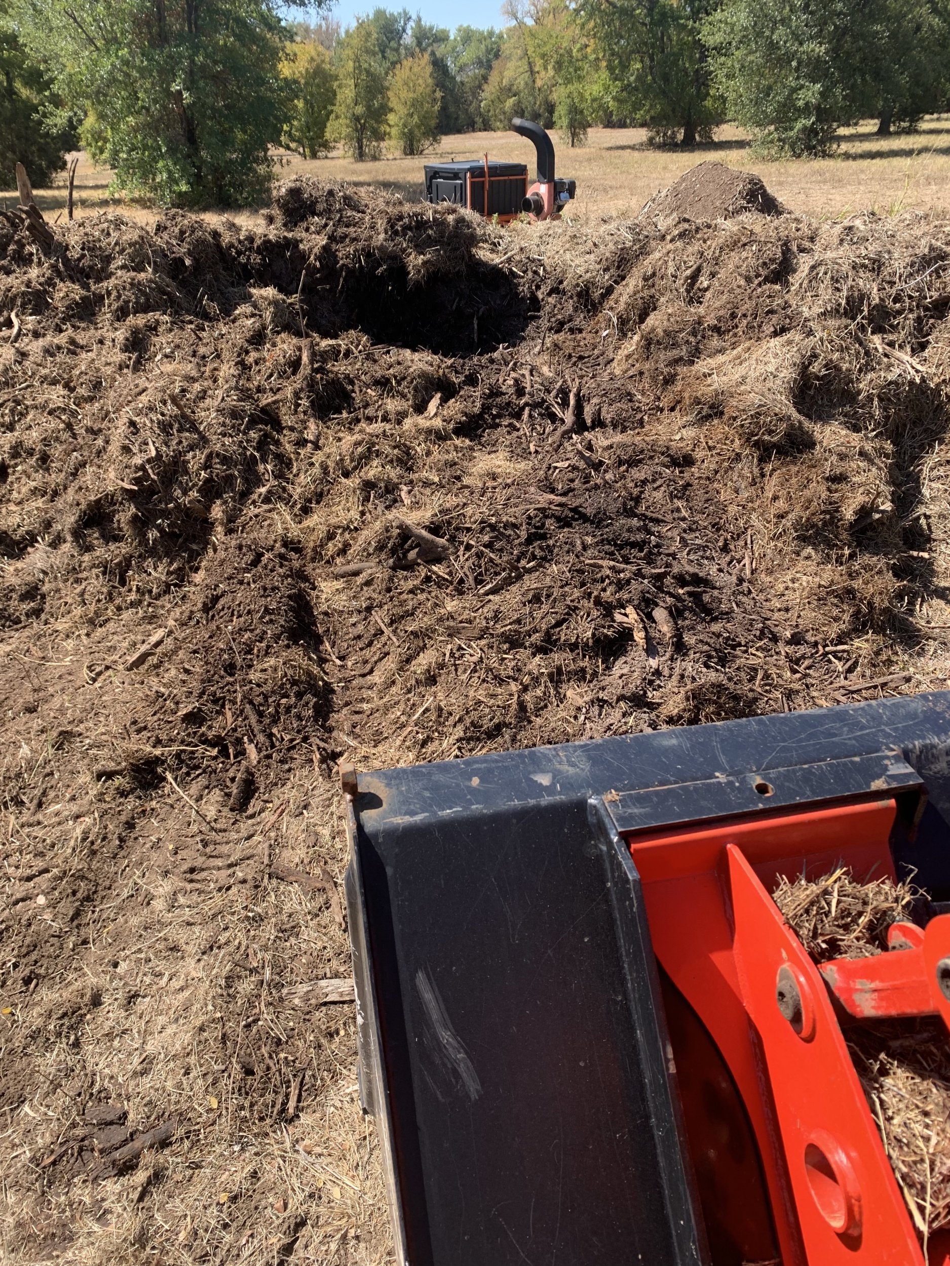

I was back dragging out material from my compost pile prior to scooping it up to be turned back into pile.
As i lowered the bucket into pile and started backing up the loaders drooped down
I thought perhaps the joystick was stuck to lower it, but when raised it up this had happened, the rams had bent 90 degrees.
Ive never had this happen before on any machine, from my 90 hp case to my farmtrac.
Called our local dealer, he went under.
As can only fiqure bad heat treating of ram shaft I called TYM whos merged with Branson.
Submitted at least 20 online complaints on thier site and never got any kind of response, phone or email
After two months of this a dealer called me out of the blue about two hours away. Said they got a call from TYM corporate and asked them to talk to me.
Turns out the so called bumper to bumper is drive line only not accessories.
Should never have believed sales man but ultimately said sorry no recourse.
So just a cautionary tale, dont expect any help from TYM on issues that are quality related, heck dont expect to even get a phone call from customer service.

Was it in the float position? I've seen this on other maks too.

No, had blade straight down
It does supposedly have a good warranty on drive line and my paperwork reflects it, course this was before TYM. But not even a phone call response is pretty poor customer service.

What gets me is ive been in construction 40 years and have back drug everything from concrete to stone to dirt, you name it and never bent rams like that on any make,,,
Especially just on cow poop and hay

That is not bending,,
the rod is acting as a column,, totally different.
The column length (height) is the rod PLUS the length of the remainder of the cylinder.
That ends up being a VERY long column.
It is kinda like putting a 4 foot pipe on your 3/8" ratchet,,
DANG, the stupid rachet broke!!!
backing up with the bucket pointed down, creates a tremendous mechanical advantage.
If the cylinders had only been extended half as long, the column height would have been half,,
The cylinders would have survived.

As Cadplans said ..."backing up with the bucket pointed down, creates a tremendous mechanical advantage."
The issue is not supporting the weight of the tractor, it's the back dragging the bucket through the dump linkage geometry that overloads the dump cylinders. Even with construction equipment, the best practice is to use the heel of the bucket to back drag.

The warranty very clearly states that it is for the tractor. Not uncommon at all.
The back dragging issue is well documented on all brands.
