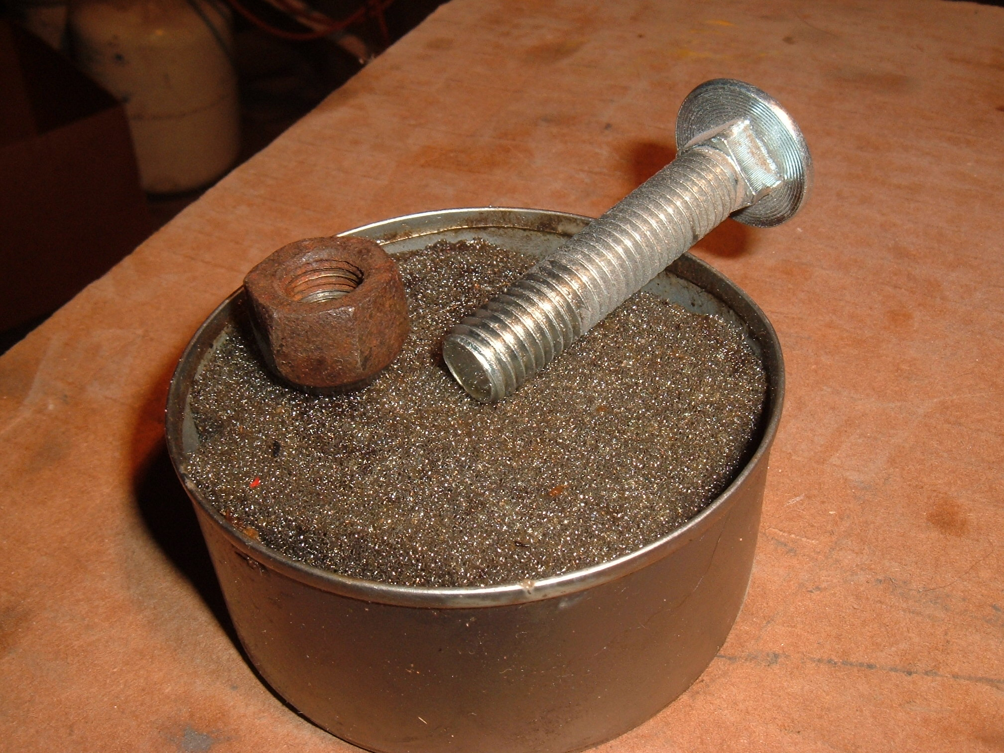

The main reason they doi not oil, first it allows a lot of creep on alum wheels, drives them too tight, second trying to train a whole country of chimps working on cars to do it the same right way is a problem. Torque isnt really accurate and being dry actually makes it worse, threads stick and while they stop turning do not clamp properly. Take any old bolt, dry or some simple spray, same for a C clamp,,, seem obvious but guess not. John Deere fastener manual should be required reading for anyone work with bolts.
