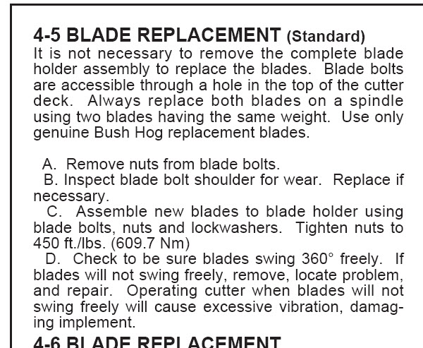

Torque multipliers do work, but I don't know that you need to put out a couple hundred just to get these bolts loose.
I vote for heating the nut and spinning off with your impact. Manual doesn't say but they may be prevailing torque nuts or deformed or distorted thread nuts, these can be a bugger to get off.
The torque multiplier may be of use putting the baldes back on if you don't have a torque wrench good for use at 450 Lb/Ft.
Always good to RTFM (Read The Fine Manual) if you have one. If not it's available here.

I got a Bush Hog 3209 cutter, and I'm trying to get the 1 5/16" bolts off that holds the blades on as I'm replacing them.
The 4 nuts have been soaking in PB blaster for a week, but neither my 3/4" impact wrench (being feed from a 1/2" hose @ 150 psi), nor my 3/4" ratchet with an extension will break any of them free.
