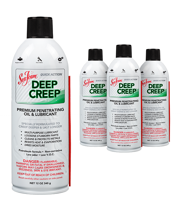

Other than Deep Creek, the next solution without breaking the lug off with the nut is using an angle grinder. It's a little chore, but careful cutting will get the nut off enough to split it in half exposing the threads. When I get 'close enough' a screw driver to pry the nut apart works.
Yes, I've owned Dodge's like this. Those cheap lug nut chrome covers trap in moisture on the steel nut that is totally untreated, thus it swells with rust inside. Deep Creep works when it can get into that tight area and soaks into that rust. It's a gamble every time I come across this event.
There are a few companies that offer SOLID replacements. Those may not be fully chromed, but they are polished and treated. Better than the 2 piece OE versions.
I went with McGard nuts to replace the stainless wrapped nuts on my Dodge. I got tired of nuts getting stuck in the socket. USA made and practically guaranteed not to rust.
