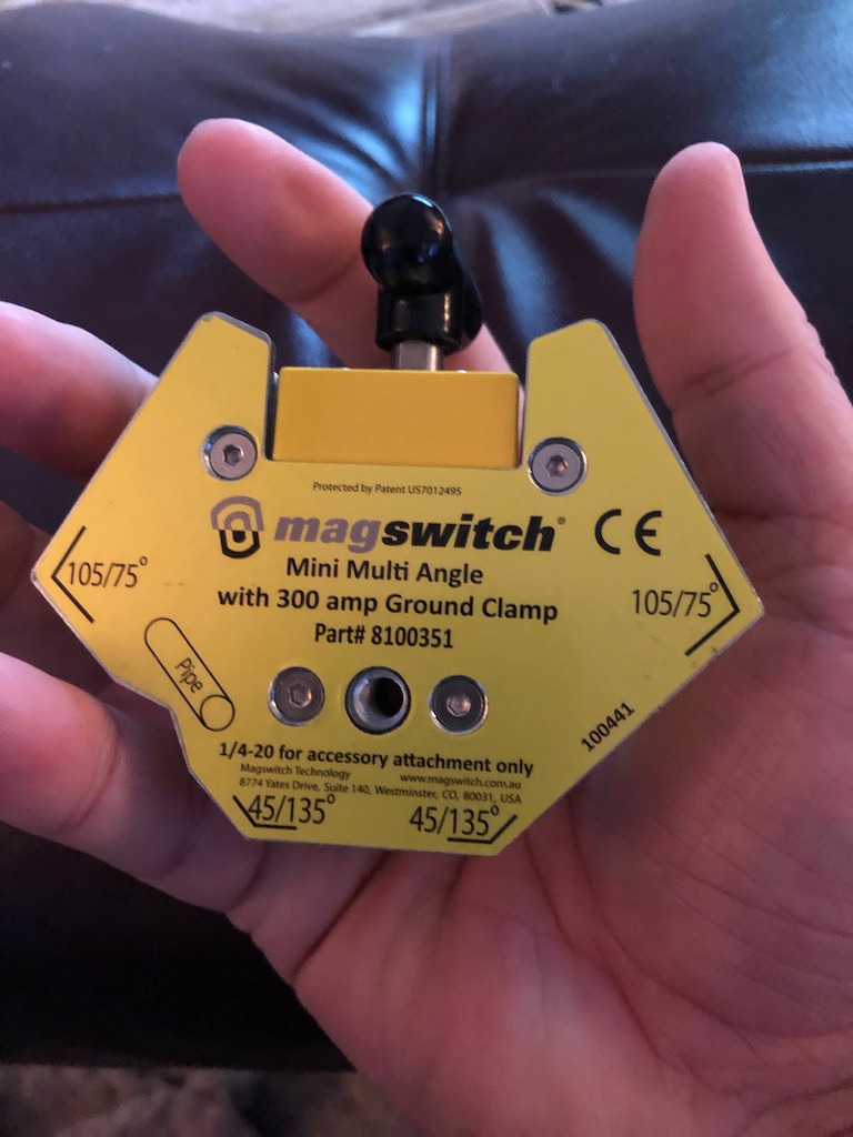

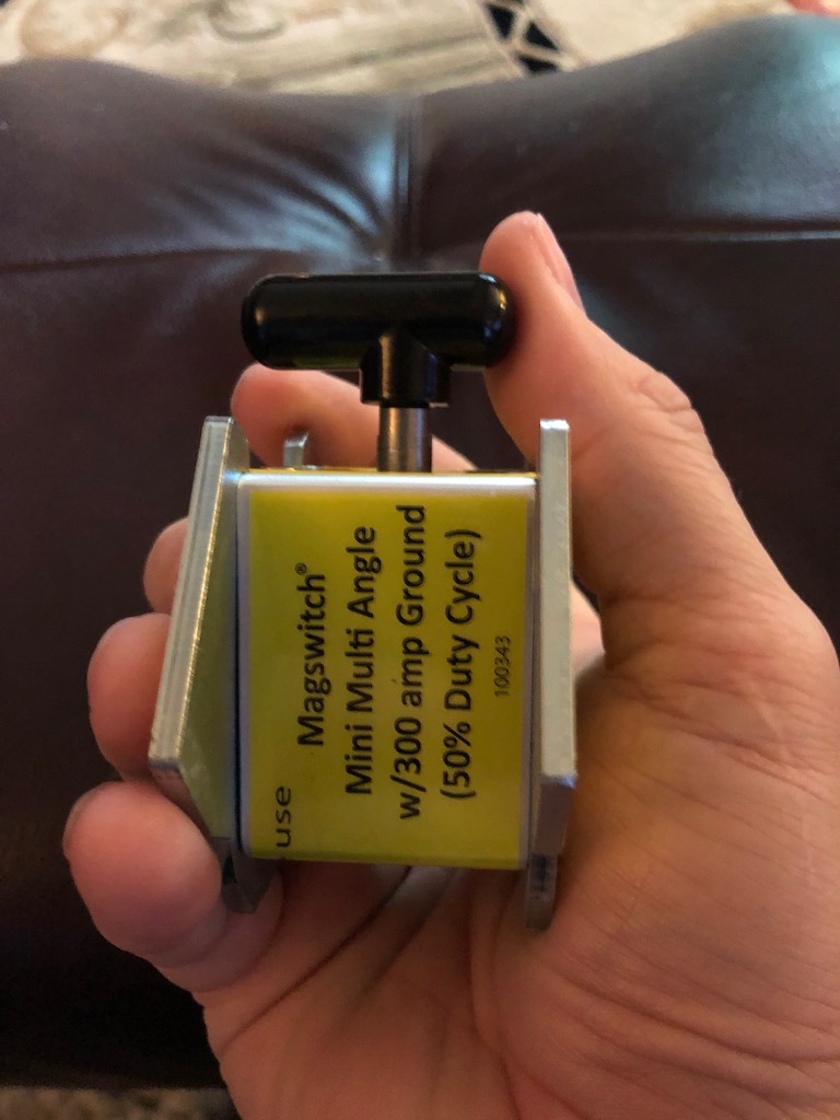

My initial assessment of the magswitches.... Cool! :thumbsup: I bought two of the mini mag angles and they are indeed small and aren't so aggressive that I can't break the hold while 'on' but I think they will be great for light fab work. I easily held up vertically a 2ft section of 2in square thick wall tube to my weld table. The angles will make it easy to tack on the inside of T's and L's right next to the magnet.
The width of the block is about 1 3/4in so these would not be very handy if your work piece is narrower than that. In that case the cube style might be a better choice and I might get a couple of those too! I can see that for large plate and beam work the next size up would likely be necessary but as I mentioned before, now you are over $100ea.

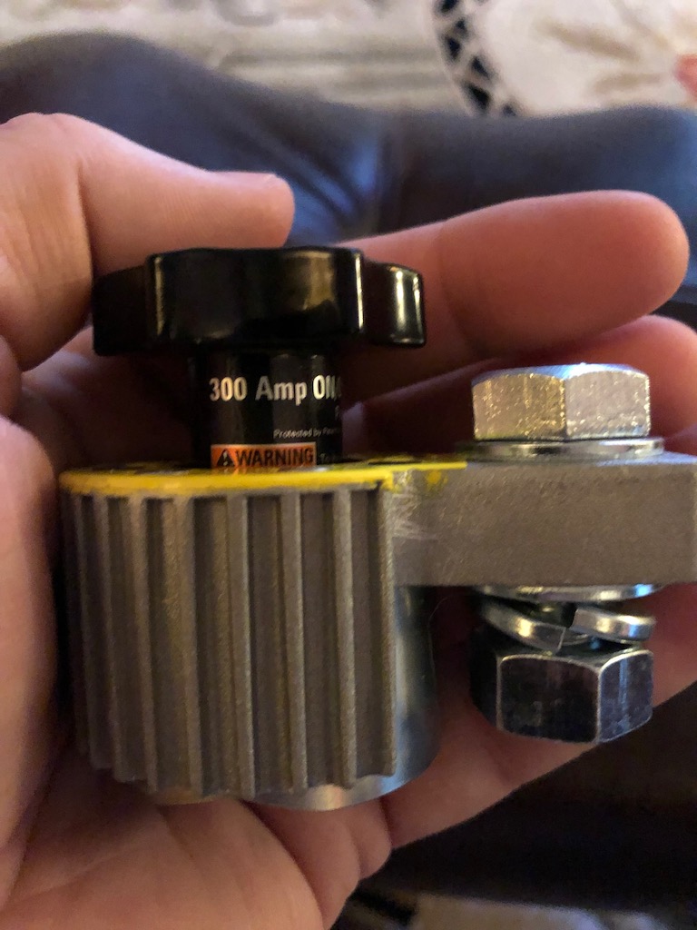

These can also double as a ground clamp rated at 300amp at 50% duty/ I just don't think I would want my ground wire that close to my weld area due to the clutter factor.

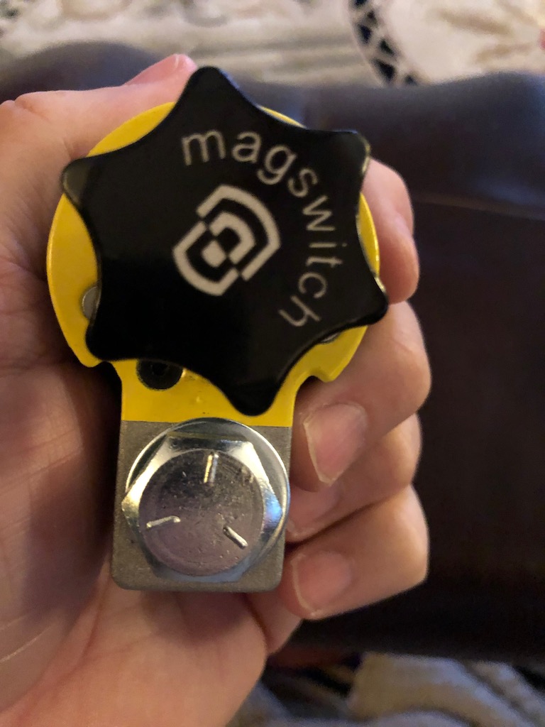

I also bought the dedicated mag ground clamp. Now this thing has some serious holding power! My only quibble with this is that the bolt to connect to the ground wire looks to be a 7/16 diameter and I will need to replace the smaller ring connector on my existing ground lead to my MIG welder. I also noticed that my Hypertherm plasma cutter has an integrated ground clamp, meaning I would have to cut it off to replace it with a mag switch ground so I probably won't be getting a second one. That said, I really like the build quality and I think I will really enjoy using this... no more trying to figure out where/how I am going attach my ground clamp.

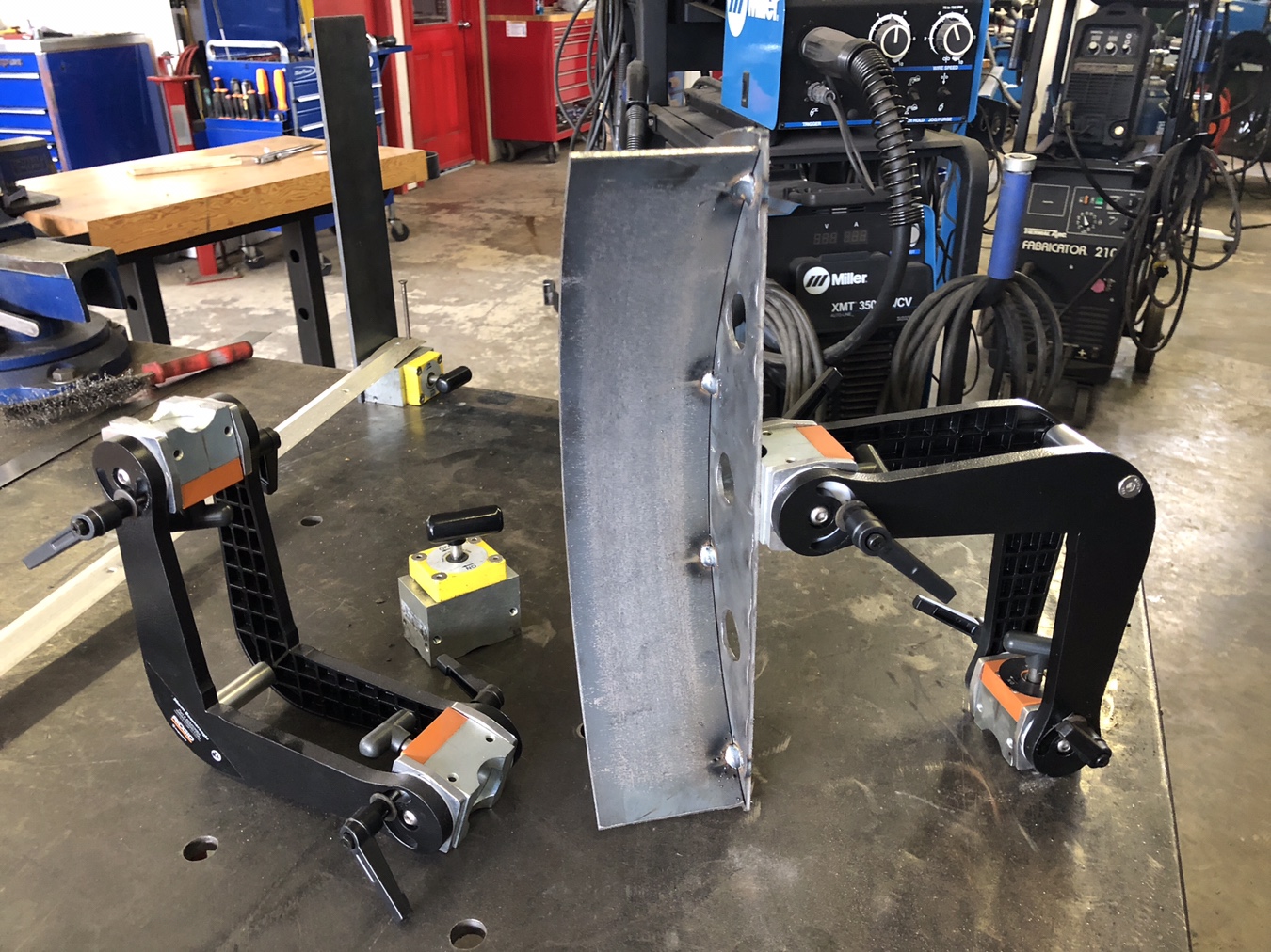

A pair of Magswitch squares at work today.
