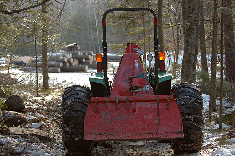

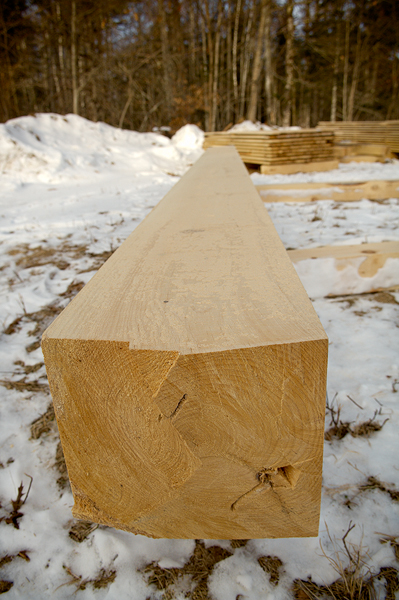

Another follow up after widening the stance and adding chains. The wider wheel base has made an enormous difference in stability. Most of my property in on a slope and before widening the wheels I had some serious clenching moments. Now it's a whole new ballgame. With the new chains we were able to make a road into the woods for cutting and hauling the Pine we've been harvesting for about a month. Even when we had snow, there was virtually no place the tractor wouldn't go.
Here's a shot from earlier in the project and one showing the current progress. We're primarily cutting timbers for a timber frame building and the sawmill can handle a 24 foot log without turning it. But we need 3, 26-footers and the mill operator was some impressed that the 4120 could pick the entire log to place it on the mill. Pretty impressive performance for a compact.
