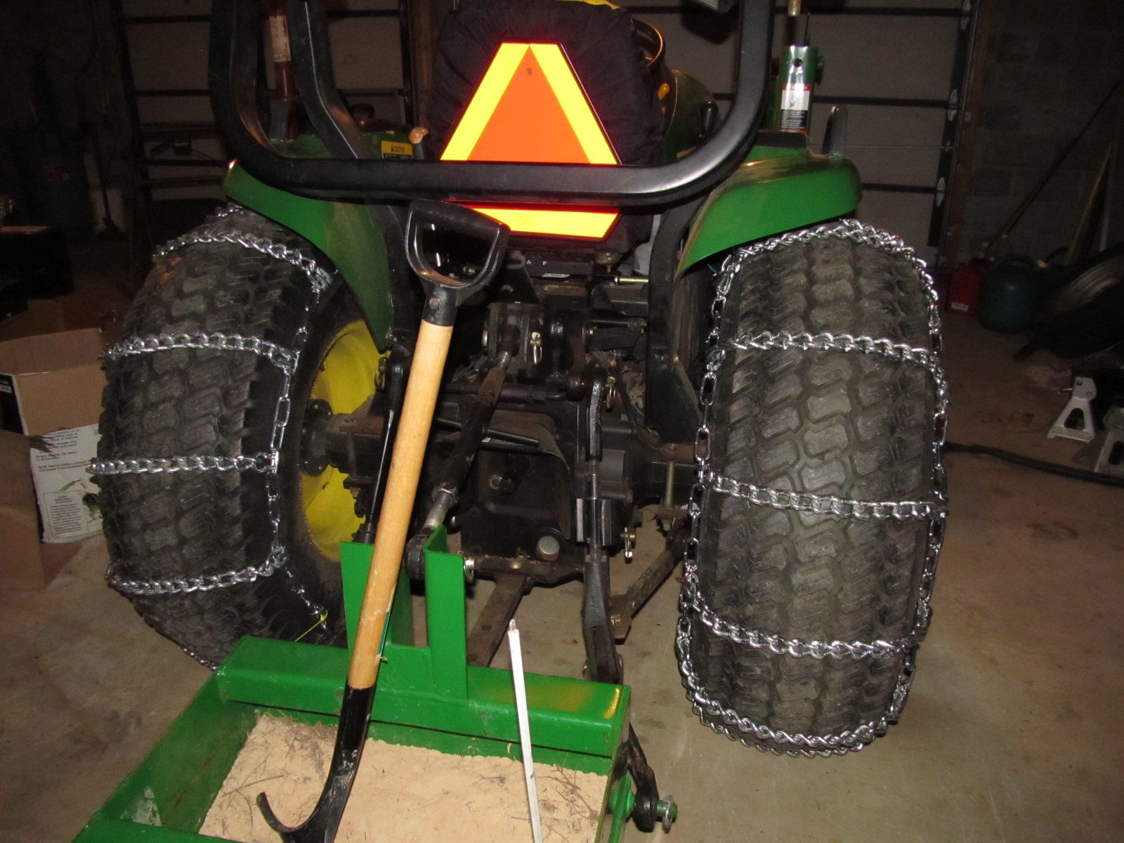

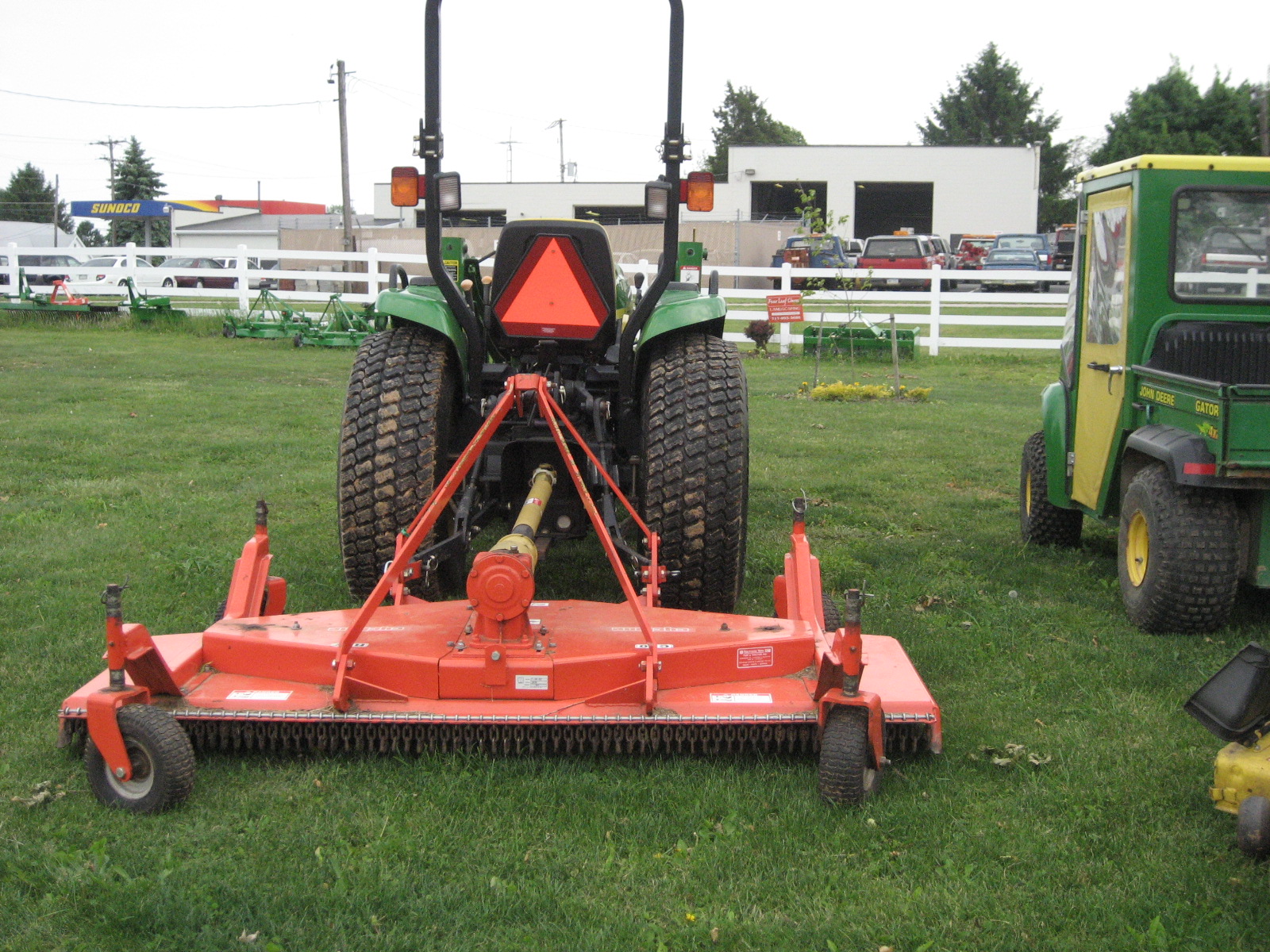

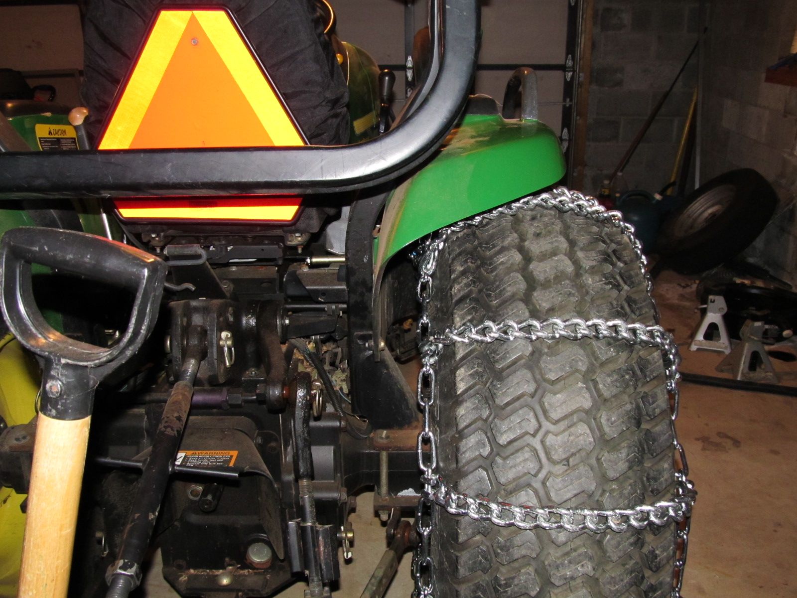

Here's an example of what you can expect before and after reversing (or swapping side to side) rear tires. This is mostly directed for folks who want to install tire chains (which is why I did it), but also those who want a bit more spacing for stability. This is applicable to turfs, but you should see similar results with R-4 tires). The tires are 41-14-20 turfs.
The first pic is of my 4400 (actually on the dealer's lot right after I bought it) with those rear turfs in factory stock position. Not much clearance for chains, eh?
The second and third pictures are what you can expect after reversing those rear tires (this is, of course, on a Deere 4400. You'll get the same results on 4200, 4210, 4300, 4310 and 4410 tractors...other Deere models and other brands may have different results but I expect very similar results with the 3120, 3320, 3520 and 3720).
Well, now I'm ready for that snow storm...

it looks to me like you have a slightly greater increase then i have on my 4300 w/ R4's. in narrow, it looks like your turfs are closer than my R4's where and when reversed the space looks about the same as mine. either an illusion or a slight difference on the dish of your rims?
i might have gained 1" per wheel (if that), but it's enough for chains. i went for the 2 link ladders....man are those heavy.

I got at least 1.5" per side. I'd guess the offset on the wheels used for turfs is a bit greater then those used for R-4 tires. I'm pretty sure wheels used for R-4's are wider then wheels used for R-3's.
I know about the weight of those 2-Link chains! Arrabil brought his over when he helped me swap my tires around. His drive is paved and pretty steep so he has 2-link chains front and back.
I went with 4-link ladders (as you see in the pictures) since my drive is pretty level. The 4-link chains are pretty heavy too (I'll estimate 70 lbs each).
