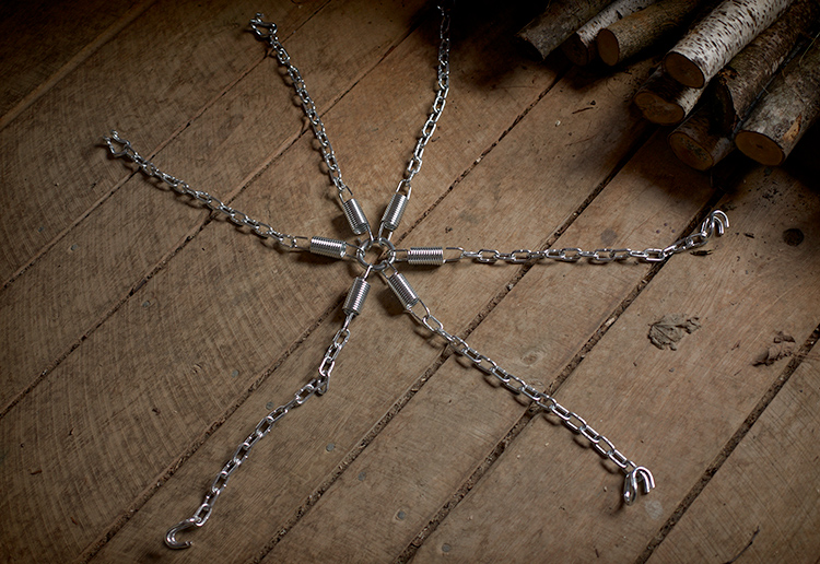

Thanks brin. I should have been more clear, the floor in my barn is 3" thick hemlock. The boards have cupped a bit and the gaps between them are varied and wide. Running small wheels over them is a challenge. But since I live on the side of a hill, the barn floor is about the only level place I've got. This pic should give you some idea, although it doesn't show the height differences.

Nice chain tensioner!
Though it would work to move a single tire/wheel.
