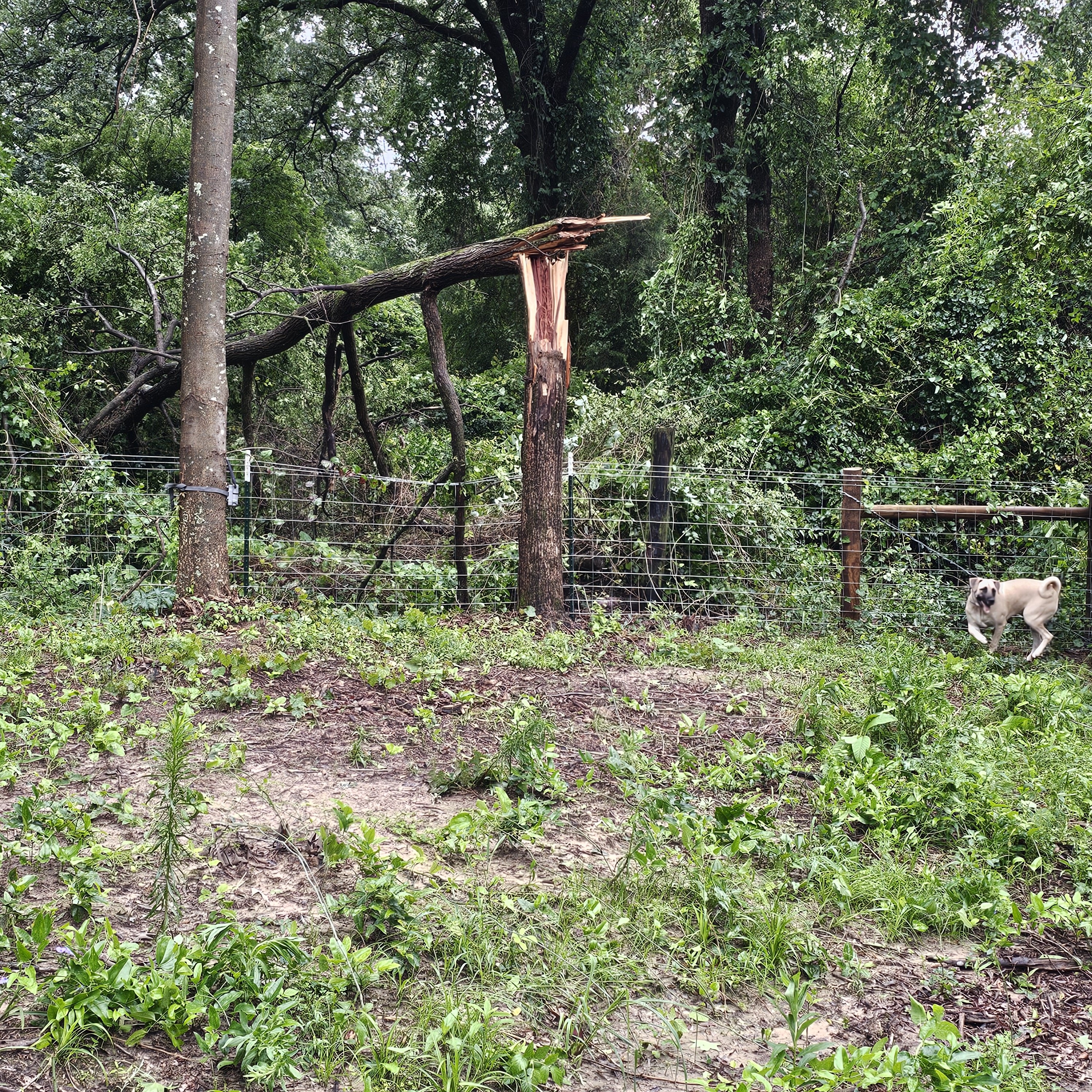

We had a pretty bad storm come through Sunday night/Monday morning. Lots of downed branches and trees. A guy not far from here was killed by one falling on his mobile home.
We avoided any really bad problems, but lost some mid-sized trees. This one is threatening to crush part of my new fence...suggestions?
It should be a simple extraction. Cut off the limbs near the stump as high as you can reach while the treetop still supports the weight. Then start cutting the top in pieces and work your way back, cutting small pieces at a time. Small blocks at a time is all it takes.

That would be simple, but he'd like to avoid crossing the fence entirely, which complicates it and leads to 5+ pages... so far.

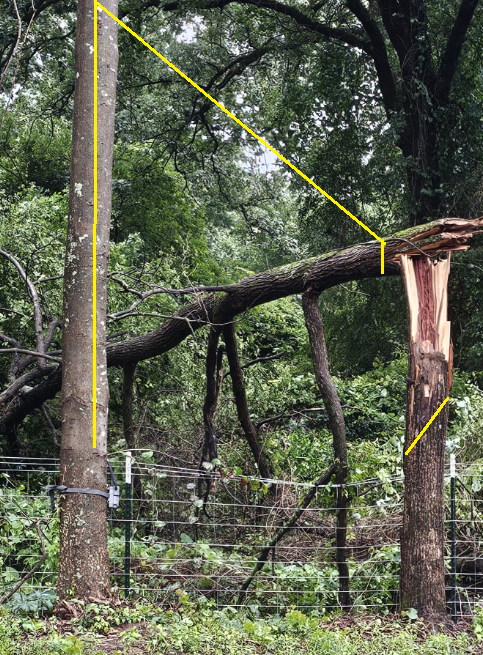

This is how I would deal with that.
Put a block as high up as you can in the adjacent tree and a winch or block to redirect the rope at the bottom.
Start cutting the tree at the top and work your way towards the break as far as you can.
Keep tensioning the rope.
Cut the damaged tree on an angle, there will be end bind so you may need a wedge to prevent it.
Keep lots of tension on the rope and keep tightening as you progress.

Hmmm...it's a property line tree which fell from storm damage with 100% of the part of the tree that fell on the other guy's property. In rural PA, that would make it the responsibility of the guy whose land it fell on to clean up.
It's neighborly to offer to help, but not expected. It would be different if you were in the process of cutting it down and the tree went the wrong way, but it was storm damage on a property line tree. Act of God.
Ask the neighbor if he wants help, and ask that he not destroy your fence while he cleans it up.
Likely, he'll invite you over to his side to help.
It's a remarkably easy take down, especially with a grapple and your size tractor. Not sure why so many suggest dismantling the fence first! Took more time to write this post than it would take to cut out the downed trunk at the hinge.

Looks simple start limbing from top back to the trunk. You could also tie rope around the trunk were it split so top trunk does not drop to ground.
Also look to be good time to introduce yourself to your neighbor get permission cross onto their property. Offer the cut wood to your neighbor.

I have done a lot of this stuff doing residential tree work. We would use a throw ball and small line into neighboring large tree limb…attach bull line to small line. Pull bull line through and loop at the break…bull line slack gets taken off TIGHT…further cripple the break and detach..begin bucking and limbing in small increments..might need a directional line on it to insure movement.. this is is a two man show. There is risk always but that is why you hire a pro

Is the downed tree one of those stringy elm trees? Looks like a continuous run of fence through the corner and so no easy place to just remove some staples and roll the fence back.

that's actually a good idea (y)

I just walked backed there as part of our evening walk. That other tree has a broken V that I could maybe use. There are no other branches to use. A little further down, I have huge oaks, but they are too far away to be of help. I need to clean up the trail back there and I can check the height versus my grapple.

At my age? Call our local tree service, owned and staffed by young men with climbing gear, boom truck, chippers, etc., etc. They are licensed, bonded, insured. I would have them take the broken part off and leave the trunk there sticking up. They will take the wood away or leave it for you to turn into firewood. I have many similar down in my back pastures that aren't hurting anything. The one you show may or may not hurt the fence. Don't let it hurt you.
