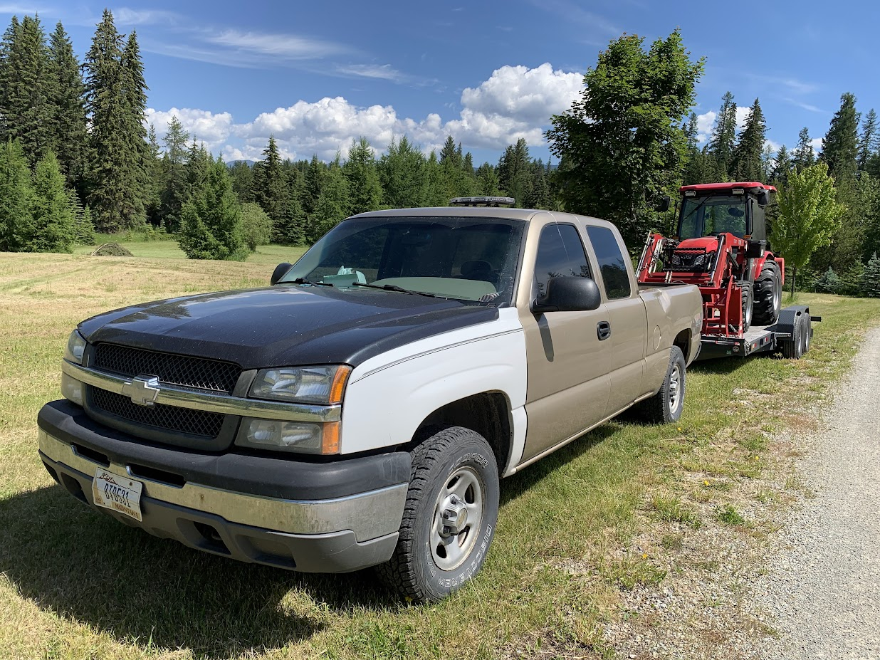

My tractor weighs 4600# and I have a 20foot 10k trailer that I tow with my halfton with heavy duty factory tow package. It works really good, I've towed it for thousands of miles like this for my mowing jobs.
