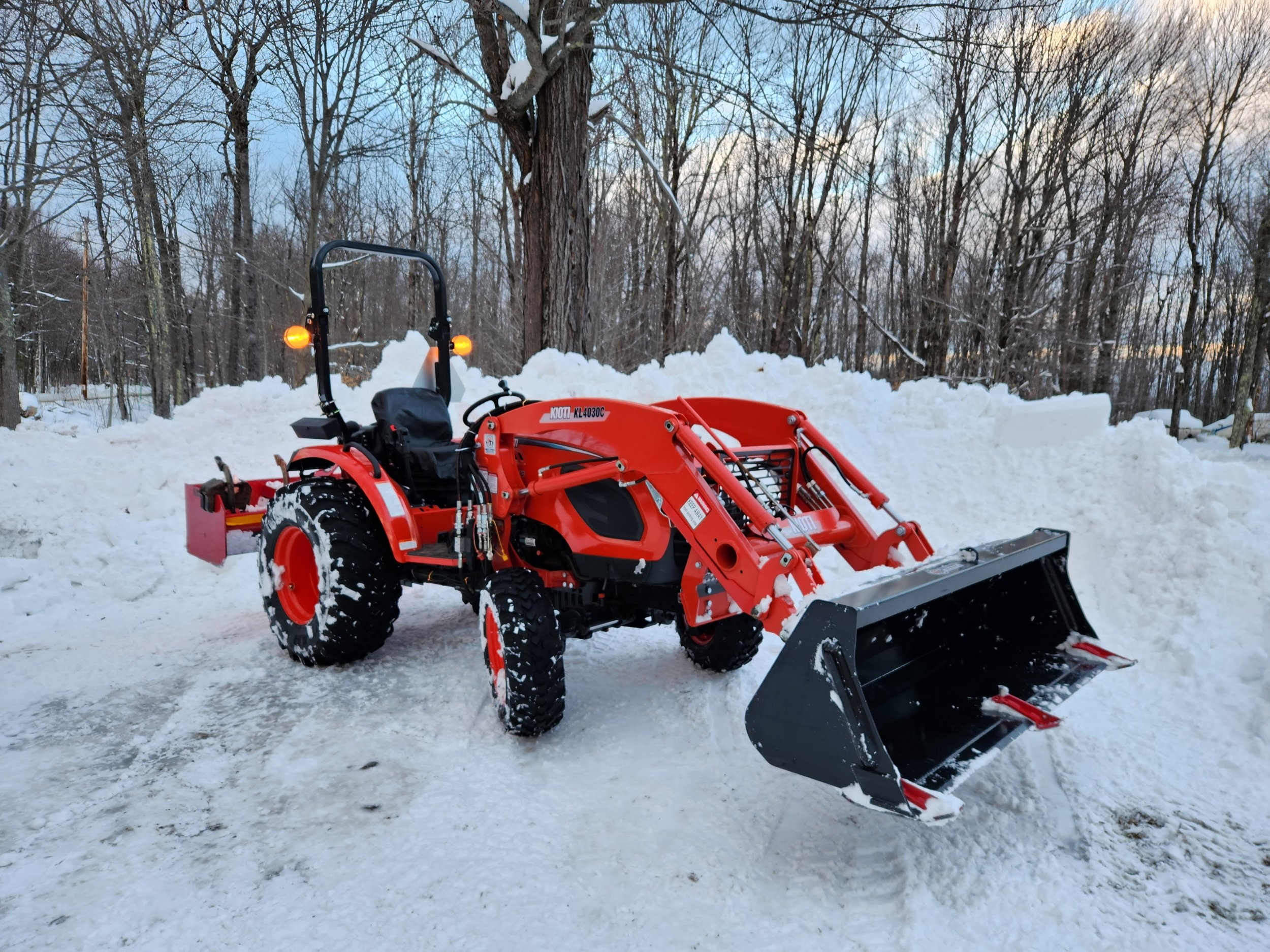

I have 14 acres of pure pasture with a home. I do just fine with my ck3510. I pull a 1000# 72” flail, and the loader does whatever I want. Power is not an issue at 35hp. I also till; in heavy clay soil I can struggle to pull a 5’ 8” depth tiller (either go slow or two passes at partial depth).
I was a lifetime surburbanite snd this is my first tractor. I bought value and features for the $, not “the dealer”. I’ve only been back three times - once with the tractor early for a hydraulic leak, once for them to do my 50 hour service, and once to pick up parts he ordered when a part of my 3-point broke. I did my 200 hour service myself. I disagree with those who say dealer is most important - I don’t “need” my tractor to make a living, so as I said I bought value and $; after 4 years and 350 hours I have zero regrets
One final note. I can pull my whole tractor loader and flail with a 7000# trailer at max capacity behind my 2005 f150. Had I gone bigger I would have needed a bigger trailer and bigger/new truck. So if I had gone to the kioti dk series I would have not only spent an extra 3-5k for bigger frame but 3-5k more for trailer and 20-50k more for a truck. It has to stop somewhere….
