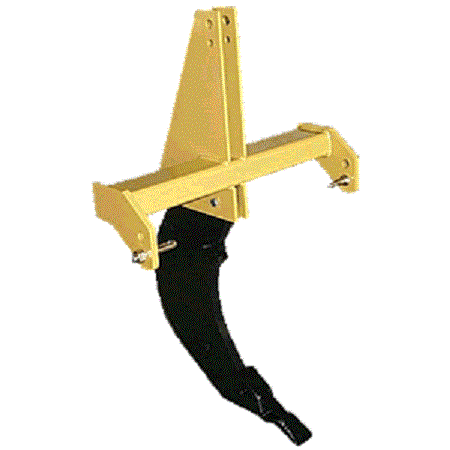

I ended up ordering a small, reversible subsoiler. If it will lift a 300-pound rock up to where I can get it with the loader, it will be better than gold.

I ordered a subsoiler, and I picked it up a couple of days ago. I put it on the tractor and hooked up on the rock. It would not budge. It was probably hung up on a root and whatever rocks were down there with it. I turned the tractor 90 degrees and tried again, and the rock came right out.
Fortunately, I had two large guys here with me. They rolled the tractor into the bucket, and now it's part of my collection of big landscaping rocks. The bucket groaned a bit. Heavy rock.
I would say it's about 30" wide and 20" across.
I didn't turn the subsoiler around to face forward because I was lazy. This made it harder to disengage once the rock was out.

Interesting fact about the subsoiler: the shear bolt appears to be metric. I busted it on a stump, and when I compared it to imperial bolts, it was somewhere between 7/8" and 1/2".

What are the markings on the head of the bolt?

The bolt head has these marks on it: "SC" and "BB."

This bolt has a shaft about 0.470" in diameter. Don't know the thread major diameter.
I don't think it matters. It's so close to 7/16", I'm not worried about it.
I see I said 7/8" in my earlier post. Brain flatulence at work. I meant 7/16".

12mm = .472" so I would say it is a 12mm and the thread pitch could be 1, 1.25, 1.5, 1.75mm
7/16 = .437"

I completely forgot that a manual came with this thing. The bolt is M12 x 85mm.

Sub-soilers will pull up rocks. And roots. And buried wires and pipes.
I was using a subsoiler to trench for an invisible fence. Things were going swimmingly. After laying wire and working my way around, I looked back and saw that I had somehow pulled about about 75 yards of the wire I had just laid.
