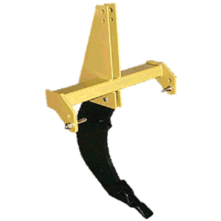

There are different kinds of subsoilers. One is the $150 version that is lighter duty and will handle smaller rocks. The HD one is around $750 and will rip up anything a 125HP tractor can handle. I have used an HD one for years and ripped out rocks that must have weighed 500-800 or more pounds and no problem. The little one will bend with too much force so be careful but the heavier duty one is something every rock farmer should have.

Here's what I use on my compact Yanmar. This little thing is a beast especially for the price. I've opened up several new deer food plots with this little ripper. It's also pretty handy on stumps up to 4-5" after you get the hang of it.
td
Titan Hitch Mounted Ripper
/ Subsoiler for Yanking Rocks? #13
Here's an internet pic of one that is HD and can handle big rocks. Use with 40ish HP and up. Otherwise, smaller ripper is OK.
Smaller ones will break shear bolts endlessly or bend. Other implements like scarifiers also easily break shear bolts or bend.
I've got a large HD ripper/subsoiler I pull behind my 4x4 68HP Kubota.
I'm working in the woods right now so there's no way to get my cab tractor where I'm going w/o a lot of extra work.
I got the small hitch mounted last week and I've already got about 10 hours on it so far w/o destroying a single shear bolt. It appears to have a slight twist in the shank but maybe that's my imagination. I haven't put a straight edge on it so I can't be 100% positive until then. I'm really impressed with my new ripper especially for the price compared to other rippers I considered.

"Rock farmer" would be funny if it wasnt true. I have been trying to consider my 800 lb rocks as "decorative" and leave well enough alone. How heavy a tractor does it take to pop one out with a deep chisel?
I mounted my HD single shank ripper--like the one in post in #13--on either of two tractors. The first was a Kubota 43HP L4300 and the second was a Deere 5520 @ 89HP. For the L4300 I could pop out maybe up to 400 lbs depending on how the rock was shaped and how hard the ground was. For the Deere I could easily pull up and out maybe 800 lbs. It wasn't hard on the tractor and I think I could easily have done more with either tractor. I also have a small 7' backhoe and sometimes need that to get an awkward rock out of the hole. With a perfect flat rock I'll bet I could get 800 or so lbs with the L4300 and maybe 2000 lbs with the Deere. It all depends.
You can also rip out stumps after you know what you're doing. I mostly ripped out cedars and either tractor was fine. The Deere would also handle bigger stumps, especially if they had started to rot down a little.
Over the years I tried all sorts of ways to pull rocks and backhoes would be first but are very time consuming. The HD ripper I think is best because you can rip and go and do it in a hurry. Box blade teeth and scarifiers shear too easily and only intended to scuff dirt. When you dig rocks with a ripper, keep the tractor straight. When you don't pull in a straight line is when you bend things. We lived in glacial till New England so I had a lot of practice.
