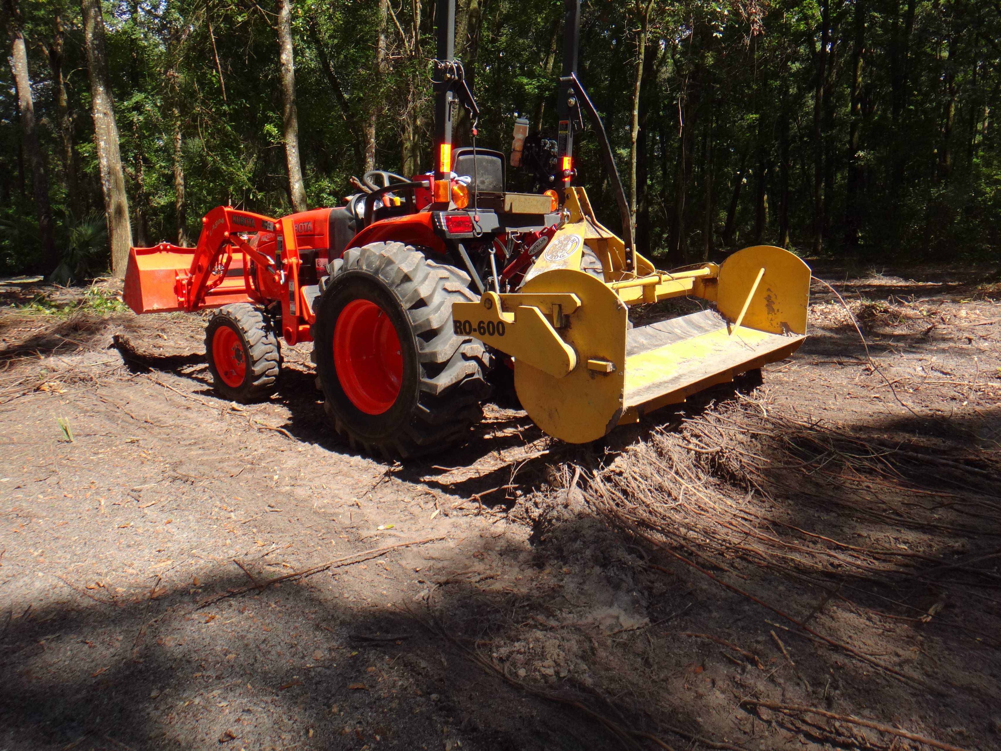

I would get a box blade with ripper teeth for vines and the such. Drop all the tines down and suck the top link in. You can cover alot more area useing this vs a single tooth. It also has other uses as a box blade.

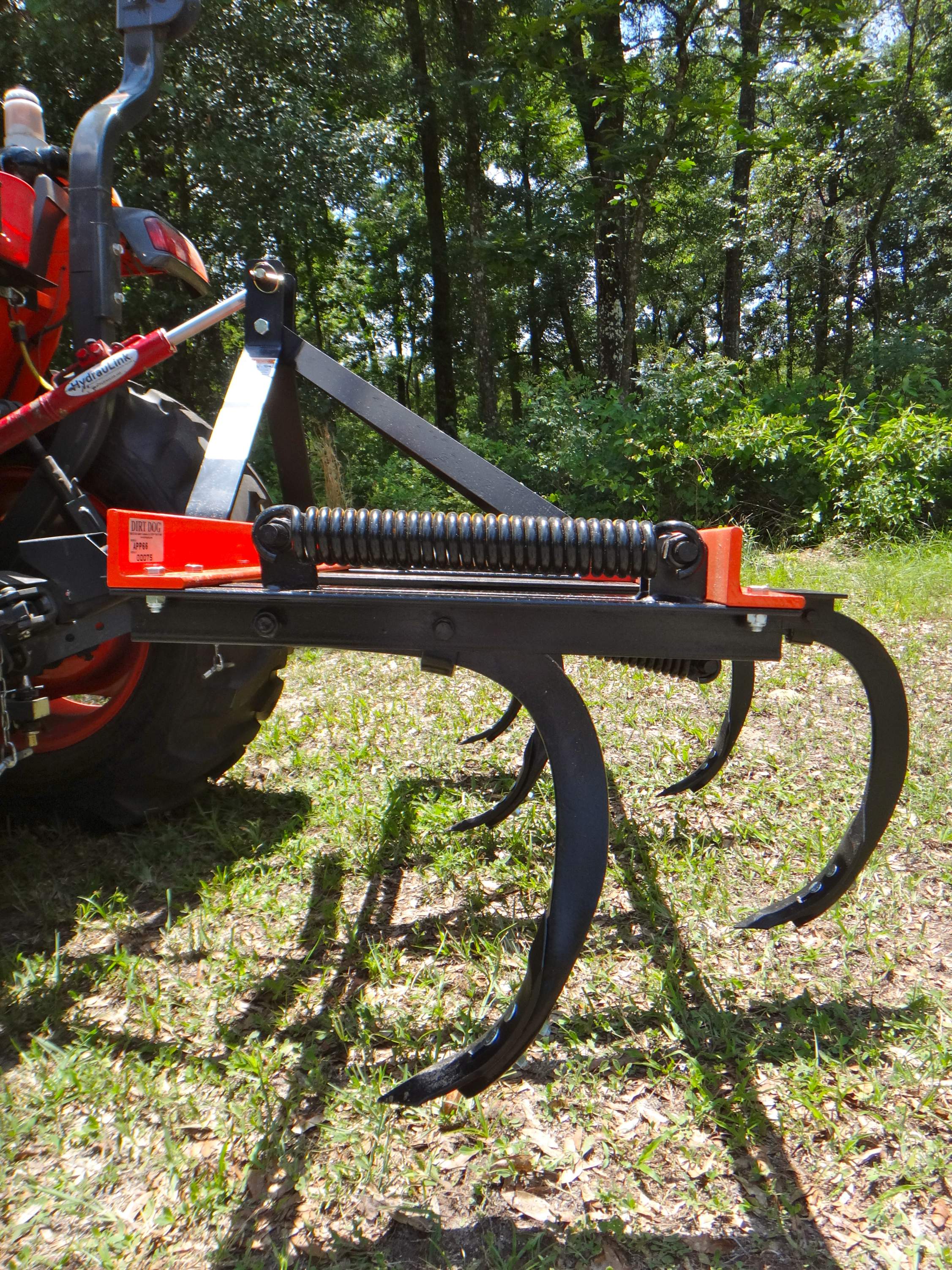

I've done that.
Box Blade shanks are broad and straight, designed for chipping asphalt. High draft force resistance. So it does not take much of a root to stop forward motion. When I removed three shanks, leaving two, one snapped off at the pin hole. $50 with shipping. Shank penetration for my Box Blade about 5".
The photo shows perfect soil moisture for pulling out PENCIL DIAMETER roots with my Rollover Box Blade.
APP tines are thinner and parabolic shaped, so the tine points pull horizontally through the earth. Much less draft force resistance. More residual power for pulling out roots.
APP tines are protected by individual reset springs. I have snapped off one replaceable tine point which reversed to a second point. (( Double ended point $7 delivered. ))
Never have broken nor distorted a spring protected tine.
Tine penetration 12" to 14".
This is what an APP will pull out of Florida sandy-loam for an operator with two days experience.

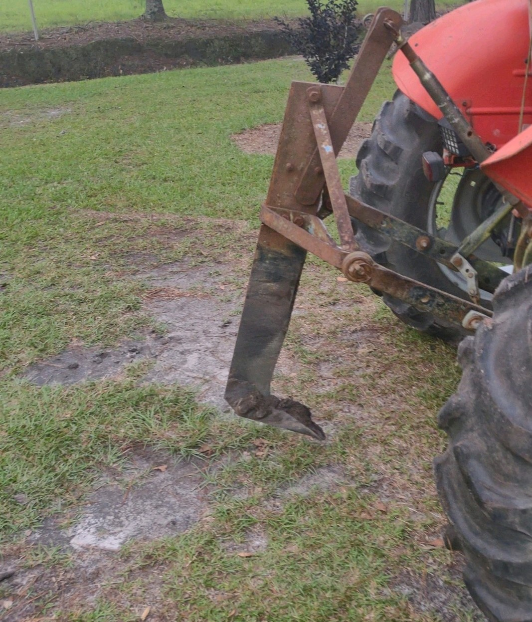

I used EA's subsoiler to trench 150' in the root infested woods :) A couple of large ones stopped me but one or two more passes ripped them apart.
Here is what it looked like just after assembly. Comes with a shear bolt.
