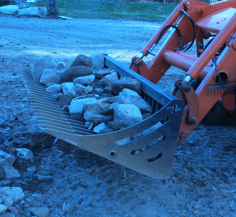

My first buckets had flat laser cut bottom slats which looked fancy and aggresive - but worked poorly. The one that worked best has round tines with a bend in the front and it definitely longer front to back
Yep, sounds like the Bradco that EA sells:
But I need closer tines for saving gravel.

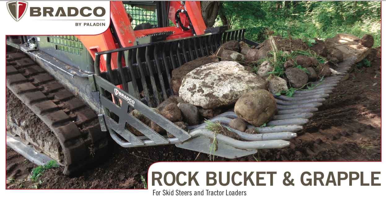

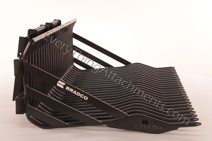

Which bucket did you find works the best and is it a dedicated rock/skeleton bucket or does it include a grapple?
The one I like is the Bradco - although they used to make the points in a chisel shape that worked noticibly better than the centered points they use in one of their pictures.
Bradco makes a special grapple just for their rock bucket. That would be a nice combo.
Houle also makes a similar bucket. As far as I know, both have 3" open spacing.
But be warned.... the Bradco & Houlebuckets cost slightly over twice what the laser-cut buckets do.
I'll attach a picture of the Braco and Houle adv. and also a screen shot photo of the bucket I bought for $900 that didn't work as well - but sure did cost a lot less. It's the one I loan out. 4" spacing...but for some reason the rocks don't roll in as well and the dirt doesn't fall through.
That what I meant when I said that subtle differences make a big difference in how they work.
Interestingly, some of the bucket pictures seem to show a chisel point and some a round point. Look at the 7th one from the near end on the Bradco photo. Now THAT looks like a proper flattened chisel point.
