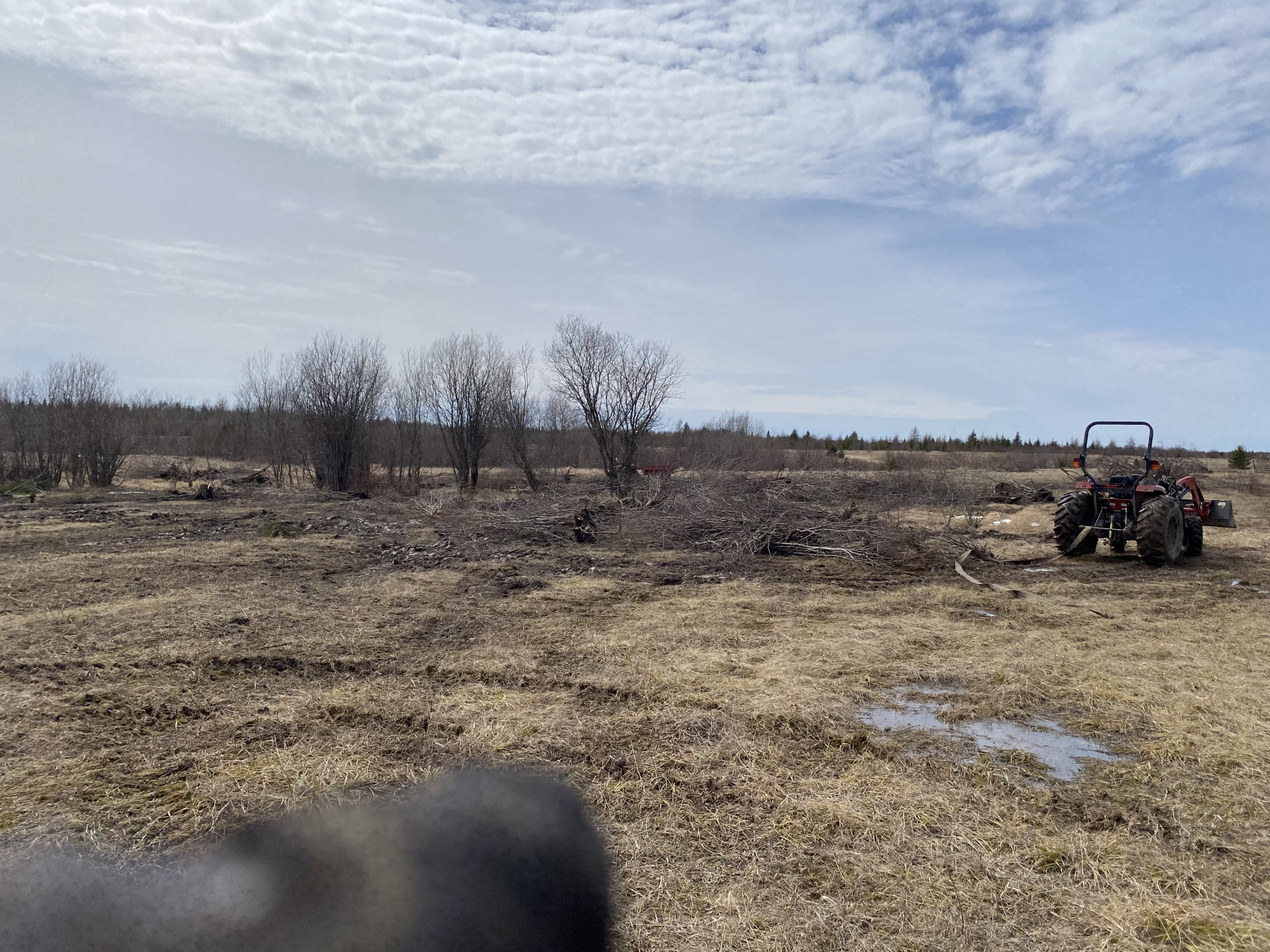

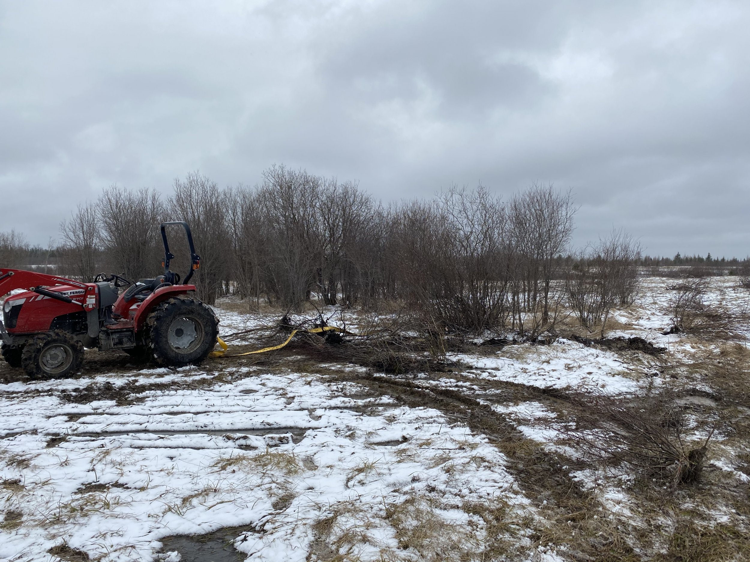

Ive been clearing overgrown land its mostly brush and ***** willow …. while ripping them lots of roots are staying behind, I am afraid these roots will cause me some issue while plowing. Should I be worried? I am considering buying a Subsoiler to remove these roots prior to start plowing but considering the $2000 price tag I am wondering if this is the best option ? should I consider a Skeleton grappler/ roots grappler or some other variation instead at $3000 … to be clear I will buy a Skeleton grappler eventually to be moving brush and other material but for now I have to choose only one …. the ground is clay and there isn't any rocks... I have a 60hp 4x4 subcompact tractor so the buckets is not the strongest, I am also skeptical putting it through this with a front loader attachment to remove roots and small stumps.

If you make your LOCATION a permanent part of your T-B-N PROFILE you will receive replies better tailored to your conditions.
right now I am working on a 21 acre field but most of it won't cause me problems its in the gully and a few low spots where there is bigger willow trees and since its softer ground not sure if I will be able to plow through but after that's I will have a other 20 acre to do and its pretty grown out with mostly brush and willows in low spots … see pictures below same patch, picture 2 have most rip out but that's what I am dealing with

It looks like 80 to 90% of what you have in your pictures could be easily removed with a root style grapple.
It's fairly easy to dig out clump brush and smaller trees up to 6 to 8 inches with that style grapple on my 60hp MX6000, which might be a similar sized tractor as yours.
Typically clump brush have spreading roots, rather than deep tap roots, so easier to pull out enmass.
Get the grapple down about 4 inches under the surface and just move forward in low gear against the clump to pop it out. If they are large clumps, you may need to start higher up to push them to loosen the roots...but they generally pop out once you get them loosened slightly.
For the smaller trees, you can use the weight of the tractor (your MF looks to be a solid, mid-sized utility tractor - maybe 4000# (+) if loaded) to push against the trees at about 6' up...
Once the tree is leaning, use the weight of the tractor to ride the tree down, leveraging out the roots. Occasionally you may need to dig/pry at the roots to finish getting a tree out, but they are generally loose at that point and not too difficult.
Only caveate is to be aware of the root mass when you are riding it down. I occasionally find Maples may have a fair sized mass that magically appears under your tractor...since the tractor underbelly can be exposed.
Use the weight of the tractor and tree to your advantage, rather than trying to just apply brute force prying at the roots with the grapple.
One last suggestion, it's significantly easier to use the full tree as leverage rather than cut down the tree, and then try to pry the stump/root out!
One of your photos looks like you are using a tow strap and maybe chain for pulling brush.
My experience is a grapple combined with the tractor weight to push and leverage against the target is ALOT faster than getting off and on the tractor using a chain to pull out brush and trees...at least on the 15 acres I've cleared.
I had one small area that I had to do that way...and even with my wife driving the tractor and me just dedicated to chaining...it wore me out quick!

thanks, for the tips and yes I have a 60Hp, the weight is about that as well and that's what I have been doing pulling on them with a tow strap and choker and yeah its not fun … can you share what type of grappler you have and what type you would advise me to buy? I am interested in the rock grappler since I would be able to use it for a lots of different application but I know it wont be as effective as a roots grappler or brush grappler.
